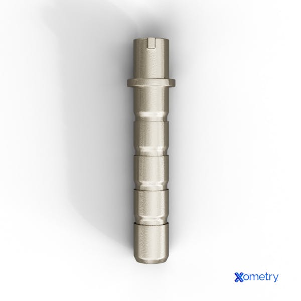

  • Metal Injection Molding: Metal injection molding combines powdered metal with binders, followed by molding and sintering. It creates small, high-strength components for aerospace, firearms, and medical tools.
A metal injection molded part

5. Metal Injection Molding
Metal Injection Molding (MIM) is a process used to manufacture high-precision, small metal parts by injecting a mixture of metal powder and binder into a mold, forming the part. The part undergoes debinding (a two-step process involving both thermal and solvent debinding) to remove the binder after molding, followed by sintering in a high-temperature furnace to fuse the metal particles, creating a dense and durable metal part.
MIM offers the advantage of producing complex and intricate metal components with high precision and minimal material waste. It is ideal for mass production of small parts (typically weighing less than 100g) that require fine details such as holes, knurling, and tight tolerances. The process is widely used in industries such as automotive, aerospace, medical devices, and electronics, where small, durable, and high-performance parts are essential.
The disadvantages of the metal injection molding include high initial equipment costs and limitations on part size (typically less than 100g), making it less suitable for larger components. The materials commonly used in MIM include stainless steel, titanium, tungsten carbide, cobalt-chrome alloys, and various nickel-based super alloys.
