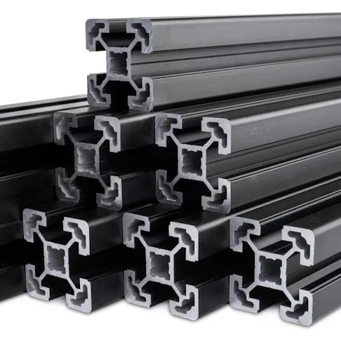

Black anodized extrusion bars. Image Credit: Shutterstock.com/stockphoto-graf

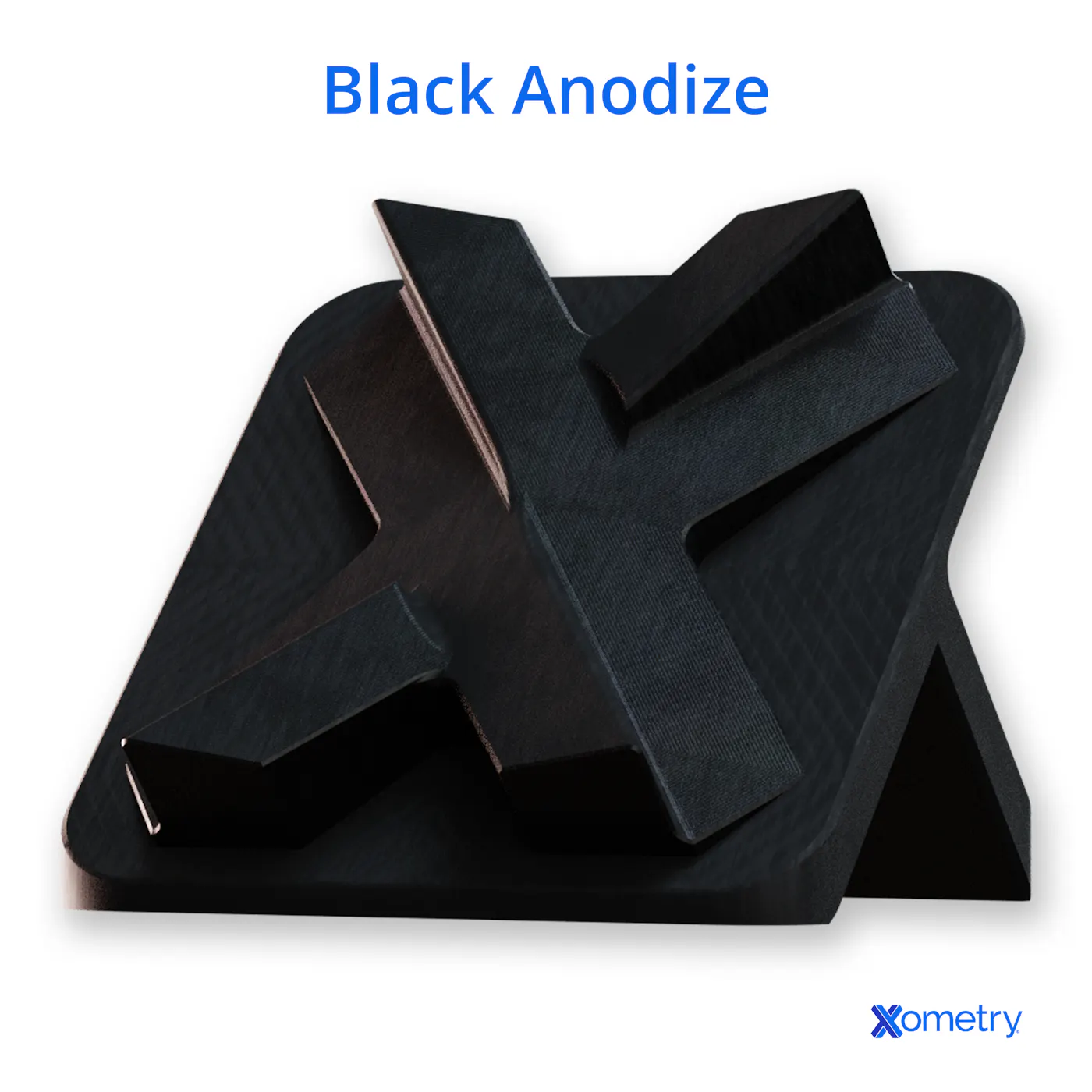

Xometry logo with black anodize finish
