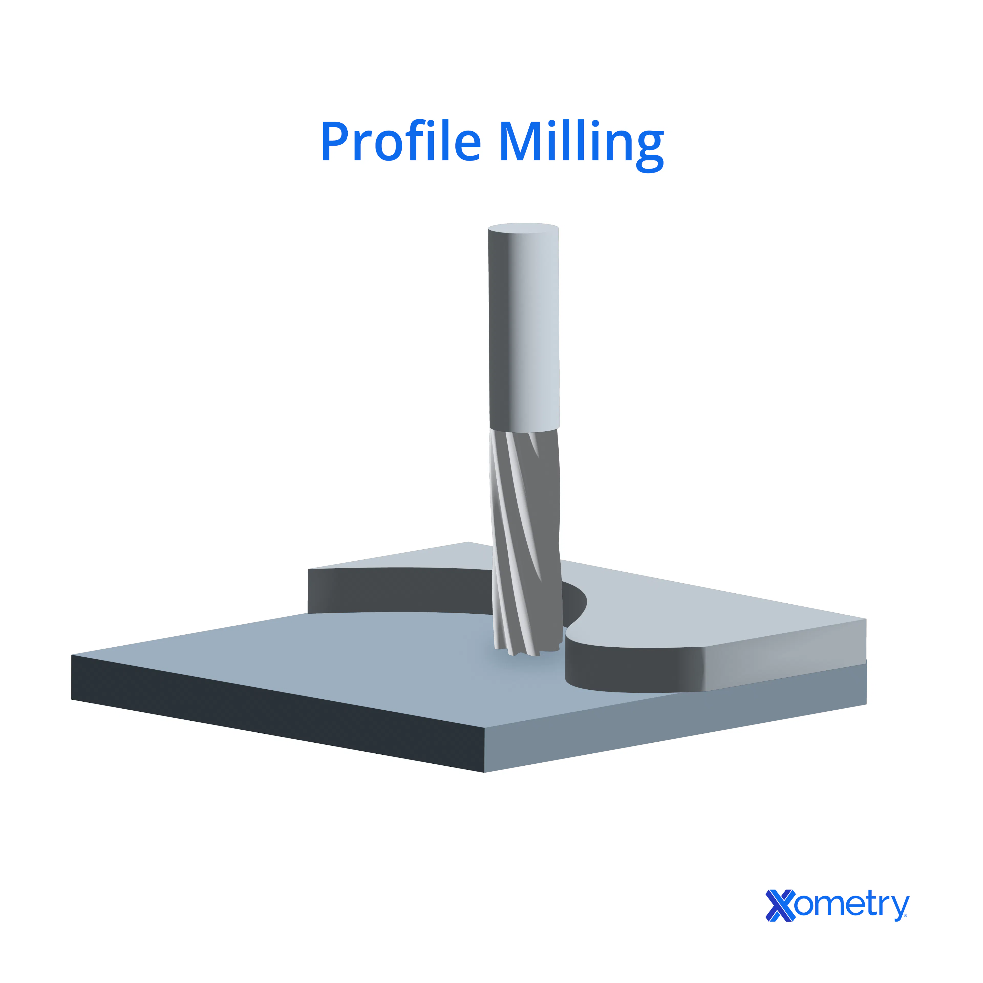

profile milling
An example of profile milling

The profile milling process utilizes a CNC profile milling machine to remove material and produce a finished part. The part is designed using computer-aided drawing (CAD) software. After this, a toolpath is generated using computer-aided manufacturing (CAM) software. The toolpath instructs the machine on how and where to position the cutting tool to produce the final design.
Once the workpiece is secured to the machine and the setup is complete, the milling process will begin. Material is removed from the workpiece using rotating cutting tools attached to the milling machine. These cutting tools move across the workpiece according to the toolpath, removing small layers of material each time. Multiple passes are made until the final shape is achieved.
Profile milling consists of multiple processes, such as roughing, semi-finishing, and finishing. Each method requires different cutting tools and machine settings. The workpiece will go through all these processes before the part is considered finalized.

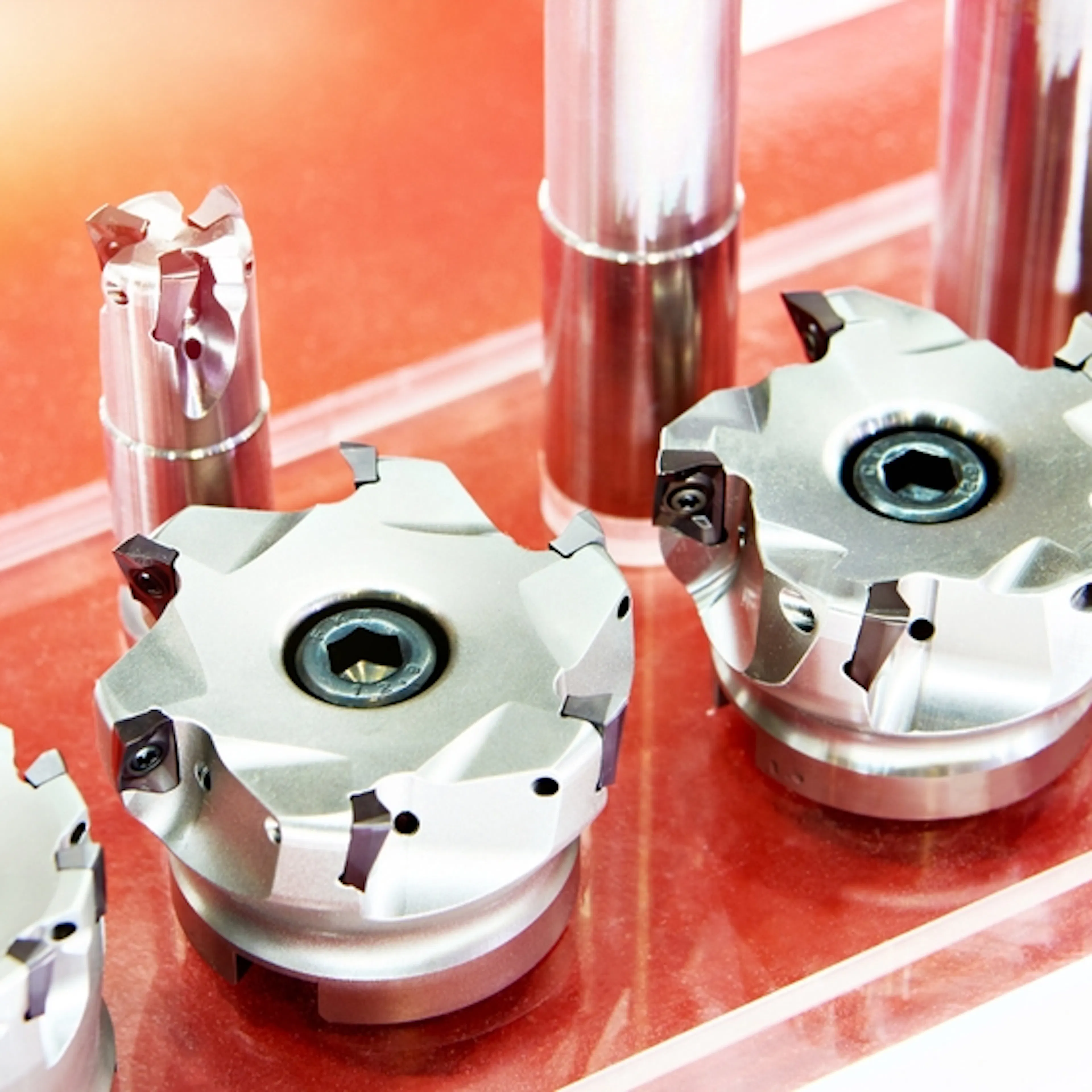

What Are the Different Tools Used for Profile Milling?
Many different types of cutting tools are used in profile milling, depending on the specific milling process. Several are listed below:
1. Ball Nose Exchangeable - Head End Mills
A ball nose exchangeable-head end mill consists of a modular tool body and a replaceable ball nose cutting head. The main feature of this cutting tool is the cutting head, which can be replaced if it becomes damaged or worn out. This makes it more cost-effective than most, as the entire cutting tool does not need to be replaced.
These tools are typically used for semi-finishing and finishing operations on contoured surfaces, offering precision and reduced downtime.
2. Ball Nose Solid Carbide End Mills
Solid carbide ball nose end mills feature a fully integrated design with a radiused cutting tip, ideal for creating smooth 3D contours and complex shapes. This makes them very effective for producing shapes and finishing contoured surfaces.
Ball nose cutting tools are used primarily for the semi-finishing and finishing processes, as they can precisely remove material to make curved or contoured surfaces with excellent surface finishes.
3. Round Inserts Cutters
Round insert milling cutters use a tool body fitted with circular, indexable inserts that can be rotated or replaced when worn. These inserts typically offer multiple usable edges. This design enhances productivity and reduces tooling costs in high-volume or heavy-duty applications, especially when machining cast or irregular surfaces. They are primarily used in the roughing process, particularly on complex surfaces or cast components.
4. Indexable Ball Nose Cutters
Indexable ball nose end mills combine the contouring capability of a ball nose tool with the cost benefits of indexable inserts. These tools feature replaceable cutting tips shaped for contoured machining, making them suitable for semi-finishing and finishing operations. Indexable ball nose cutters are primarily used in the semi-finishing and finishing stages, as they are designed for the precision removal of material on contoured or curved shapes.
