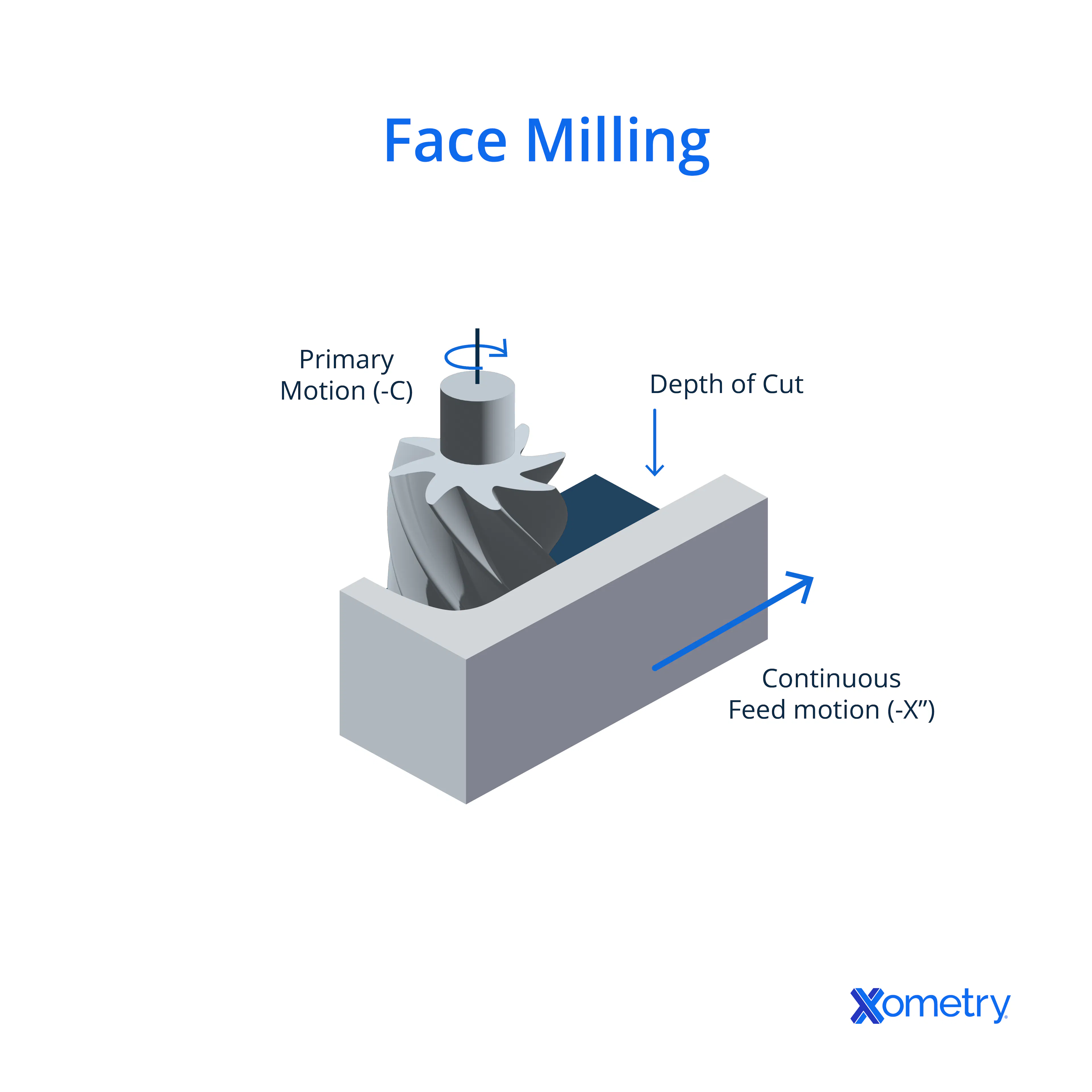

What Is Face Milling?
Face milling is a process used to cut material from the top face of a workpiece. Face milling is done using a milling machine or a machining center and typically uses tools such as shell mills, fly cutters, or specialized face mills. All of these tools achieve a similar result, which is to remove material from the top surface of a workpiece. Shell mills are one of the most common tools used to create parallel surfaces or achieve fine surface finishes.
face milling diagram
A diagram of face milling.

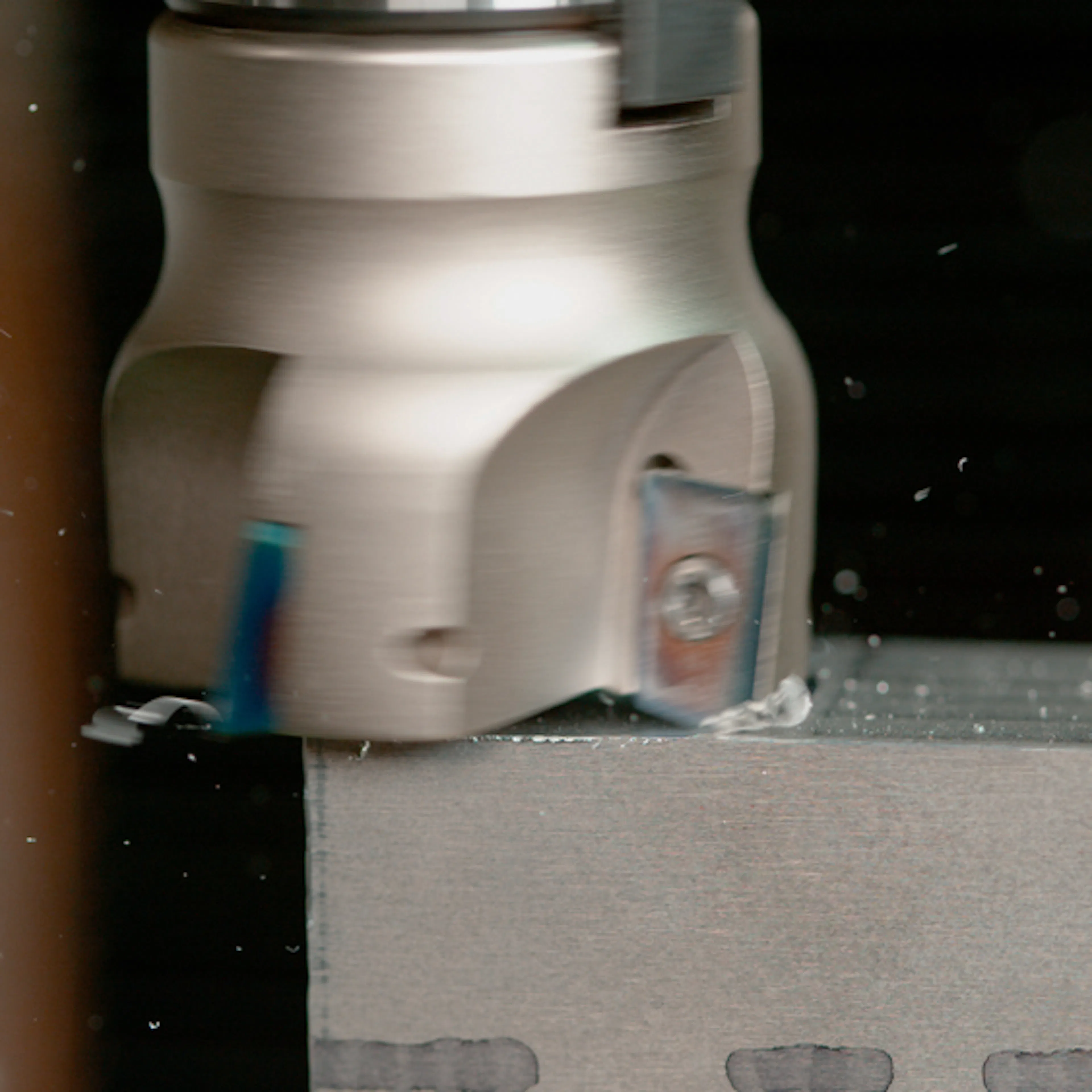

Shell mills are a popular choice for face milling. They are ideal for producing consistent surface finishes thanks to their multiple teeth with replaceable inserts. This design allows efficient material removal, especially on large, flat surfaces. While they can be used on hard materials, the effectiveness depends on factors like insert material, cutting speed, and machine rigidity.
3. Fly Cutters
Fly cutters are a type of tool used for face milling. They are a tool that has only one cutting edge and one insert. This tool is ideally suited for producing fine finishes without a high consumption of power. It is most commonly used for softer materials.
