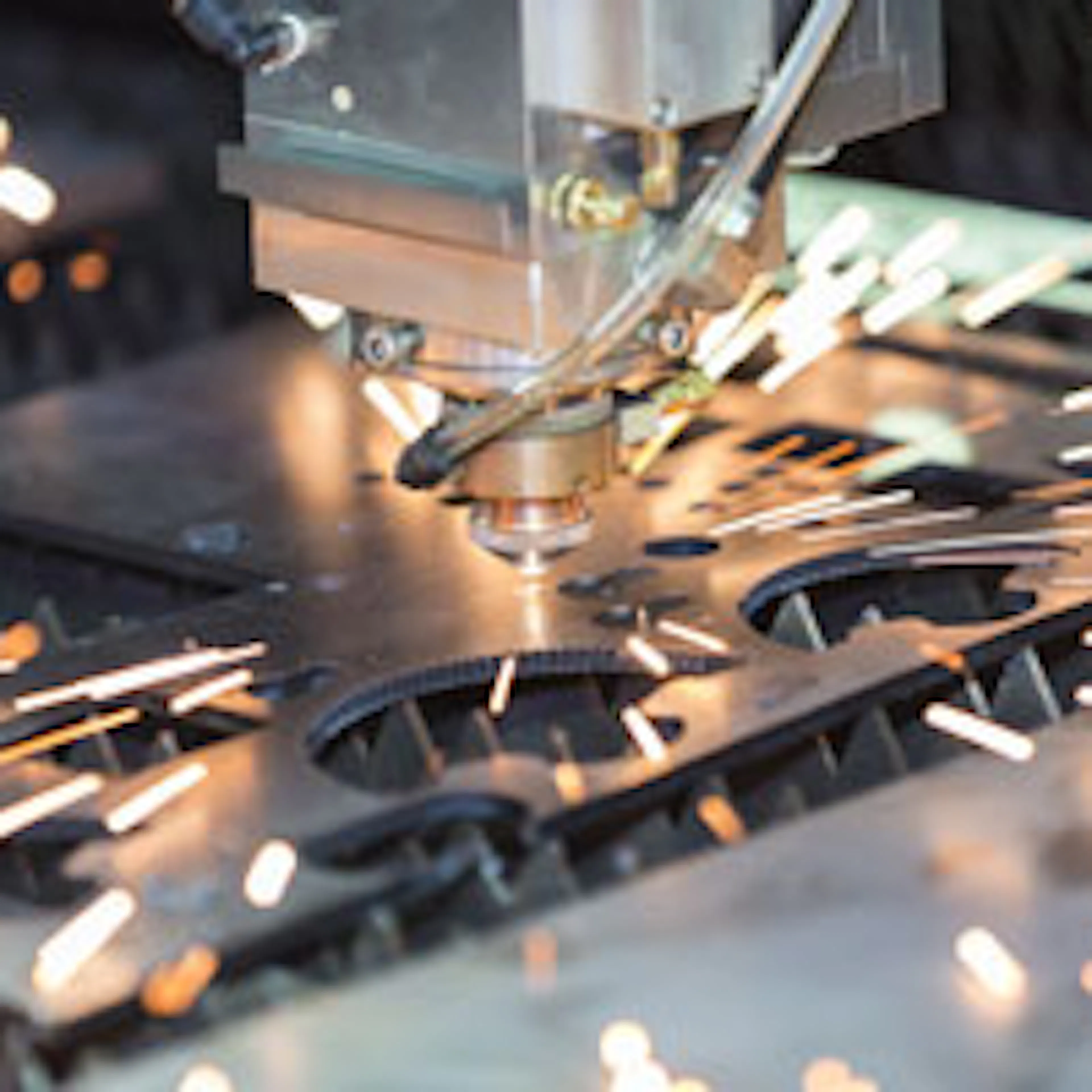

CNC Laser Cutter
Laser cutters are the most commonly used machines for sheet metal as they can cut most materials, at a variety of thicknesses, depending on the laser power. Laser cutting machines are best for cutting thin materials of less than ¼ inch (6.35 mm) and produce the best quality cut at the highest speed for thin materials, making them ideal for sheet metal fabrication. Laser cutters are, however, more expensive than plasma cutters but cheaper than waterjet cutters.
CNC Plasma Cutter
A plasma cutter works by generating a beam of high-temperature plasma that cuts through the metal. An electric circuit is created through the plasma beam that then passes through the workpiece which is also attached to the circuit. This means that plasma cutters can only cut conductive materials. In general the higher the conductivity the better. Lower conductivity materials do not cut as easily as higher conductivity materials like copper. These machines are usually cheaper than laser cutters. They are best suited to medium-thickness materials that can range from 15 to 50 mm. Thinner materials tend to heat up too much causing excessive warping.
CNC Waterjet
A waterjet cutter works by blasting abrasive-laden water at extremely high pressures to cut through materials up to 10 inches (254 mm) thick. Unlike a plasma cutter, the waterjet is not limited to conductive materials. It has the unique advantage over all other cutting methods of adding no heat into the material. The waterjet’s major disadvantage is that it is expensive to operate. A second disadvantage is that when it comes to fine detail on thin materials, laser cutting machines come out ahead. One unique benefit of waterjet machines is that they can cut stacks of plates, thus dramatically increasing their productivity. Waterjet cutters are not as environmentally friendly as the other cutters mentioned as they require significant amounts of water and spray a mix of water and abrasives all over the place which is difficult to clean and recycle.
