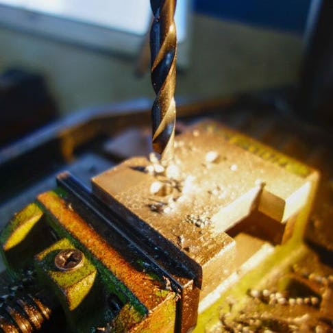

Counterbore hole drilling in a metal workshop. Image Credit: Shutterstock.com/arfa adam

Both spotface and counterbore holes are created through mechanical milling or drilling processes. Counterbore and spotface holes have similar shapes so they can be created in a similar manner. First, a pilot hole is drilled into the part. This is just a basic cylindrical hole in the component. Most counterbore holes go right through the part, in which case drawings won’t specify a depth. If the hole does not go all the way through, the depth of the pilot hole will be indicated in the drawing.
After the pilot hole has been drilled, the counterbore hole can be created. This is a larger hole that goes on top of the pilot hole. These holes are coaxial. Usually, it should be large enough to conceal the head of the fastener. Spotface holes, on the other hand, are also cylindrical and may have the same diameter as counterbore holes, but differ in depth. The hole is not intended to ‘hide’ the head of the fastener, but rather to create a level surface on which it can seat. This is especially important for uneven surfaces.
The instrument used to drill the holes will determine the form of the hole's bottom. The angle at the bottom will be the same as that of the drill tip. If the part needs a flat-bottomed hole, use a ‘boring’ technique or a tool with a zero tip angle.
