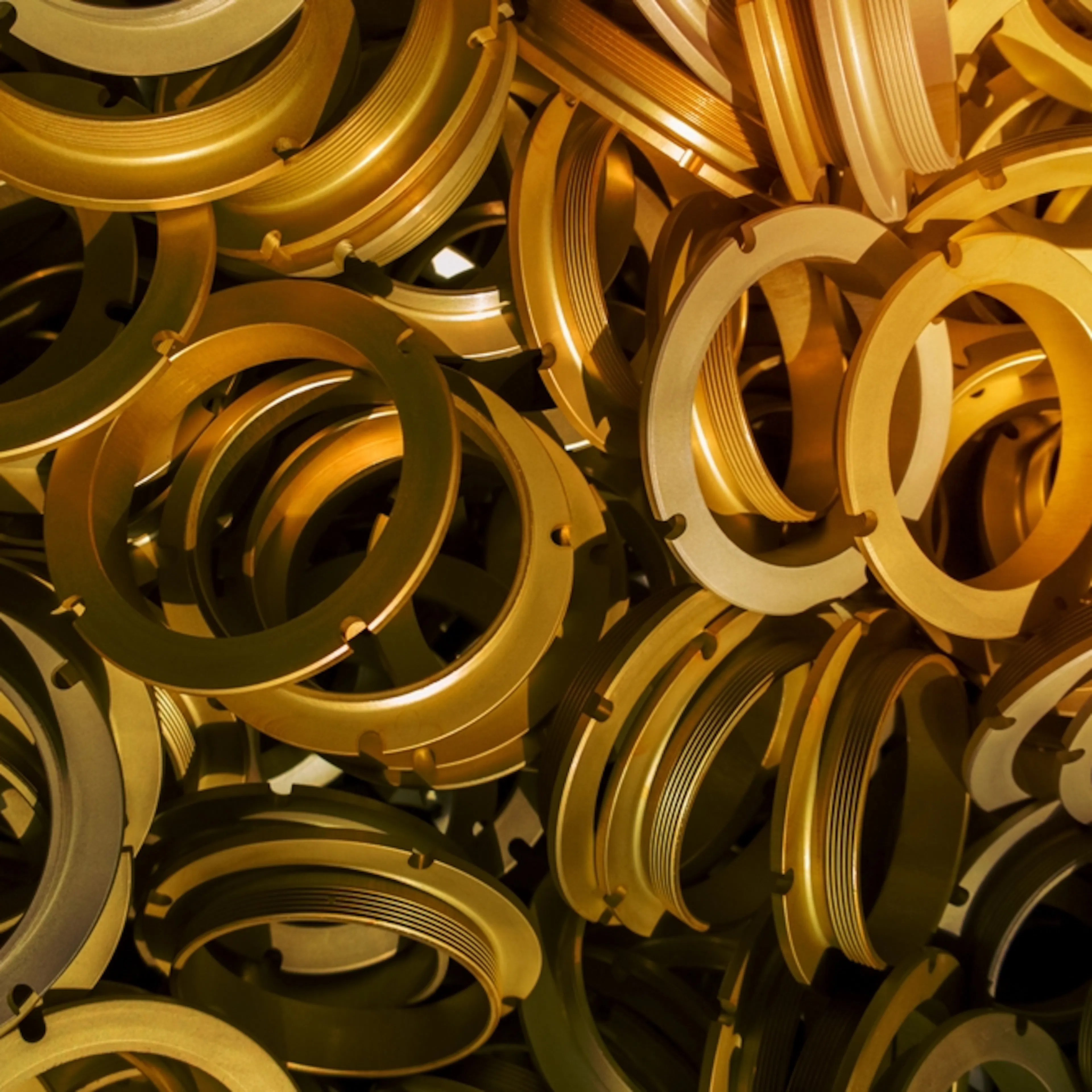

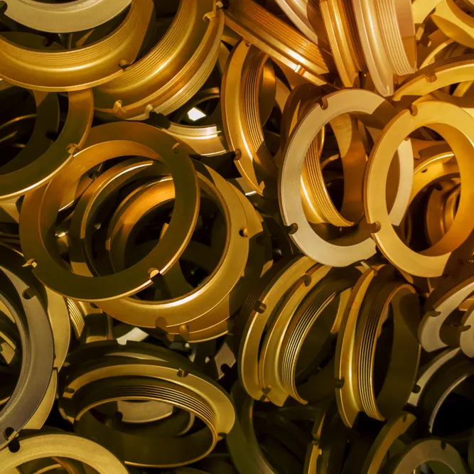

Sulfur oxidated anodized parts. Image Credit: Shutterstock.com/feliciacinca

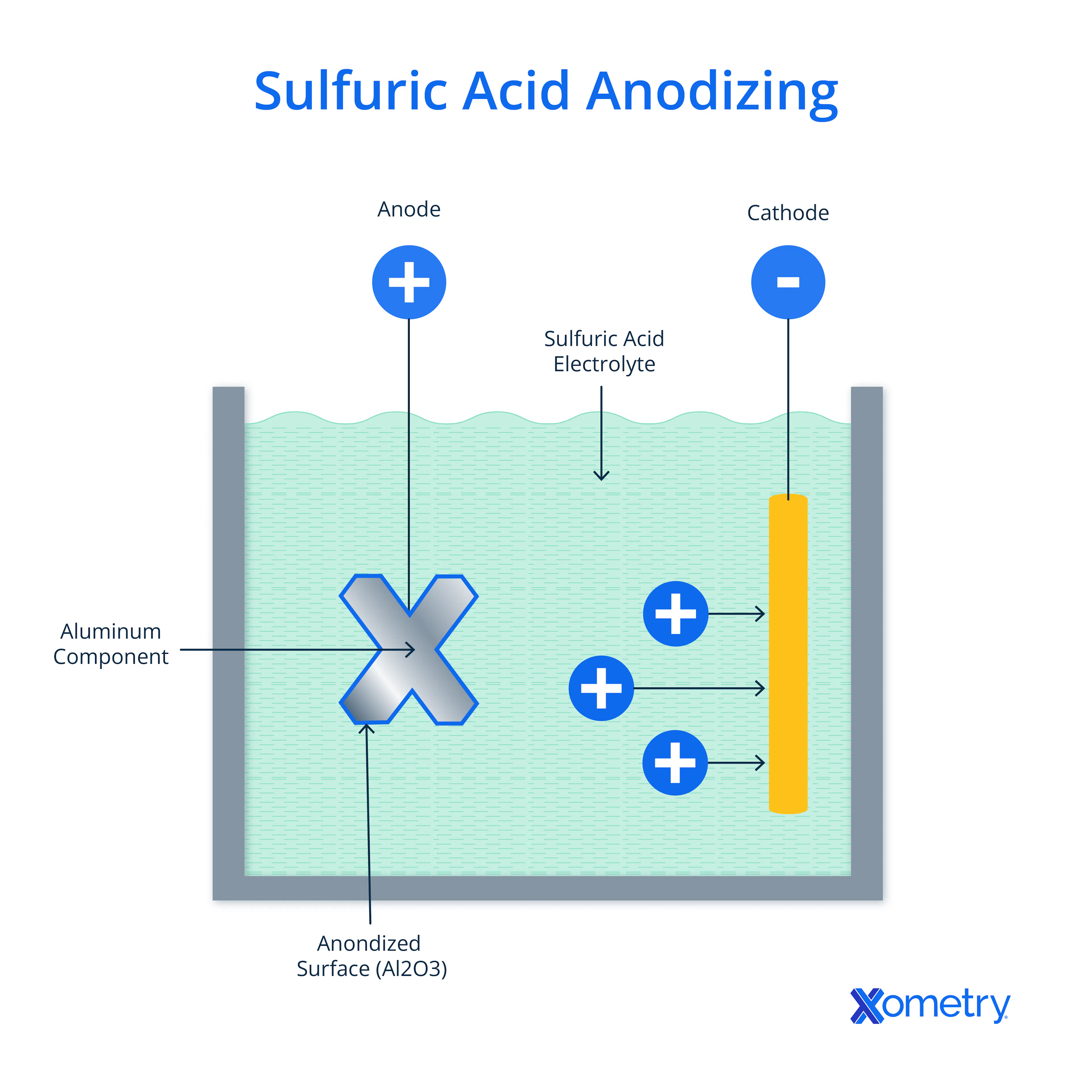

Sulfuric acid anodizing refers to a process whereby an aluminum alloy part is exposed to an electric current inside a sulfuric acid electrolyte bath. This process produces an abrasion and corrosion-resistant coating of aluminum oxide (Al₂O₃) on the part’s surface. Sulfuric acid anodizing is often performed in accordance with US military specification MIL-A-8625 and is referred to as either a Type II or Type IIB coating. A standard Type II coating is typically dyed after anodizing and has a thickness of 0.00007 to 0.0010 inches (1.78 to 25.4 µm). Sulfuric acid anodizing that results in a thinner coating (0.00002 to 0.0007 inches (0.51 to 17.78 um)) is referred to as Type IIB anodizing. Because it results in a coating thickness comparable to that of chromic acid (Type I) anodizing, the Type IIB process is often used as a non-chromate alternative to Type I anodized coatings.

After the cleaning steps, the parts are placed in an electrolytic solution of sulfuric acid. The part is connected to the positive terminal, making it the anode. A cathode made from an unreactive material is situated in the bath and is hooked to the negative terminal. The application of direct current causes the aluminum to release electrons from the aluminum, creating positively charged aluminum ions on the surface of the part.  At the same time, negatively charged oxygen ions produced at the cathode bond to the aluminum ions to create aluminum oxide (Al₂O₃). The characteristics of the oxide layer are controlled by the conditions in the electrolyte bath such as the temperature, surface current density, time, and sulfuric acid concentration.
