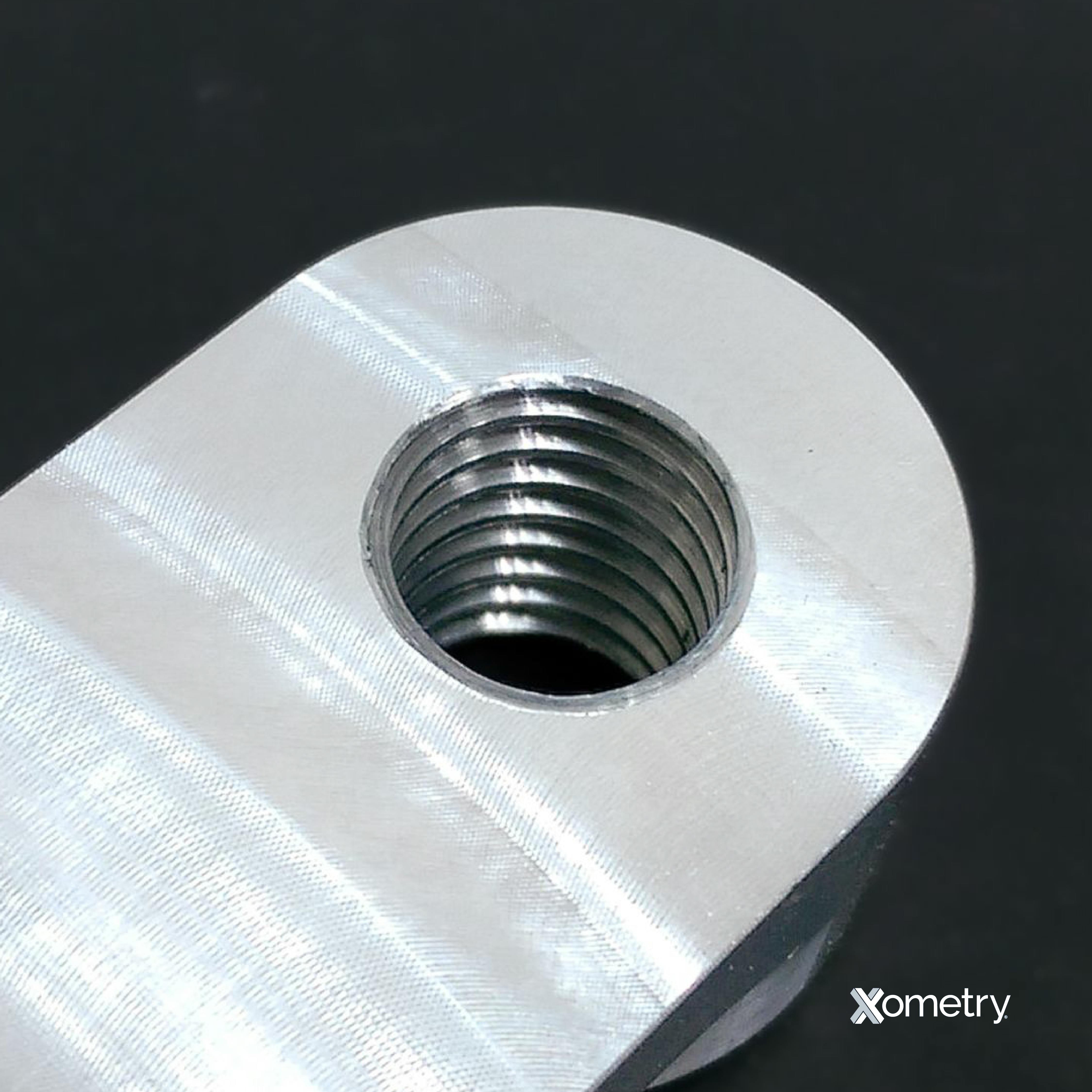

Thread milling on a Xometry part
How Does Thread Milling Work?
Thread milling works by using a cutting tool with a toothed profile that rotates relatively quickly. The spindle holding the tool moves in a circular path in the horizontal x-y plane, with a constant, low speed of vertical z movement. In this way, each rotating tooth of the cutting tool cuts a thread that progresses in the z direction through the hole. The thread can be completed in a single pass, or commonly in two (vertical) passes.
