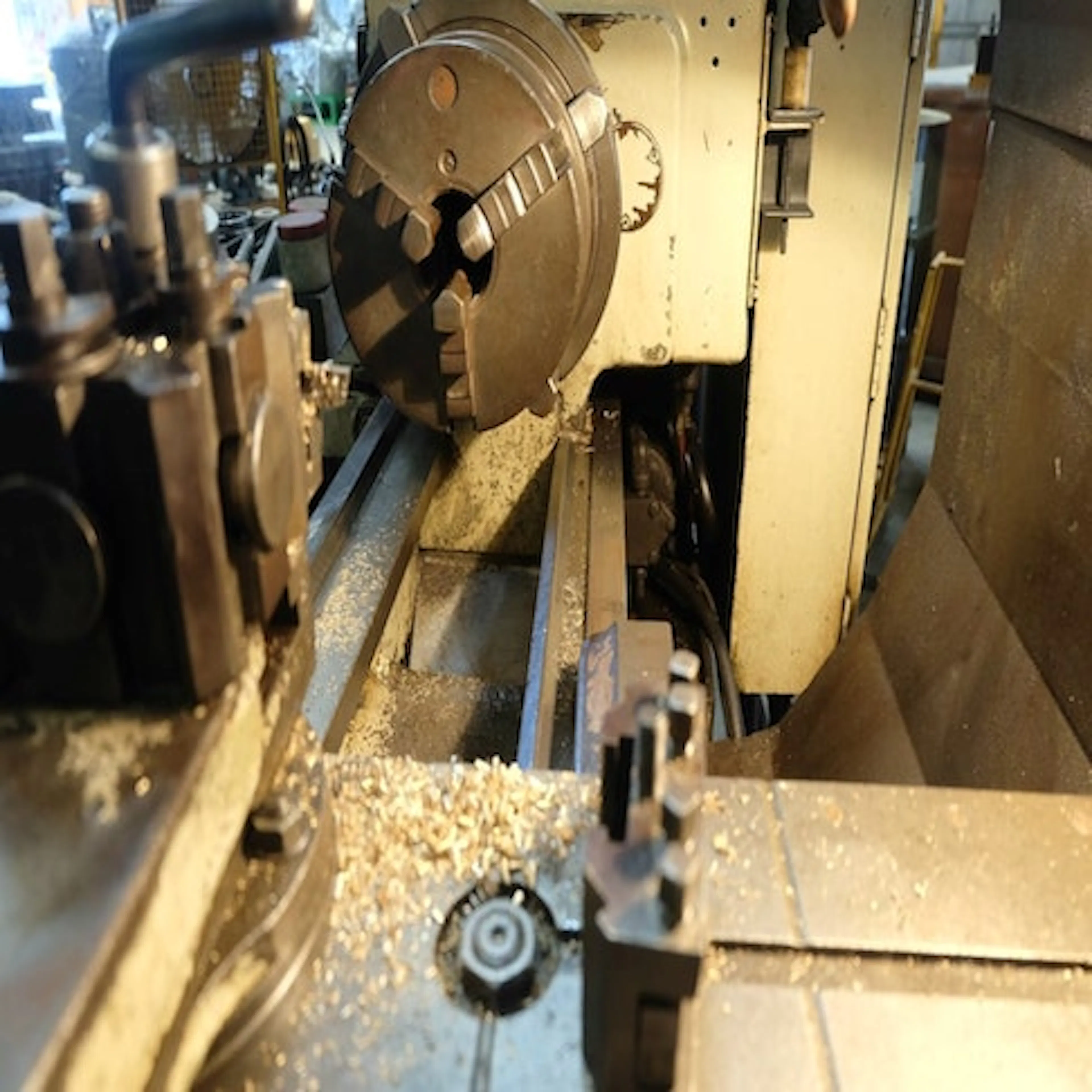

There are several types of turning operations used to create sophisticated custom parts. They can manufacture durable products such as musical instruments, table legs, gun barrels, screws, and cue sticks. However, each step of these manufacturing processes follows different procedures to meet design specifications. One machine that is capable of performing many different operations is the lathe machine.
A lathe is an all-in-one manufacturing device with the capability of performing different turning operations. Turning operations remove unneeded material from a workpiece as it rotates along an axis. There are different types of turning operations, including threading, boring, facing, turning, drilling, and tapping. The time taken to perform a turning or machining operation is given by the formula below:

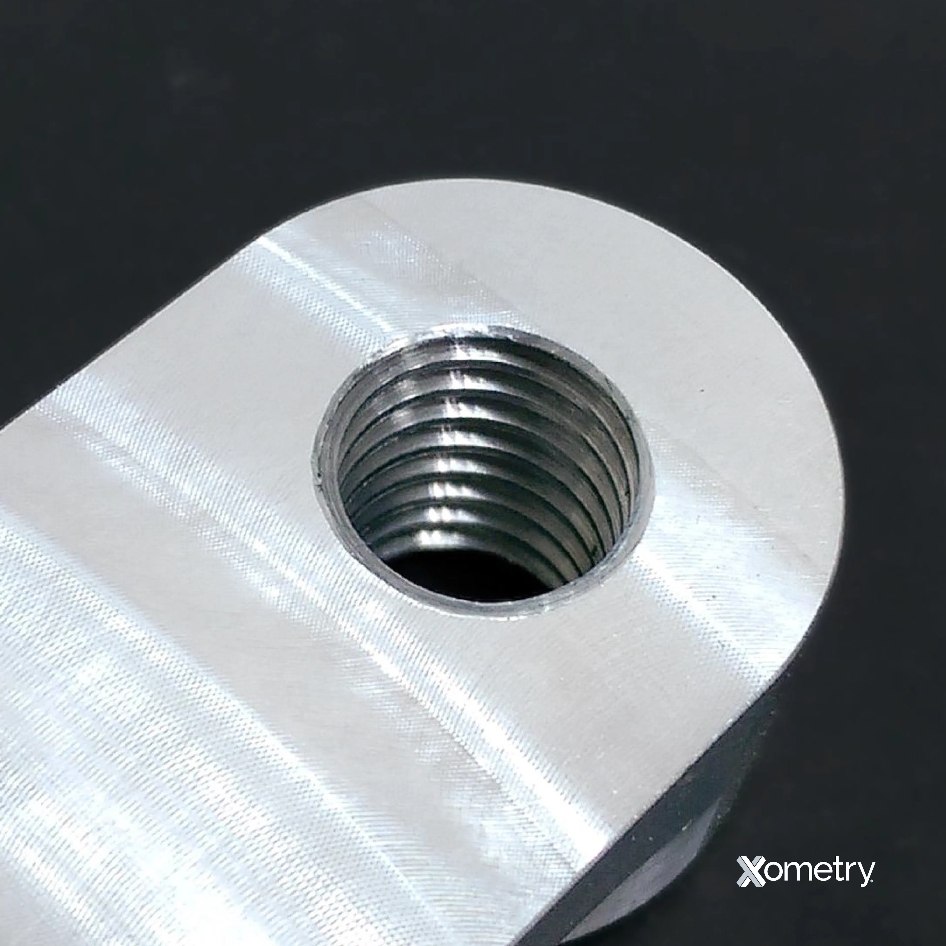

1. Threading
Threading is a lathe machining or turning operation that incorporates a mechanical tool that cuts threads on the outer surface of a workpiece. The tool does this motion by moving along the side of the workpiece. Threads—the result of the operation—are helical grooves with pitches and lengths that have been specified. To get deeper threads, the tool needs to pass multiple times along the side of the workpiece. The tool used to perform this action is a thread-shaped cutting tool bit. To get the job done accordingly, the machine must be properly set. In the event that multiple passes of the tool are needed to cut deeper threads, the machine must be set so that the helix begins at the same location.
part with threaded hole

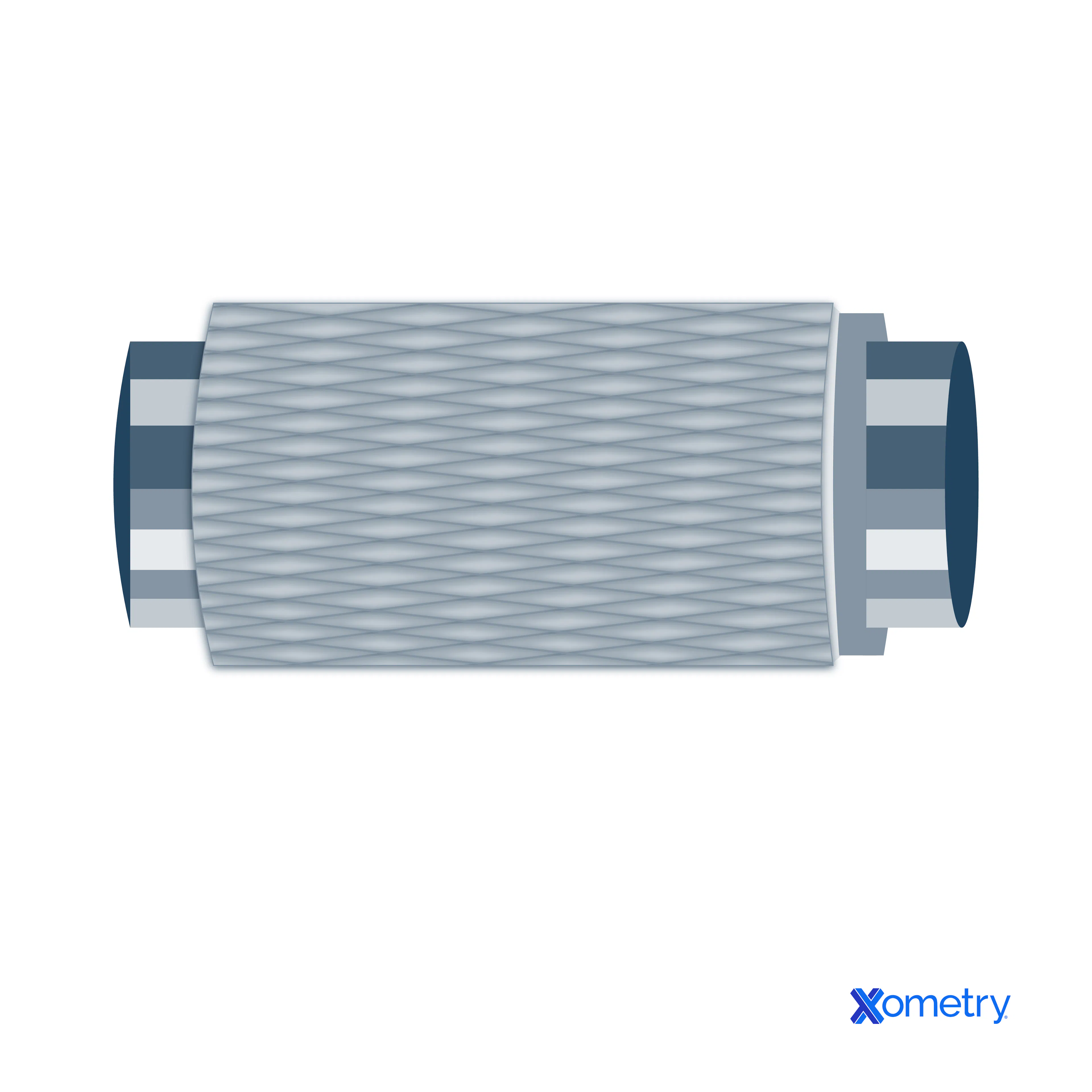

4. Knurling
The purpose of knurling is to create serrated or diamond-shaped patterns on the surface of a workpiece or part. Knurling helps to facilitate the easy gripping of the machined part and also makes it aesthetically pleasing. The tool used to perform this operation is called a knurl. To achieve these patterns, the knurl (or knurls) are brought into contact with the workpiece surface and the (tool) teeth are made to roll against it.
A knurled handle
A knurled handle

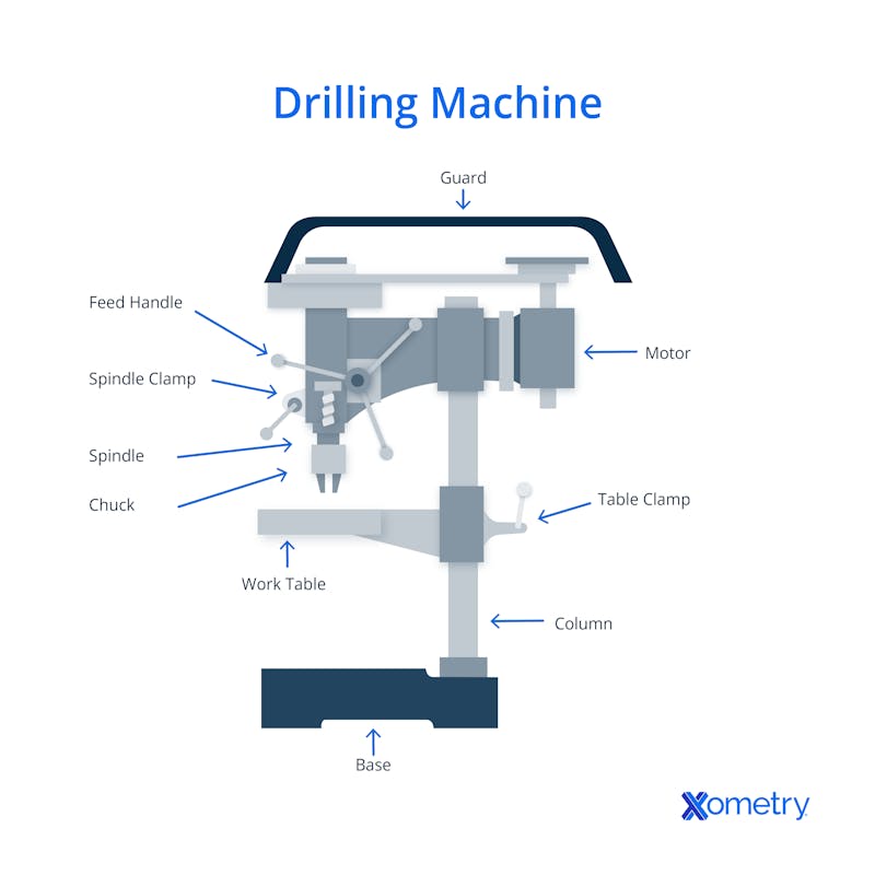

5. Drilling
The purpose of drilling as a machining operation is to create a hole in a workpiece by removing unneeded materials from it as it rotates. The diameter of the hole will be equal to the size of the drill bit which is used to perform the operation. For a drill bit to be well optimized, it should be properly positioned. Proper positioning is done with a lathe tool holder or tailstock drill holder as the workpiece rotates in a faceplate or chuck.

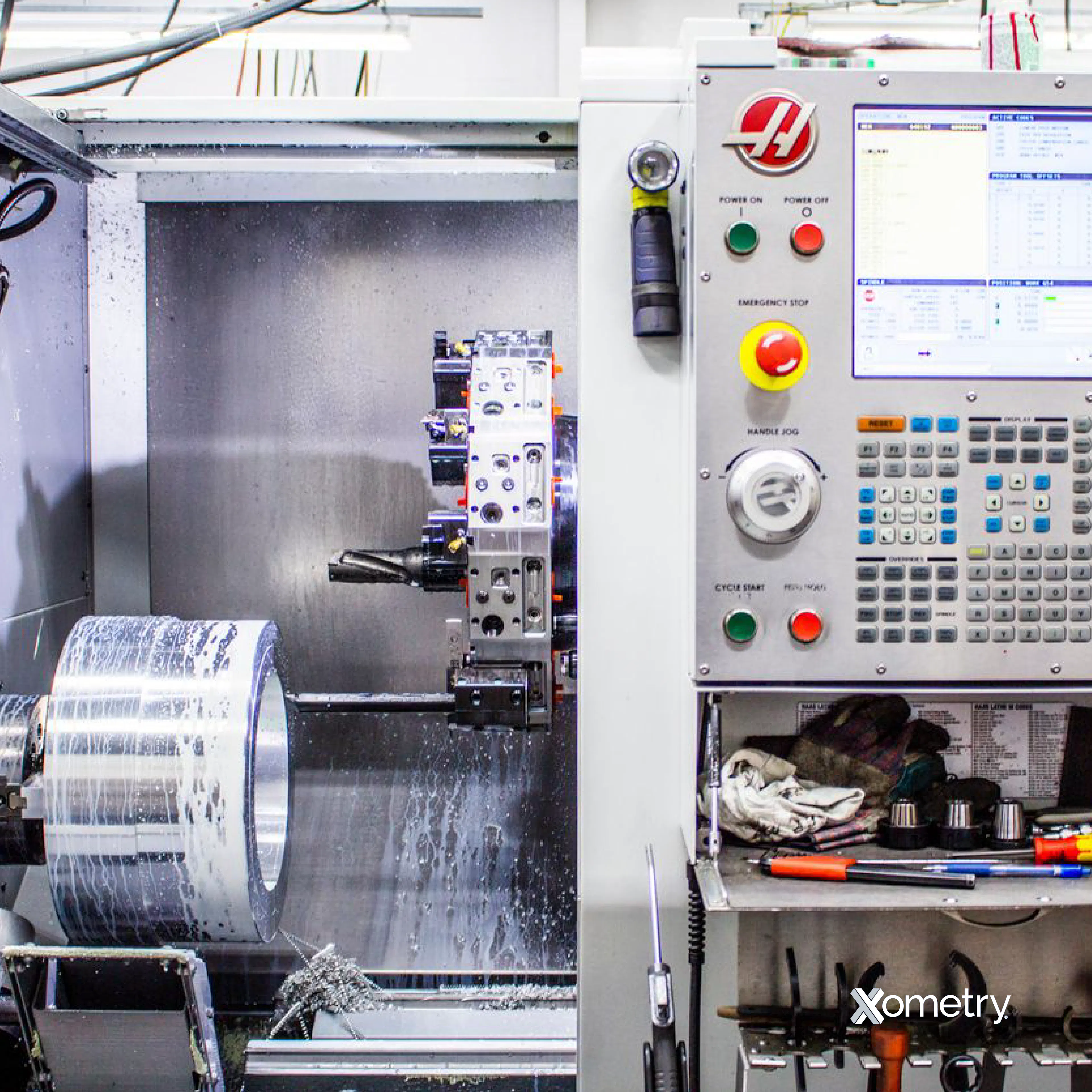

What Is a Turning Operation in CNC?
A turning operation in CNC (Computer Numerical Control) involves a process whereby (typically) bars of materials are held in a chuck and rotated. Excess materials are removed using a cutting tool until the final and desired shape is created. It is a subtractive manufacturing process since the desired item is created by the controlled continuous removal of material from the workpiece. CNC turning operations take place at a relatively fast speed. This speed makes the process relevant in the production of high volumes of parts. For more information, see our guide on CNC machining.
CNC machine
CNC machine
How Does a Turning Operation Work?
In the turning operation, the workpiece is held securely in place on a fixture which is rotated at a high speed while connected to the turning machine. Then, a cutting tool removes or cuts away unneeded material in order to create the desired shape.
