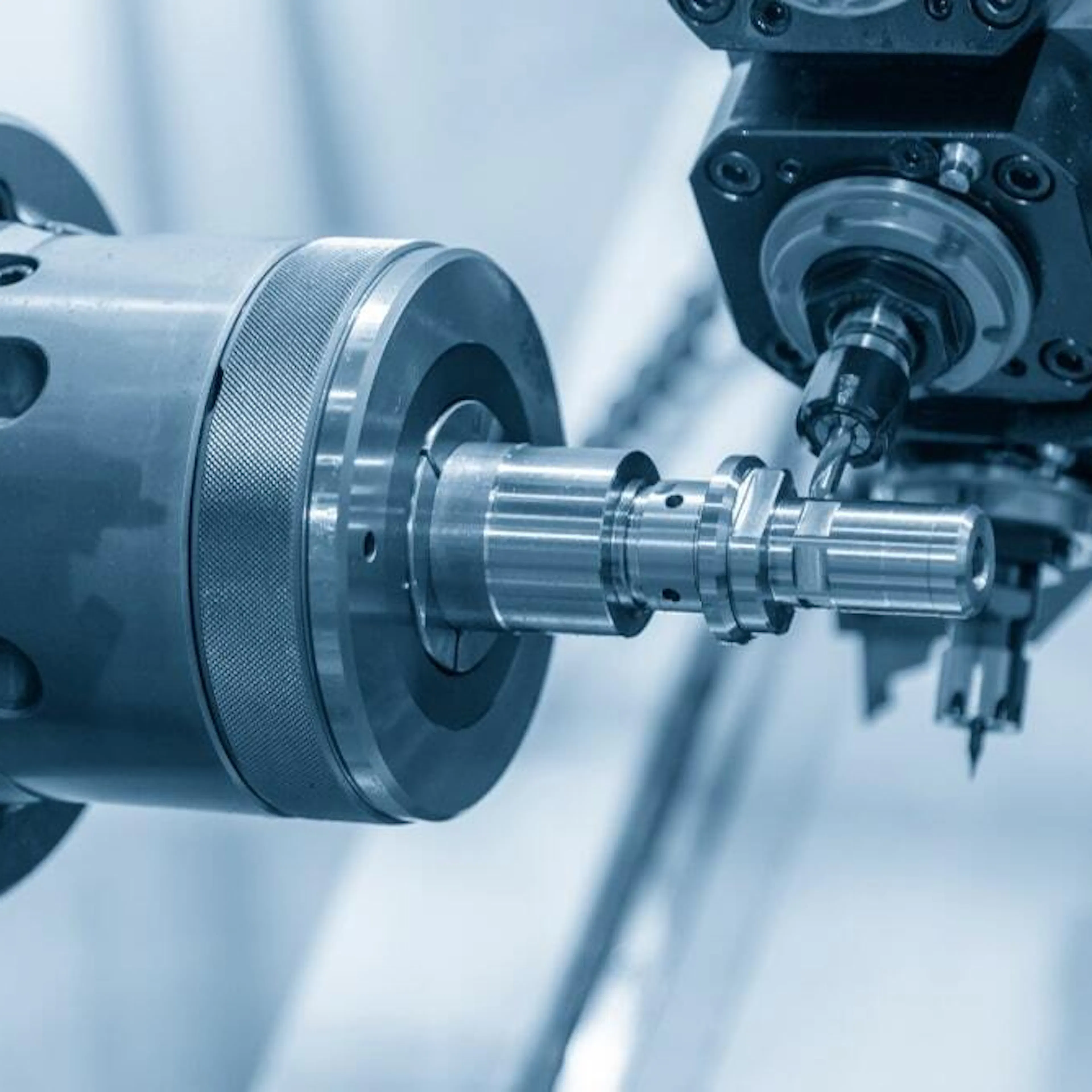

Turning in machining by CNC lathe machine. Image Credit: Shutterstock.com/Pixel B
What is turning? Turning is a machining process where a lathe is used to rotate the metal while a cutting tool moves in a linear motion to remove metal along the diameter, creating a cylindrical shape. The cutting tool can be angled differently to create different forms. It can be done manually or with a CNC turning machine. CNC machining is generally used when part measurements must be very exact.

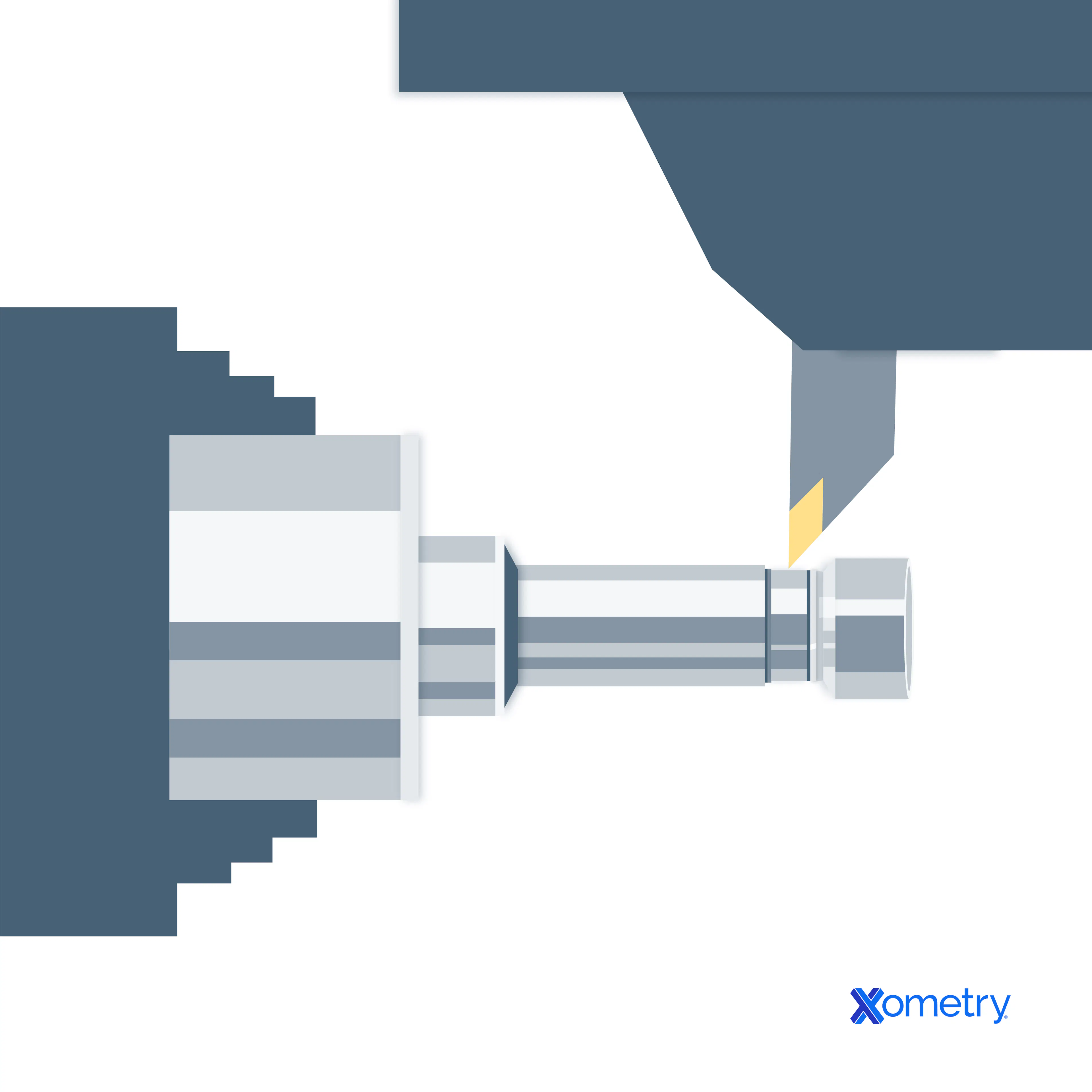

The turning process works with a lathe machine moving the cutting tool in a linear motion along the surface of the rotating workpiece, removing material around the circumference until the desired diameter is achieved, to machine cylindrical parts with external and internal features, such as slots, tapers, and threads.
Turning uses single-point cutting tools to remove material from the rotating workpiece. The design of the turning tool depends on its application, with tools available for roughing, finishing, facing, threading, parting, forming, undercutting, and grooving applications.
