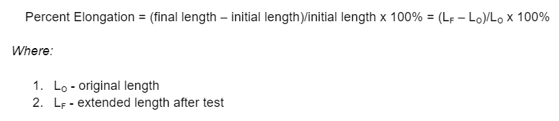

How Is Ductility Measured Using the Elongation Test?
Ductility can be expressed as percentage extension at fracture using the equation below:

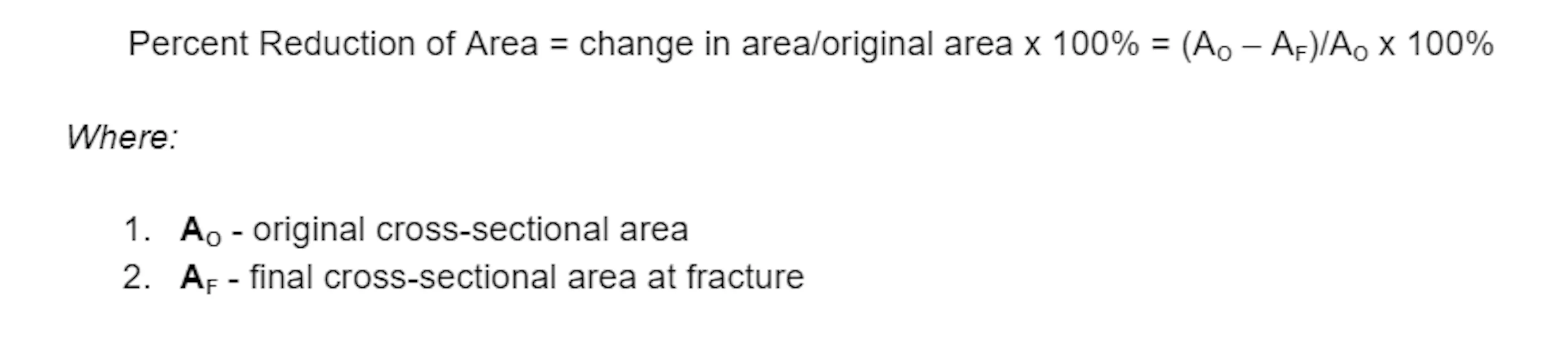

How Is Ductility Calculated Using the Tensile Test?
Ductility is expressed as a percentage reduction in cross-sectional area at the fracture. For more information, see our guide on Tensile Strength.
It is calculated by the following equation:
