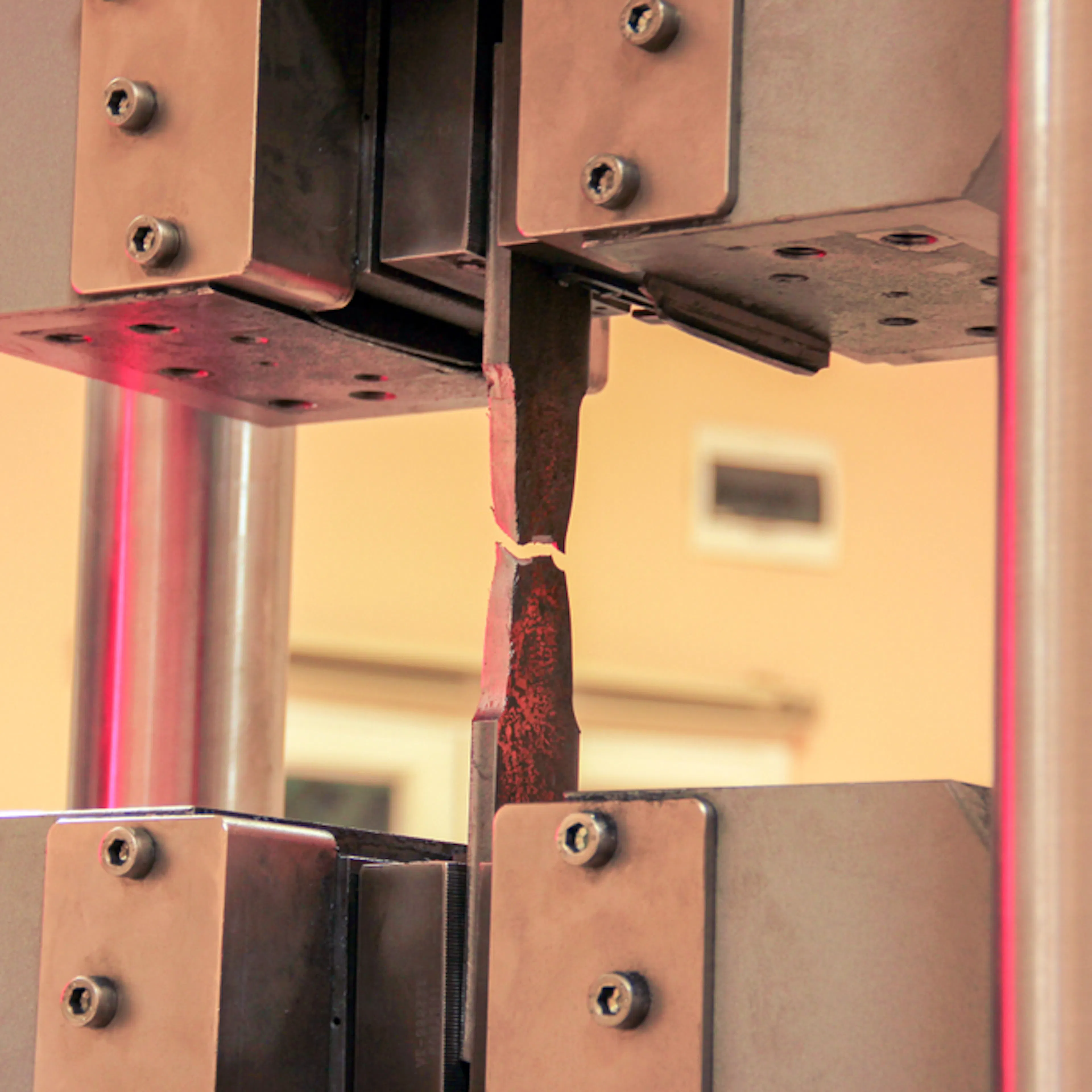

Tensile testing. Image Credit: Shutterstock.com/Funtay

1. Tensile Strength
A tensile test is designed to assess the modulus of a material in tension, which is when a material is pulled apart from either end. Tensile tests can be used to determine the tensile strength, yield strength, strain hardening, and ductility of a material. Tensile strength indicates the maximum stress a material can withstand before failure or deformation. The tensile test can also determine the ultimate tensile strength when a material fails, and so determines the limits of a material.
Tensile strength testing is one of the most widely used tests and can be used in any industry to test any solid material. In tensile testing, the material, usually in the approximate shape of a dog bone, is gripped from either end and pulled apart at a constant rate. An extensometer in series with the test load determines the elongation of the material and plots it against the applied stress to create a stress/strain curve graph. The standard for tensile testing will depend on the material being used. ASTM E8 and ISO 6892-1 are standards used for metals, whereas ASTM D638 and ISO 527-1 are standards for plastics.
For more information, see our full guide on What is Tensile Strength?

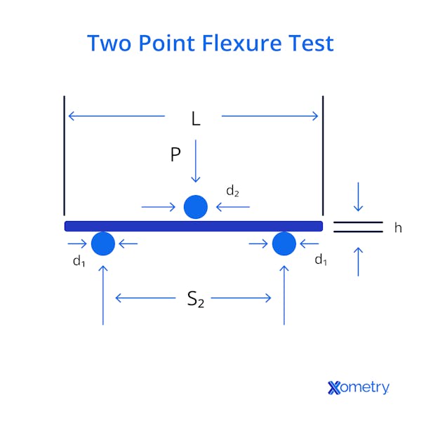

3. Flexure/Bend Strength
A flexure test, also known as a bend test or three-point bend test, is used to determine the tensile and compressive strength properties of a material at the same time. Flexure testing is important for testing brittle materials as measuring the tensile strength of brittle materials can be difficult due to the failure behavior. Flexure testing is crucial to testing surface material properties and can determine the stiffness, flexure stress and strain, and strength of a material.
A flexure test can be performed with a two-, three-, or four-point flexure test. In a two-point test, the specimen is gripped at one end, and then a load is applied to the other end of the material. In a three-point test, the specimen is gripped at both ends, and the load is applied in the middle. A four-point test also grips the specimen at both ends but applies the load at two points between the ends; the force is applied in an even and balanced way. There are many standards for flexure testing; however, some well-used ones are ASTM C67-08 for testing brick, ASTM E855 for metallic spring materials, BS EN 2746:1998 for glass-reinforced plastics, and BS EN ISO 7438:2005 for metallic materials.
