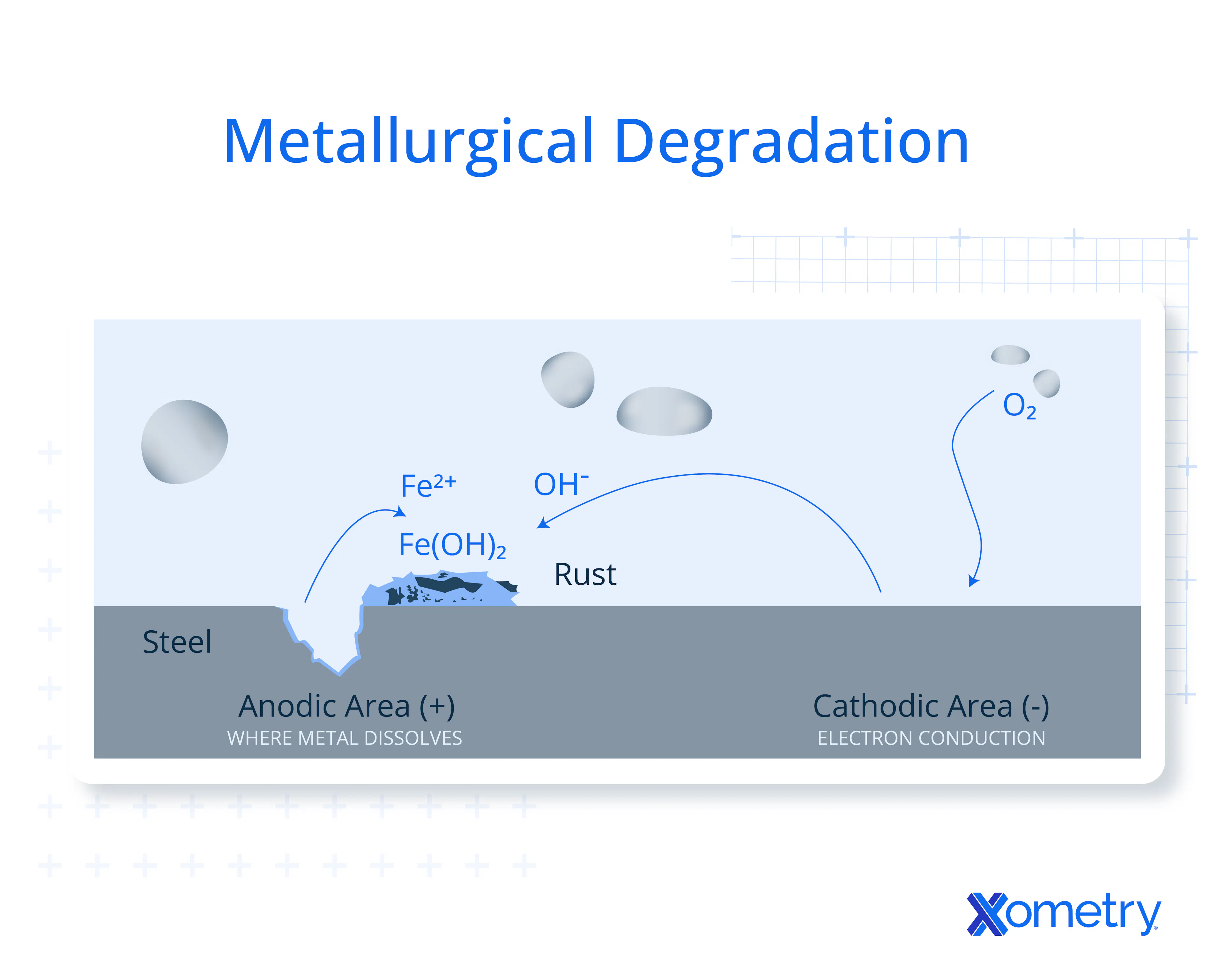

During corrosion, the metal will react with its environment through an electrochemical process. The metal will give up electrons to its environment which positively charges the metal during this process. This occurs because these metals are not found in their metallic state naturally, but rather they occur naturally as a compound. After metals are processed, they slowly return to their original compound state as this form takes the least amount of energy to maintain. Corrosion will occur in many different situations using different mechanisms. Figure 1 below is a diagram of metallurgical degradation.
An illustration showing metallurgical degradation.
