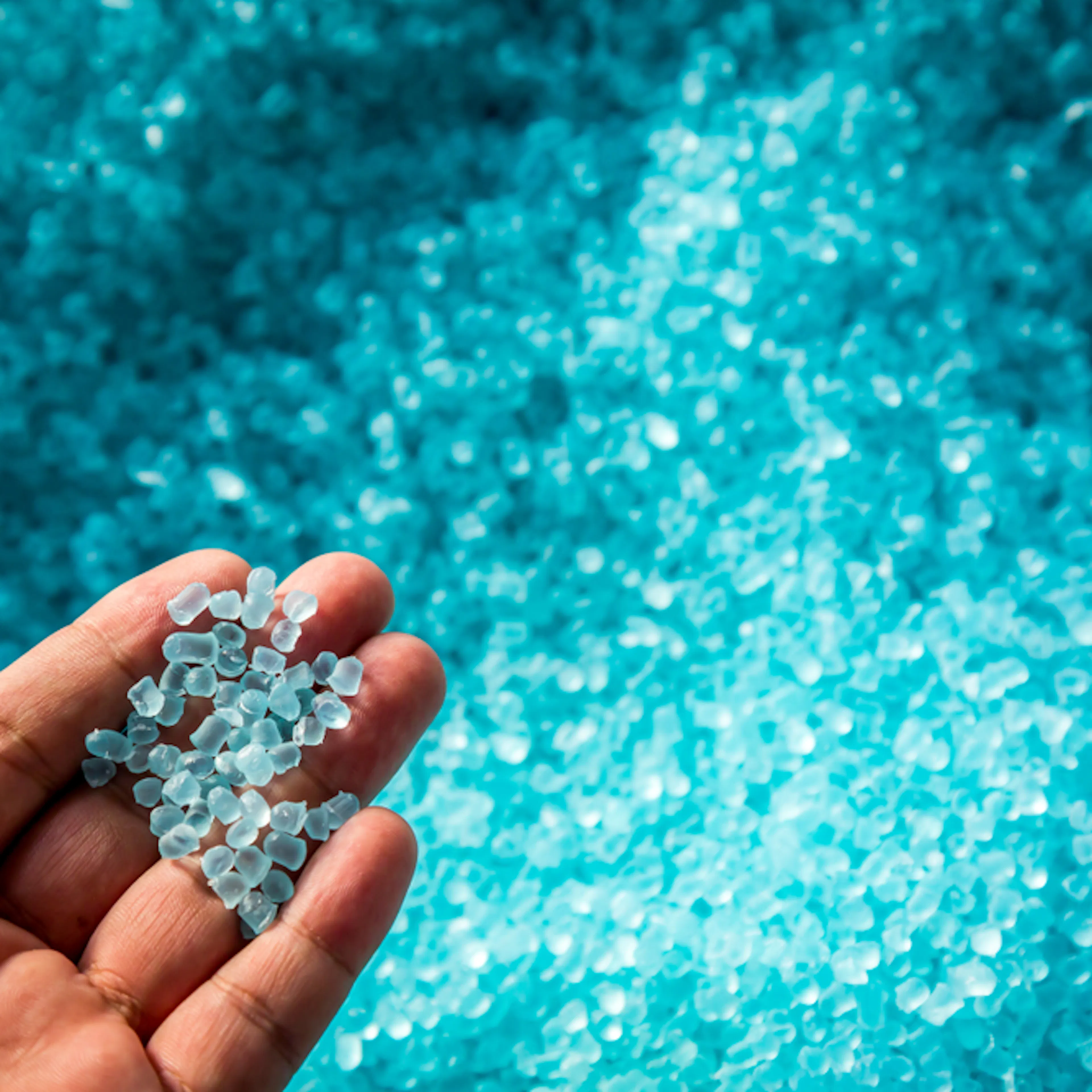

Blue plastic polymer granules. Image Credit: Shutterstock.com/Extarz

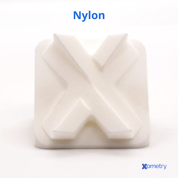

Nylon is the family name for a group of synthetic thermoplastics belonging to the polyamide class. It is usually manufactured by the reaction of diamines and a dicarboxylic acid. The process results in making molecules with carboxylic groups with an amine group at both ends. Nylon can also be manufactured from the lactam of an amino acid that undergoes self-condensation. These possess a ring of ―CONH― groups, an example being ε-caprolactam.
The earliest use of the material was as a replacement for silk. Nylon makes very elastic fibers that will extend significantly before fracture. The material is capable of withstanding large abrasion loads and is highly resistant to most chemicals and organism attacks. Nylon is also an excellent vibration damper, as it flexes at the microscopic scale rather than simply transmitting cyclic loading. To learn more, see our full guide on Nylon.
SLS nylon
SLS nylon part
Nylon comes in various types: nylon 11, 12, 46, and 66, whose naming reflects the details of their chemical construction. The first number is the diamine carbon atoms count, whereas the second refers to the acid component’s carbon count. The family is usually referred to as PA (polyamide) followed by the carbon number count 6, 11, 12, etc. Generally, the material is supplied in black, white, and off-white (natural) variants. Nylon 66 is very widely used in engineering applications and has the (C12H22N2O2)n structure, where n represents the polymer chain nature of the bracketed monomer.

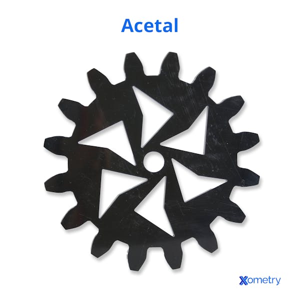

What Is Acetal?
The acetal polymers group can include both polyethers (-C-O-) and polyacetals (-O-C-O-). These are then divided into: homopolymers, manufactured using either formaldehyde or trioxane monomers; and copolymers, which combine two or more monomers.
Homopolymers are highly crystalline thermoplastic materials, generally having a helical atomic structure. The copolymers generally include small quantities of other cyclic ethers with additional methylene groups in the polymerization stage. The methylene components tend to result in better thermal and hydrolytic stability, which improves resistance to depolymerization.
As a result of its very good mechanical properties, acetal has become the preferred option for machine parts, manufacturing jigs, and metal component replacement. A wide spectrum of material options, chemical and UV resilience additives, and mechanical/electrical performance additives are available, making this a very broad family of specialist materials. The use of such additives applies to a wide range of niche applications.
Acetal poses severe health hazards during processing and in overheating conditions, as many forms break down to release formaldehyde gas. Good ventilation should be maintained in machining as, under even the moderate heat of rotating tools, trace formaldehyde can be released.
Acetal
Acetal part
