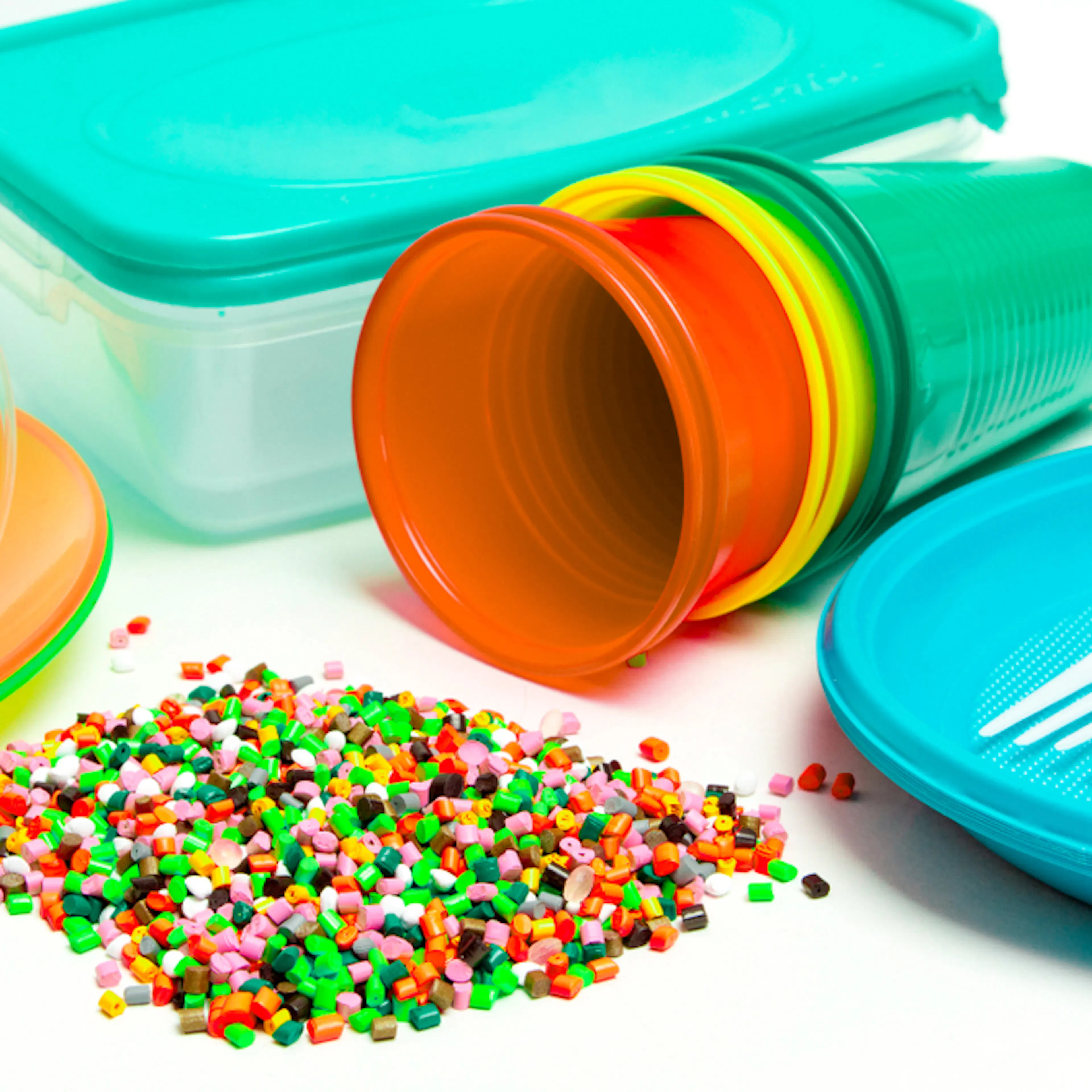

Semi-crystalline polymers. Image Credit: Shutterstock.com/StanislauV

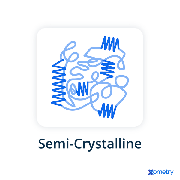

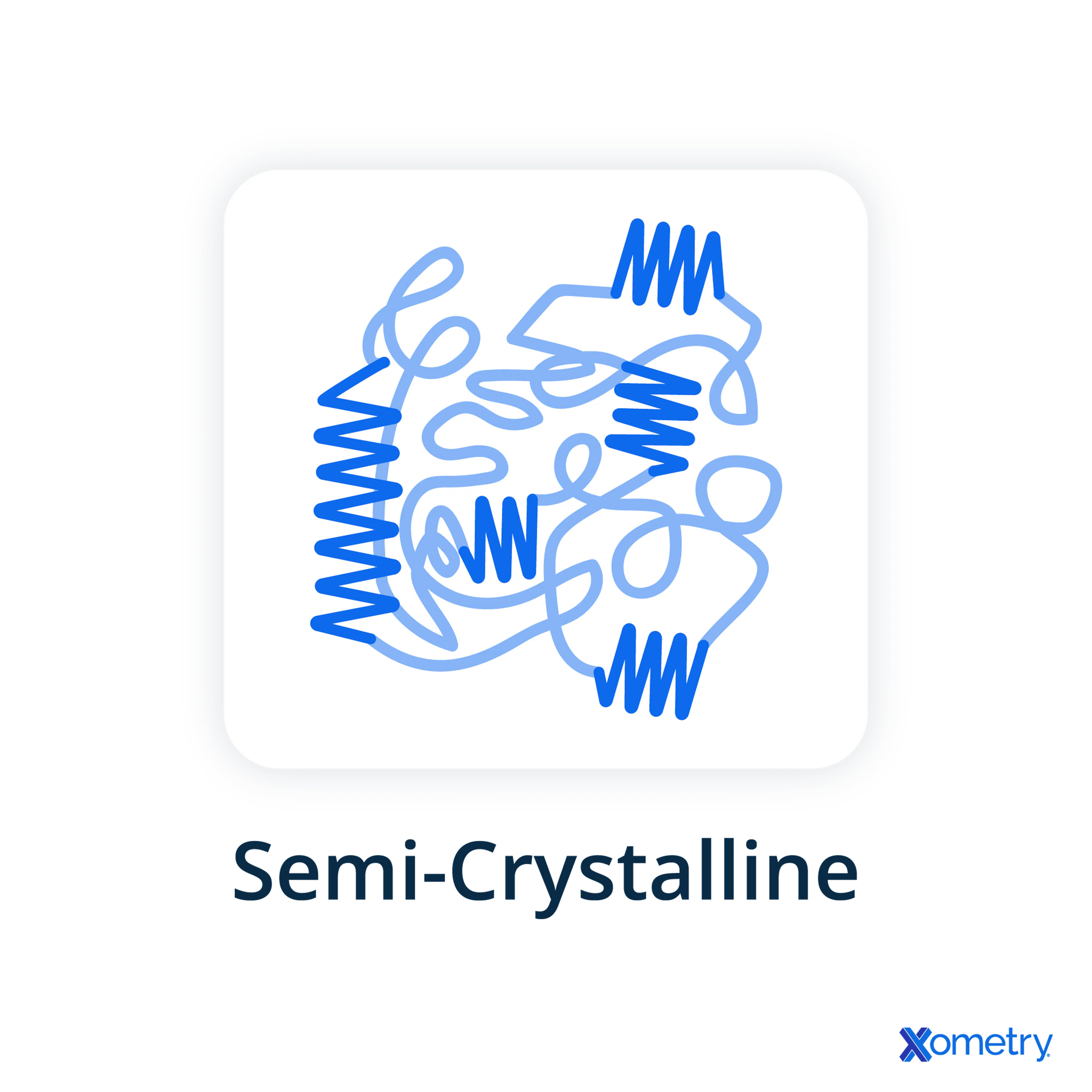

What Is a Semi-Crystalline Polymer?
A semi-crystalline polymer is one in which the long polymer chains are arranged in a fairly organized molecular structure and packed closely together. This structure results in semi-crystalline polymers having closely defined melting temperatures. It also causes these polymers to have anisotropic flow, meaning the polymer shrinks less in the direction of flow compared to the transverse direction. This can result in dimensional instability. Furthermore, the semi-crystalline structure gives a rigid material with a good wear resistance, but a poor impact resistance.
An illustration of a semi-crystalline structure

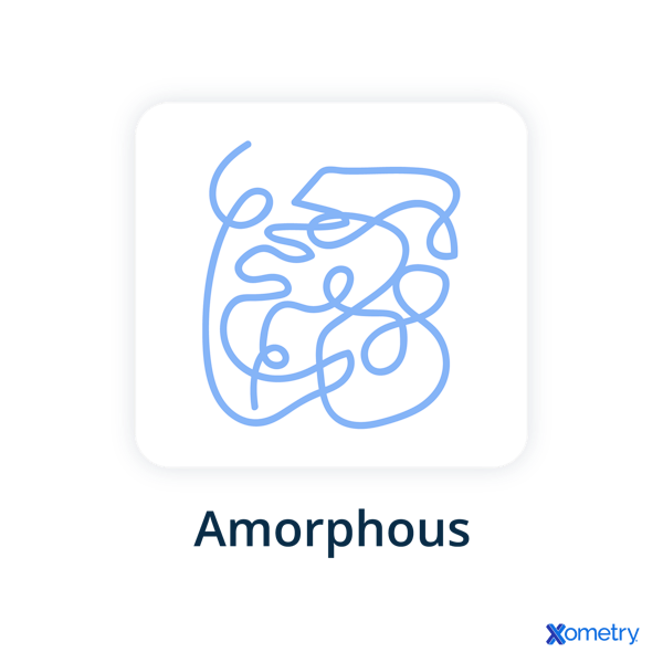

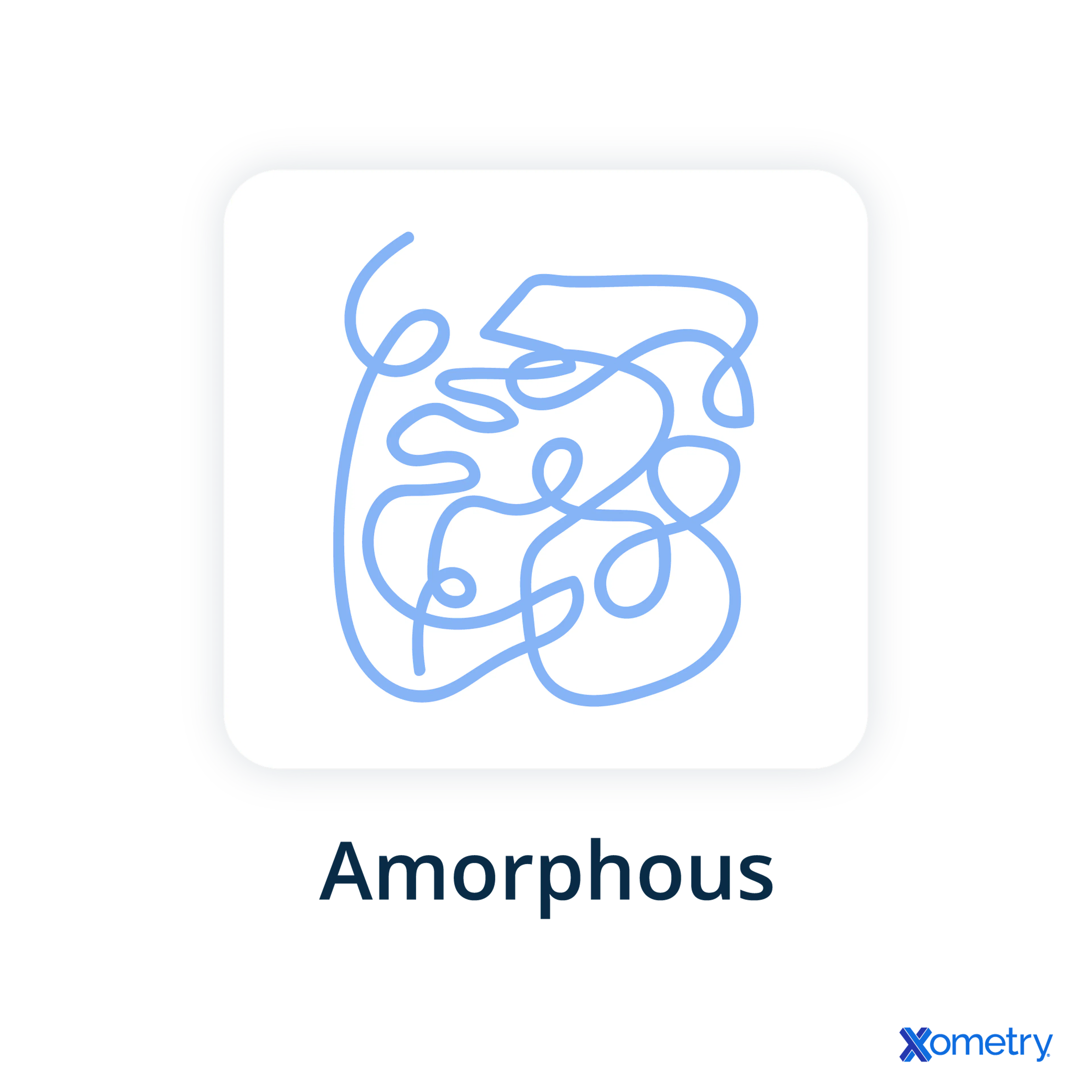

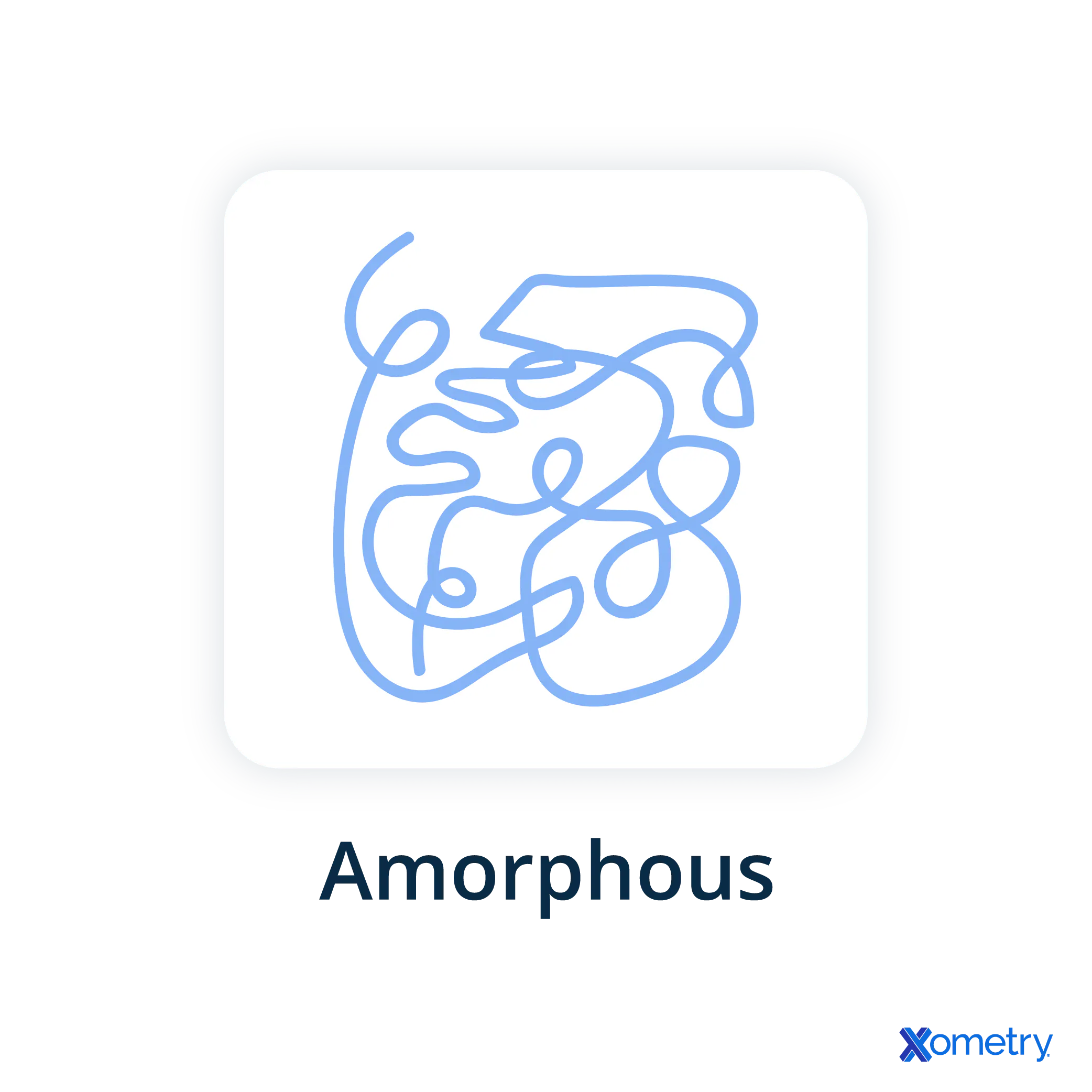

What Is Amorphous Polymer?
An amorphous polymer is one in which the long polymer chains are arranged haphazardly within the material’s structure—often compared to cooked spaghetti. This disorganized molecular structure influences the properties of amorphous polymers. In particular, they do not have clearly defined melting temperatures, but rather begin to soften while being heated. This occurs because different parts of the polymer structure melt over a range of temperatures. The amorphous structure allows isotropic flow (meaning uniform flow in all directions) and some flexibility and impact resistance.
An illustration of an amorphous structure
