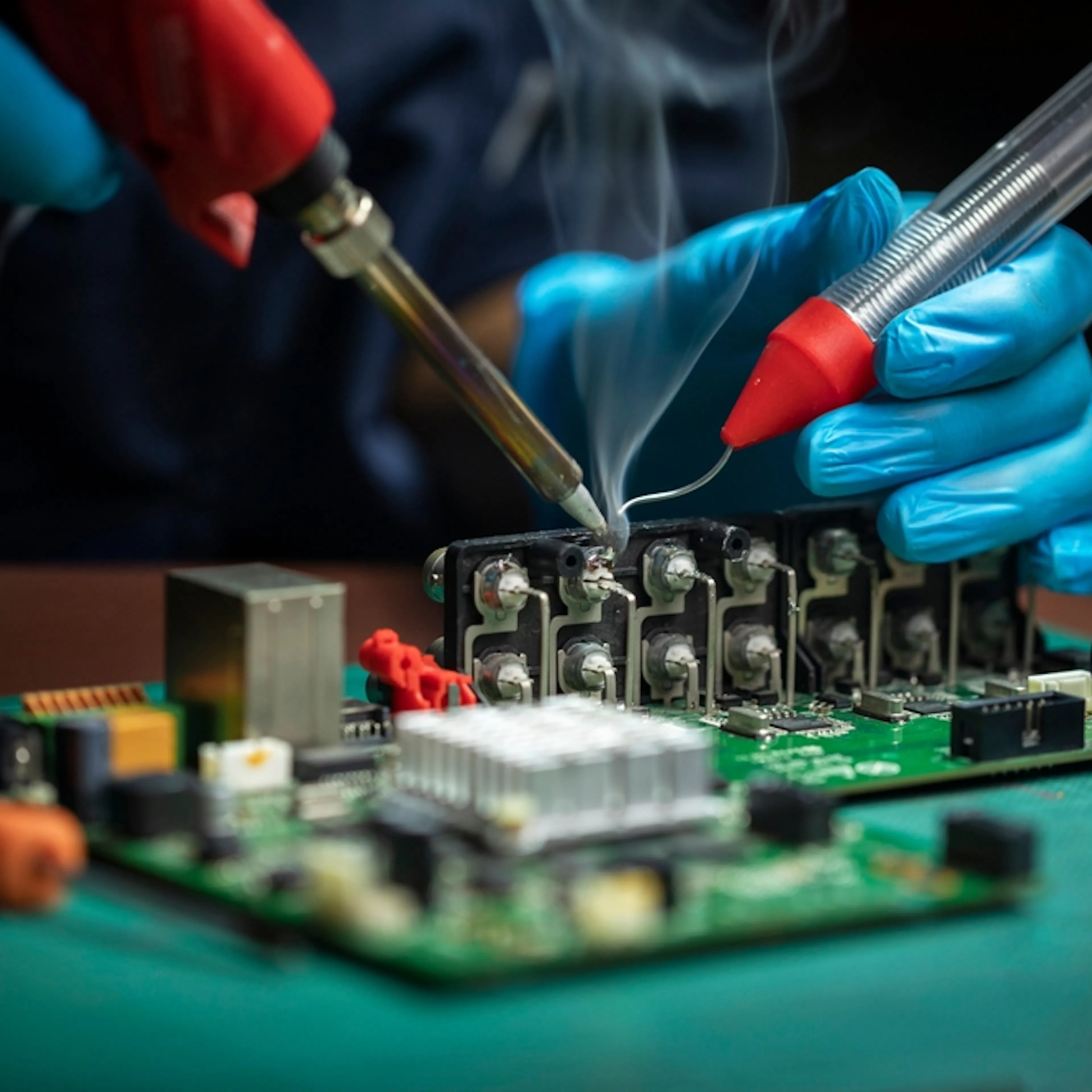

Circuit board soldering. Image Credit: Shutterstock.com/PitukTV

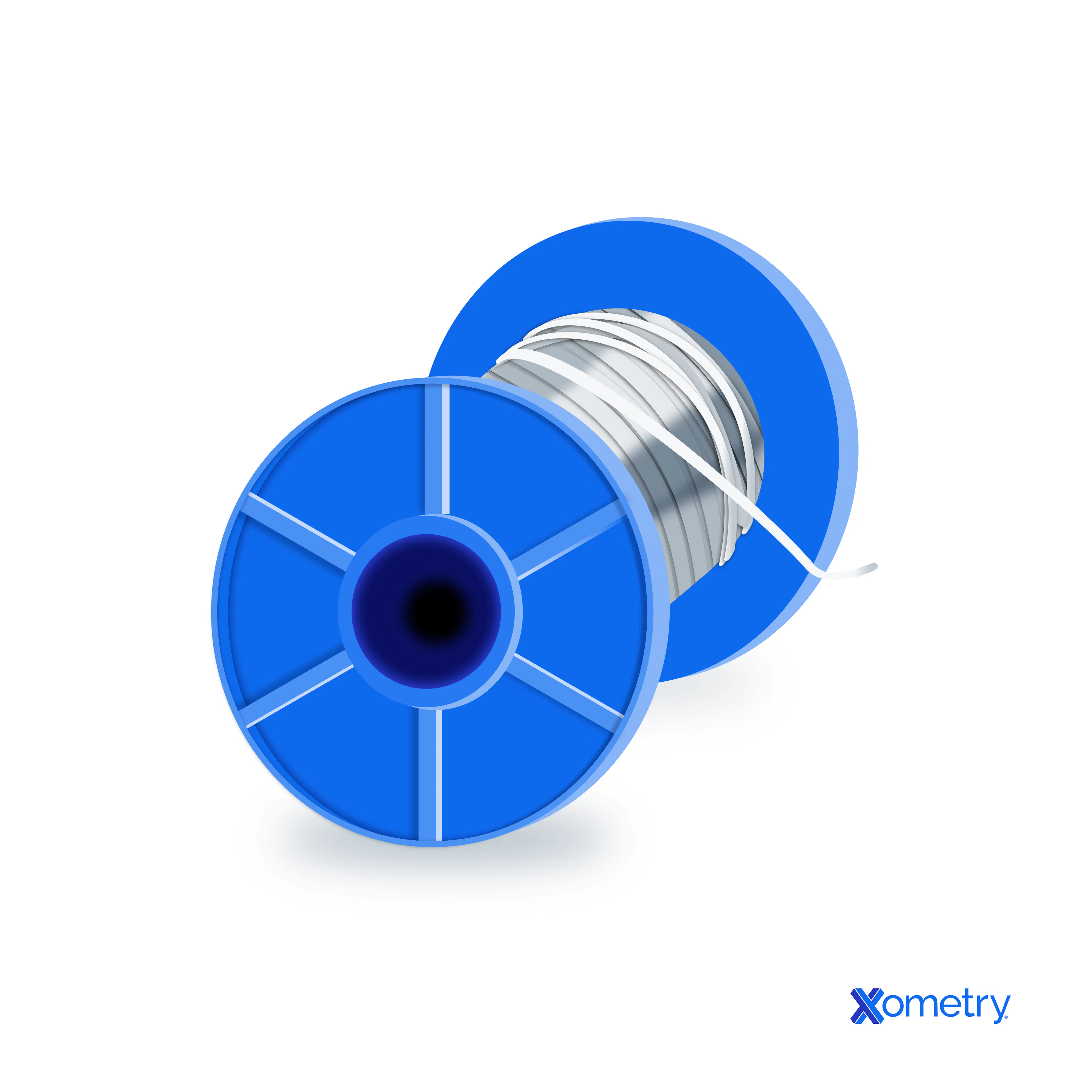

Solder is often supplied as a thin wire wrapped around a plastic spool. However, different wire thicknesses are available. Figure 1 below shows a typical roll of soldering wire:
solder wire
Solder wire.

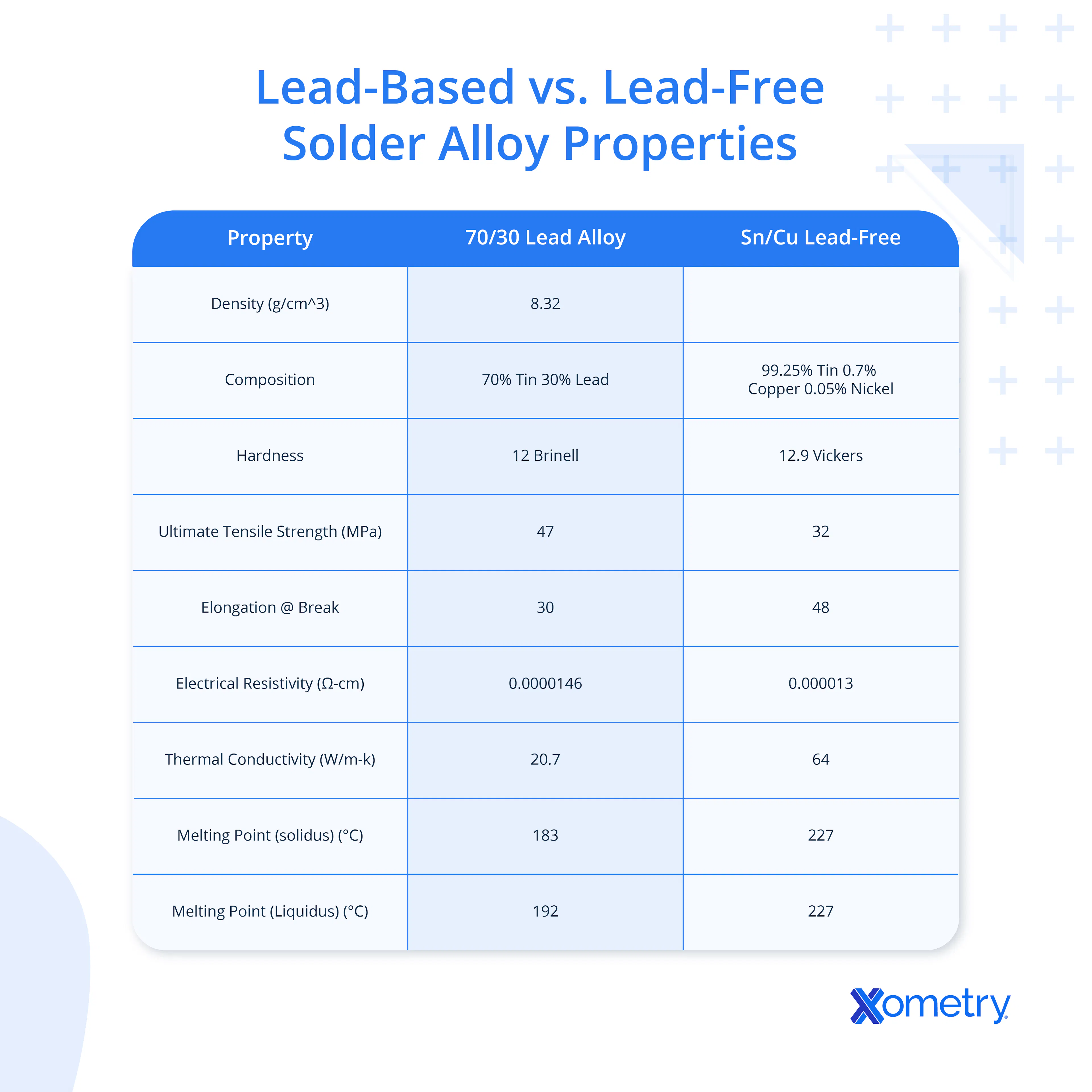

A wide range of different solder compositions exist for both lead-based and lead-free solder alloys. For comparative purposes, lead-based and lead-free solder alloys have been listed in Table 1 below:
Comparison of Properties of Lead-Based and Lead-Free Solder Alloys
