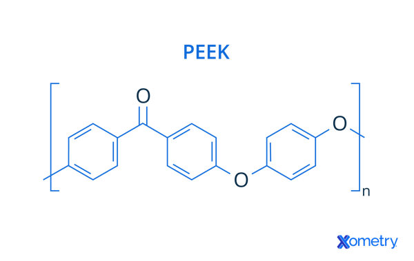

PEEK molecular structure
What Is Polyether Ether Ketone (PEEK)?
Polyether ether ketone (also known as PEEK) is a semicrystalline performance thermoplastic with high temperature, chemical, wear, and creep resistances and excellent strength properties. PEEK is part of a much larger class of polyaryletherketone (PAEK) polymers which include polyether ketone (PEK), polyether ether ketone ketone (PEEKK), polyether ketone ketone (PEKK), and others. However, PEEK is the most well-known polymer among variants.
How Is Polyether Ether Ketone (PEEK) Made?
PEEK can be made using different organic synthesis methods, but a standard process is a step-growth polymerization generated by the dialkylation of bisphenolate salts. For example, PEEK can be created via the nucleophilic substitution of 4,4' – difluorobenzophenone with hydroquinone in the presence of an anhydrous carbonate salt conducted in a polar aprotic solvent with a high melting temperature (commonly diphenyl sulfone). Despite being a mouthful, this is a simplified version of the complete synthesis, and many companies use proprietary mechanisms to enhance specific materials characteristics for intended applications. Regardless of the particular mechanism, PEEK is built using a stiff aromatic polymer base, contributing to its high temperature and wear resistances compared to other polymers.
