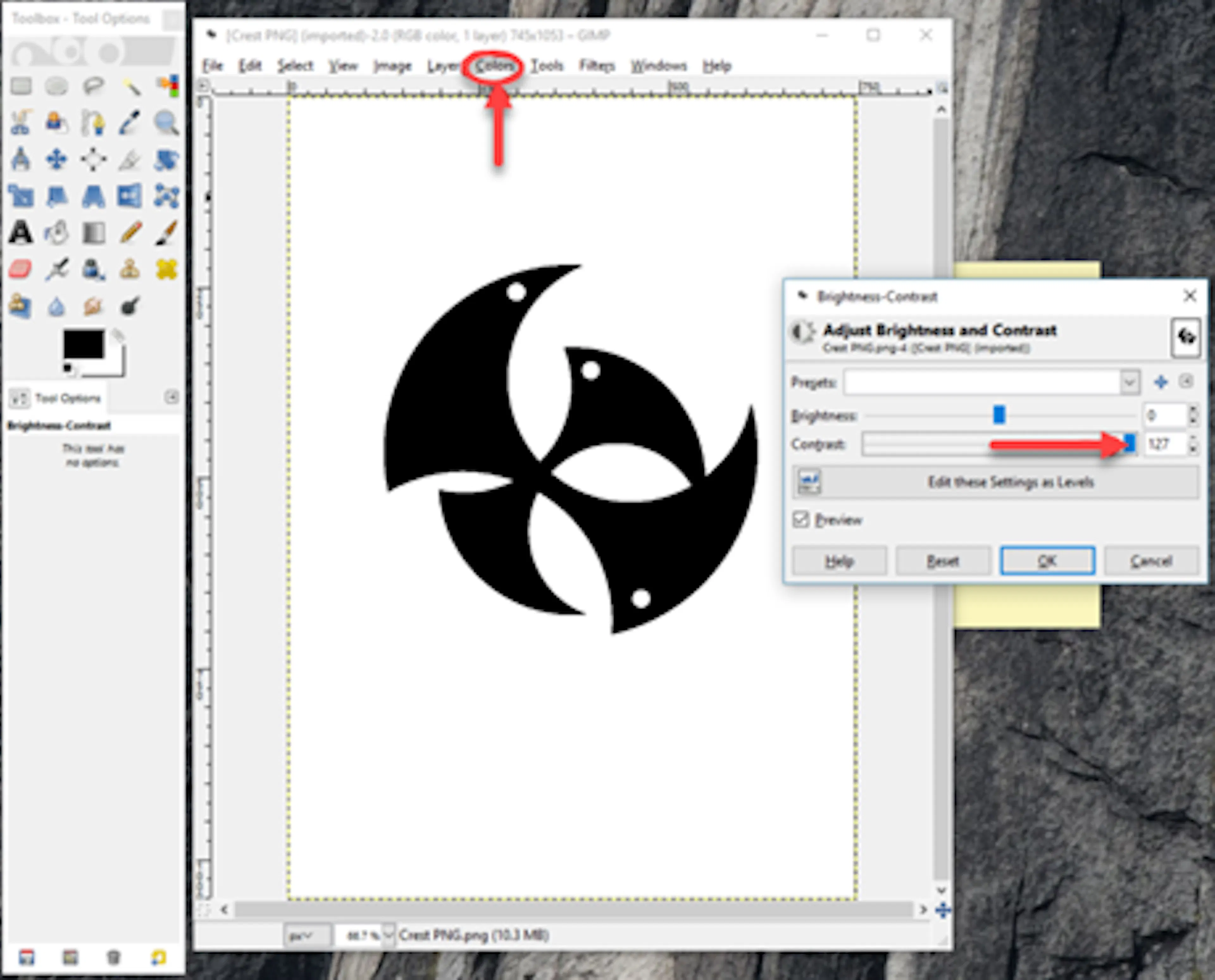

First, we will need to open the image file in GIMP and prepare it for conversion. Once the image is open, choose "Colors" from the menu bar at the top and select "Brightness/Contrast." We will boost the contrast as high as possible by moving the slider to the right, leaving the brightness adjustment at 0, and then clicking the "OK" button.
Boosting the contrast sharpens up the edges of the design.

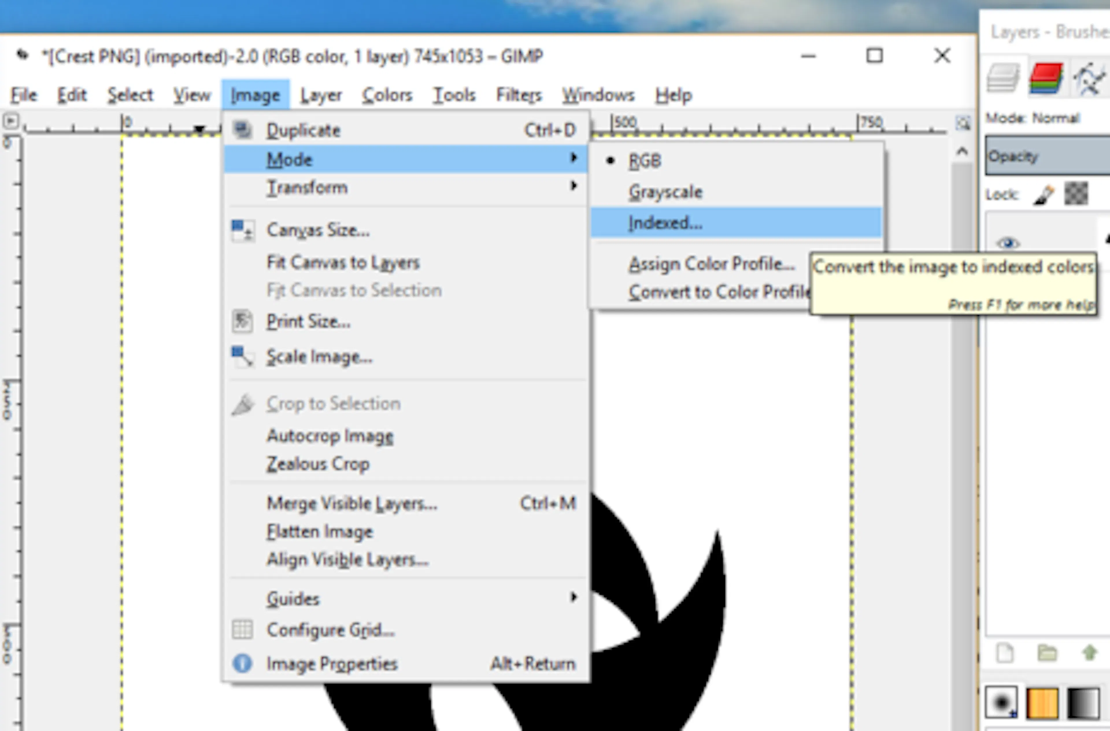

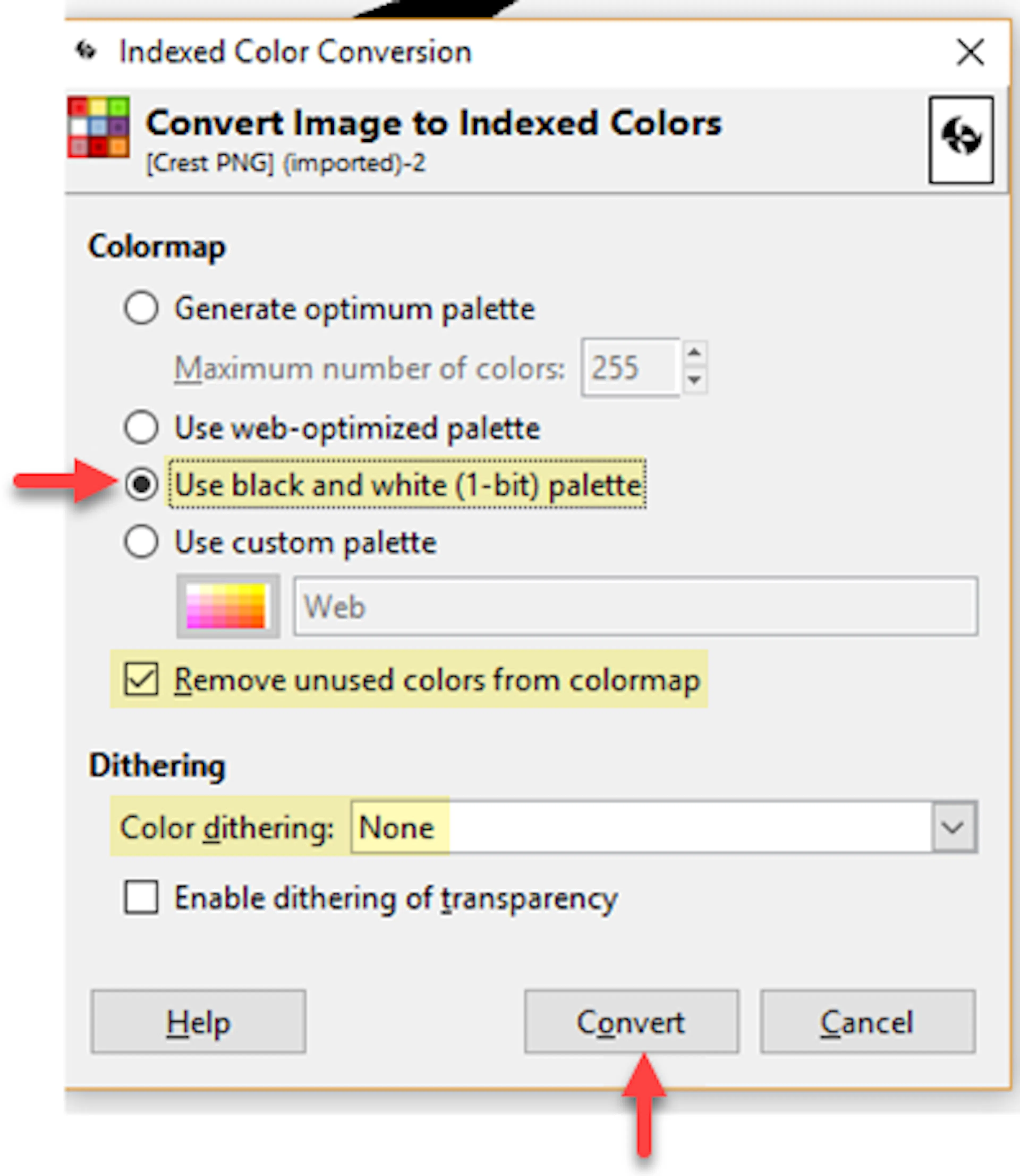

Next, we will need to index the colors to create a pure black and white image. On the menu bar, select "Image" then "Mode" and then "Indexed..." from the dropdown.
A dialog box will appear with some options to select. From the options, click the radio button for "Use black and white (1-bit) palette," leave "Remove unused colors from colormap" checked, and ensure color dithering is set to "None." Once all the selections are made, click "Convert" to proceed.
Now our file is ready to be traced in Inkscape. Export or save the image as a new PNG image from GIMP.

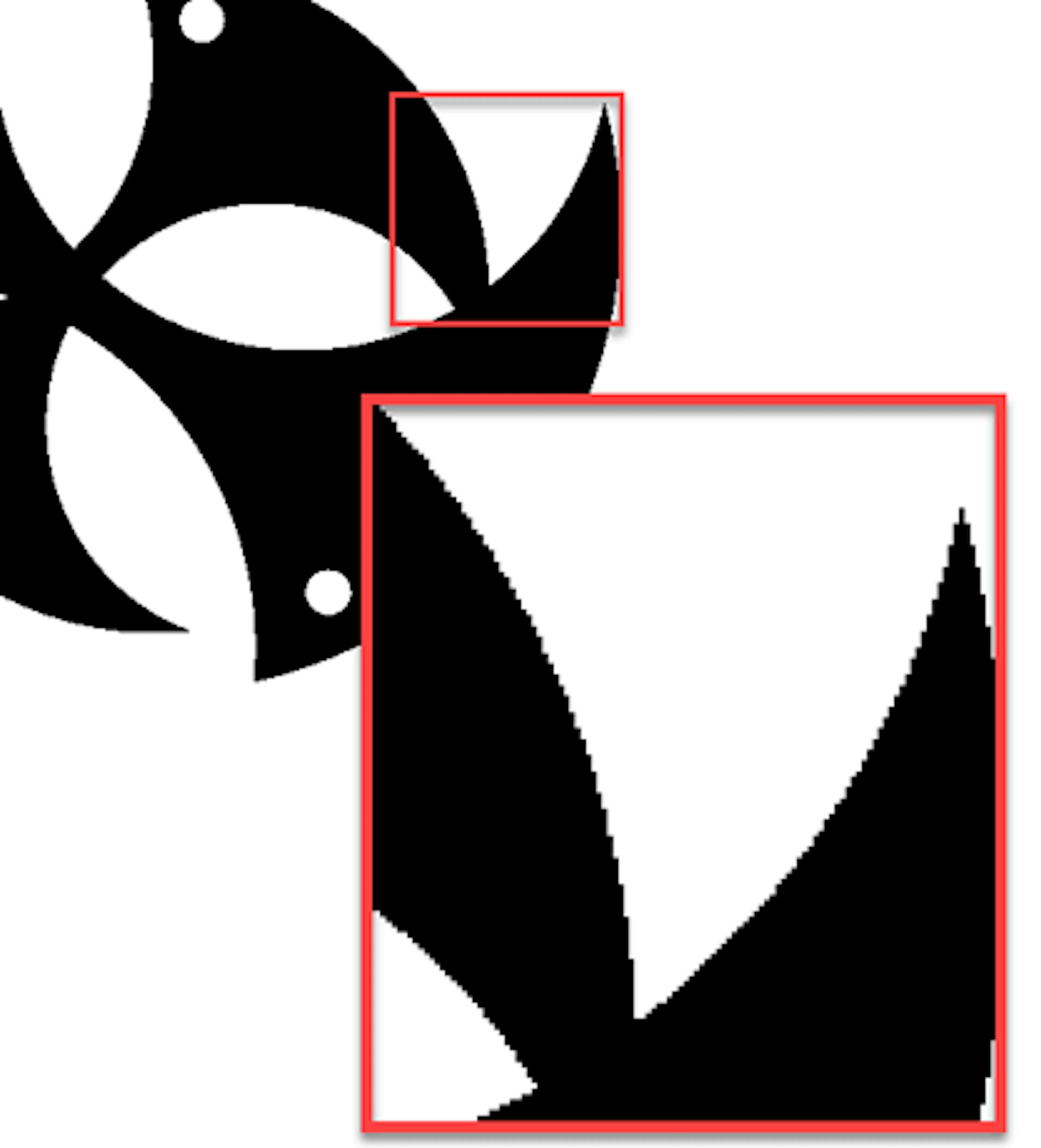

If you look closely at the edges of the image, they may look a little rough. This is normal at this point in the process. When we use Inkscape to trace the outlines, they will smooth out. You can see an example of the rough edges in the photo below.

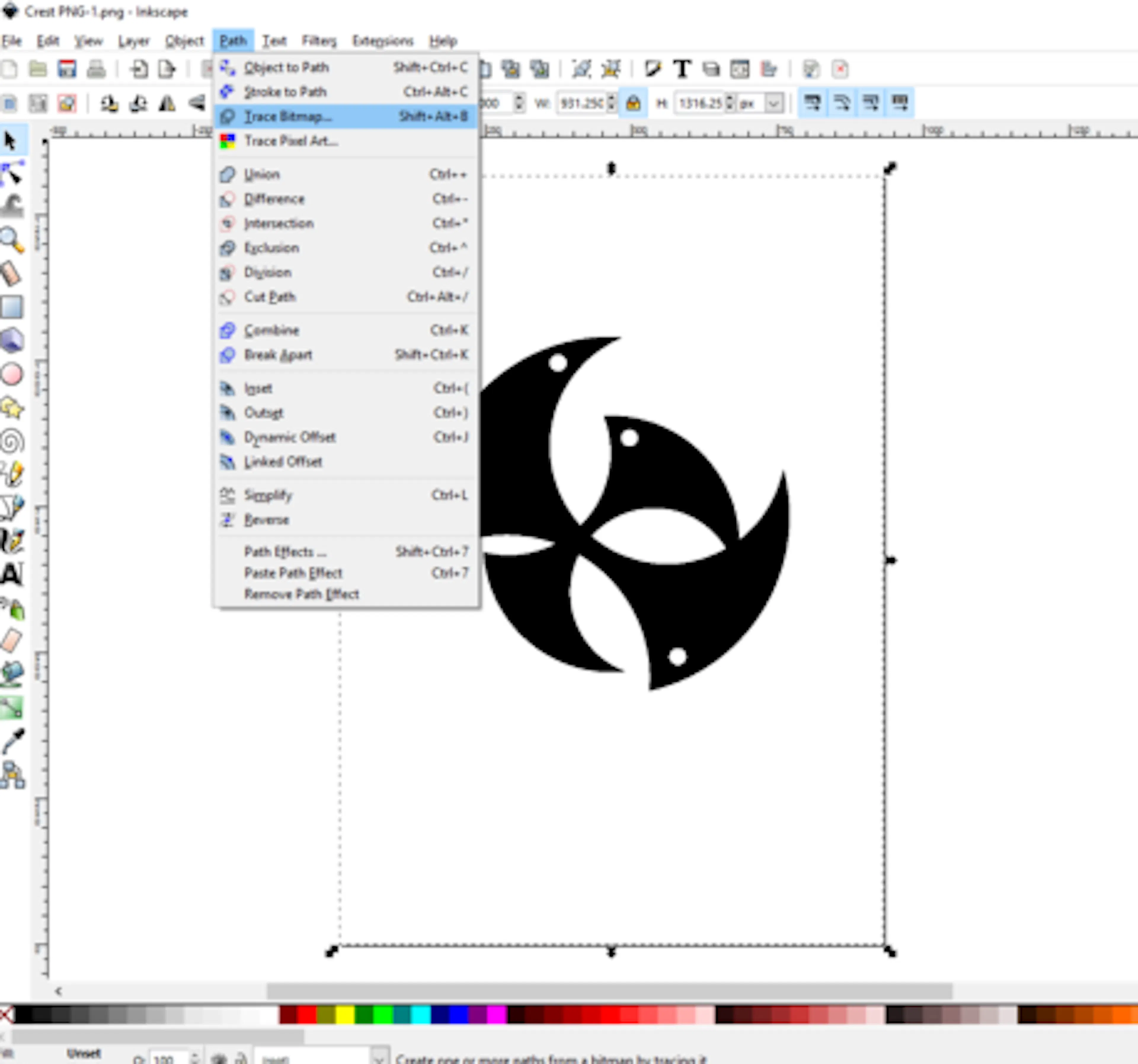

Now we will take the PNG file we saved from GIMP and open it in Inkscape. Once it's open, click on the image. You'll notice the resizing arrows go around the entire document instead of the design itself. This is an indicator that the image is not yet a vector image.

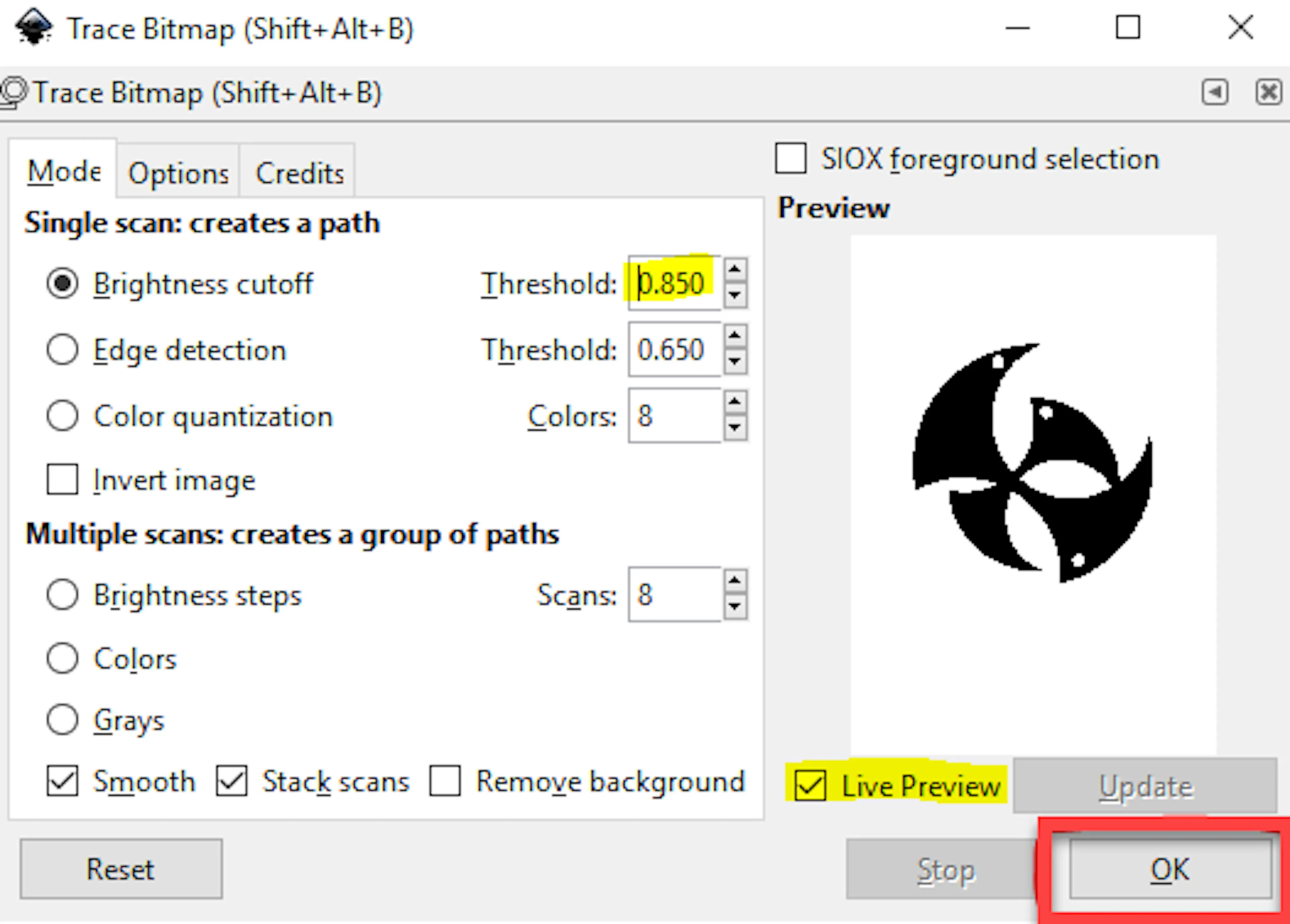

Select "Path" from the menu bar and then "Trace Bitmap..."
With the image still selected, a pop-up window should appear. We will adjust a few settings to ensure we get a good trace of our design. We will keep the "Live Preview" checkbox in the lower right selected to ensure we don't introduce any significant issues while adjusting the trace settings.
Since we are working from a pure black and white image, we will leave the "Brightness Cutoff" radio button selected. Setting the brightness cutoff threshold somewhere between 0.550 and 0.999 usually works well. Keep an eye on the preview image as you adjust this setting to ensure you don't push the setting too far. Click the "OK" button to proceed once the threshold is dialed in.

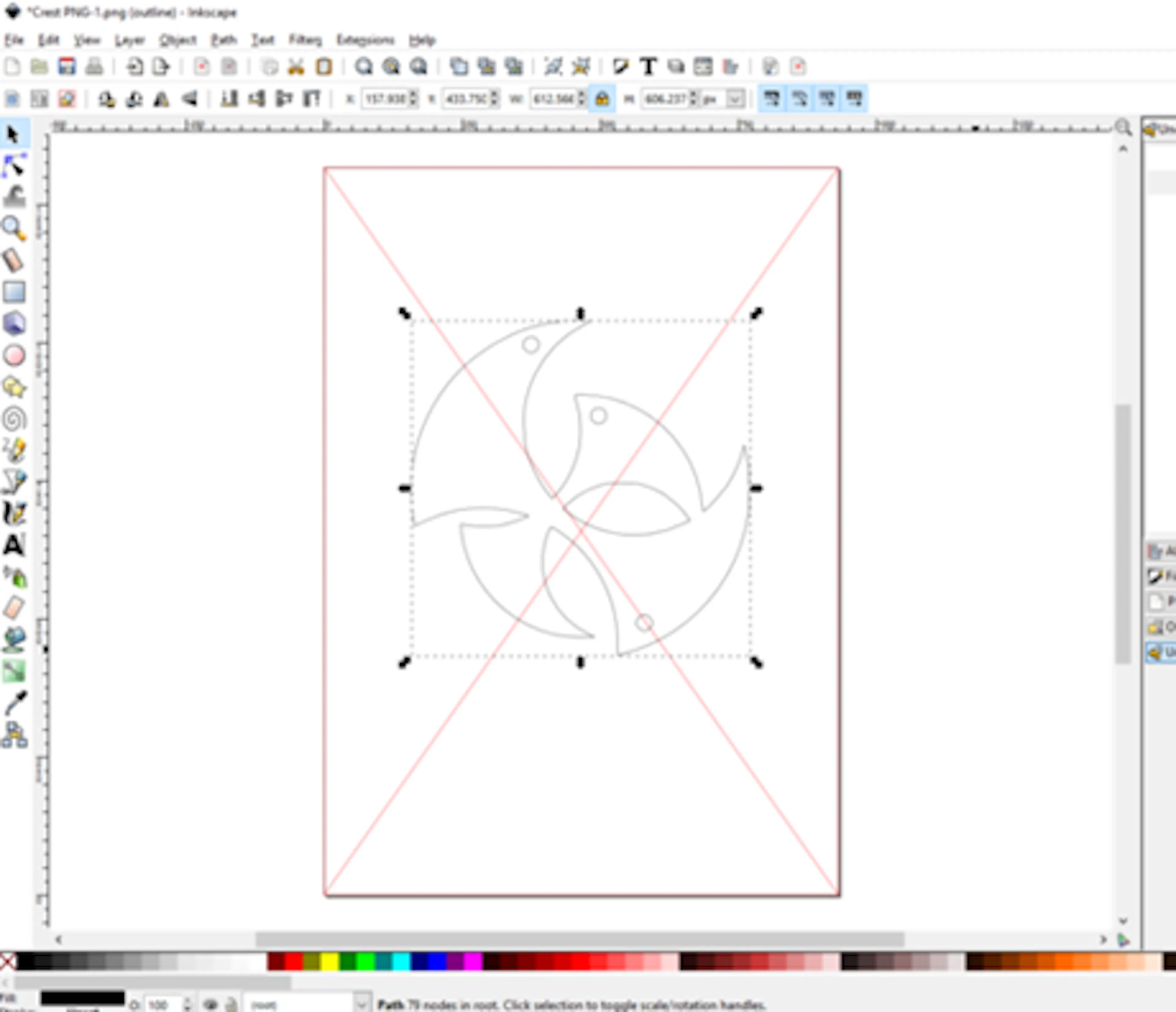

We should now have a vector image generated from our original raster image. Inkscape will have both versions (vector and raster images) displayed, with the vector image displayed on top. At this point, we can select the raster image and delete it, leaving just the traced vector image.
Now we will save our file out as a DXF. Select "File" and "Save As" from the top menu. From the file extensions list, choose DXF.

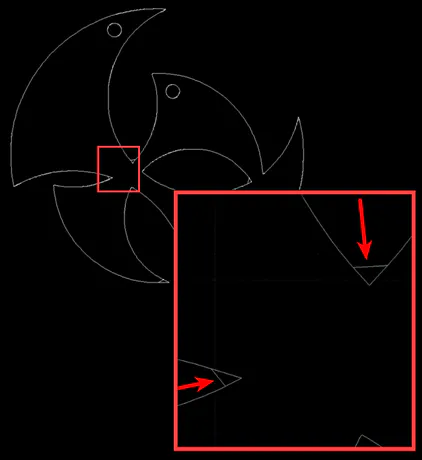

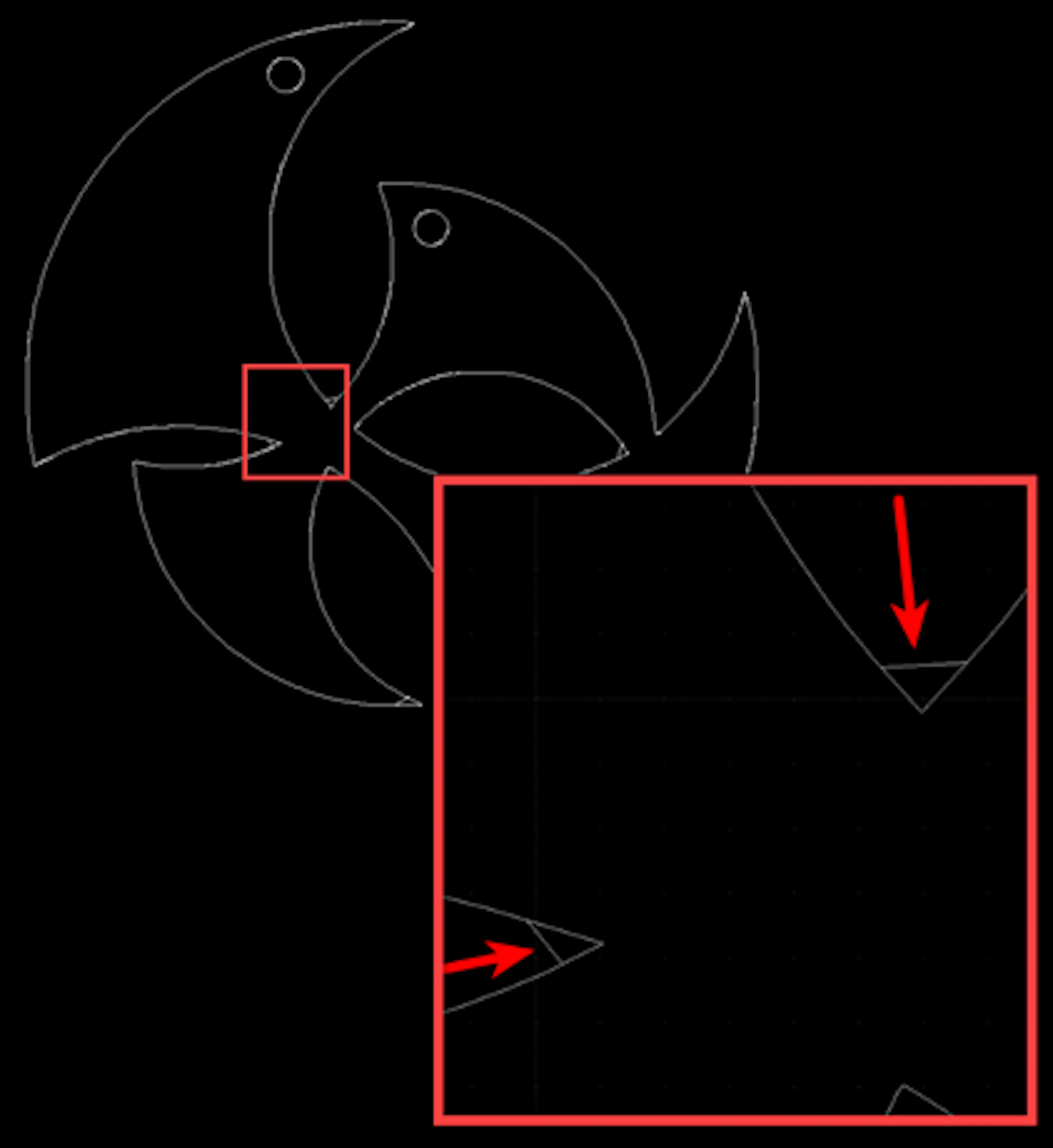

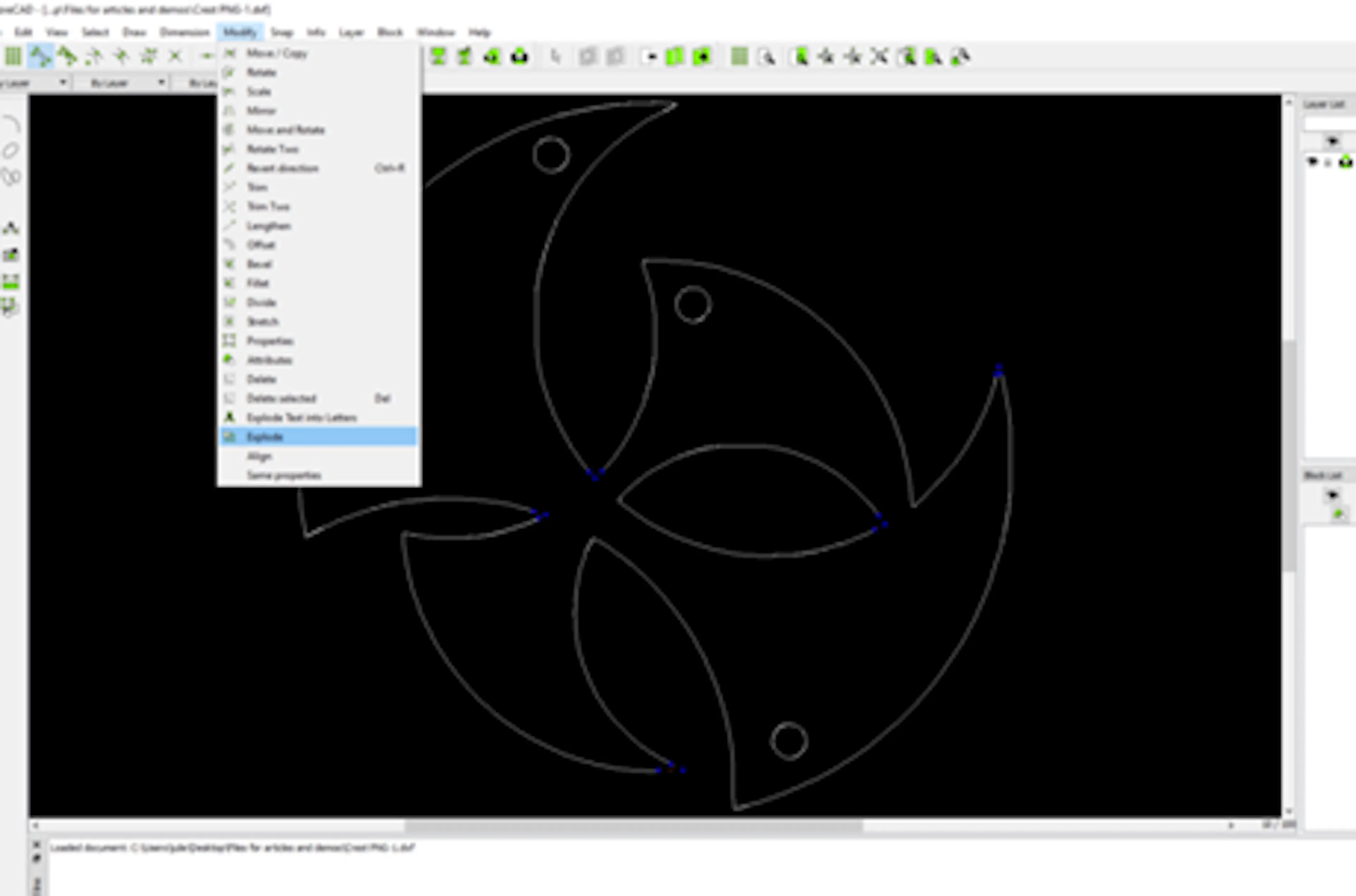

Sometimes the exported DXF will contain errors that must be cleaned up before being uploaded and used for manufacturing. To check for this, open the DXF file we just exported in LibreCAD and look for errors. In our example, we can see some extra lines were drawn around the sharp internal corners of the design, as shown below.
We can remove the excess lines by first selecting them one by one. After they have been selected, go to the menu bar and choose "Modify" and then the "Explode" option. This option will separate the lines from the rest of our part and allow us to remove them. Select the extra lines again and then hit the delete key on your keyboard to remove them from the file.
Now that the issues have been resolved, save the file as an R12 DXF file using the same name.

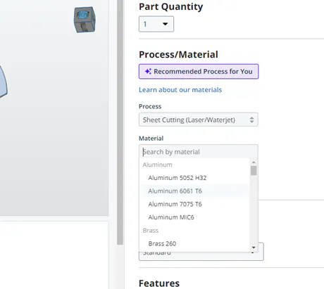

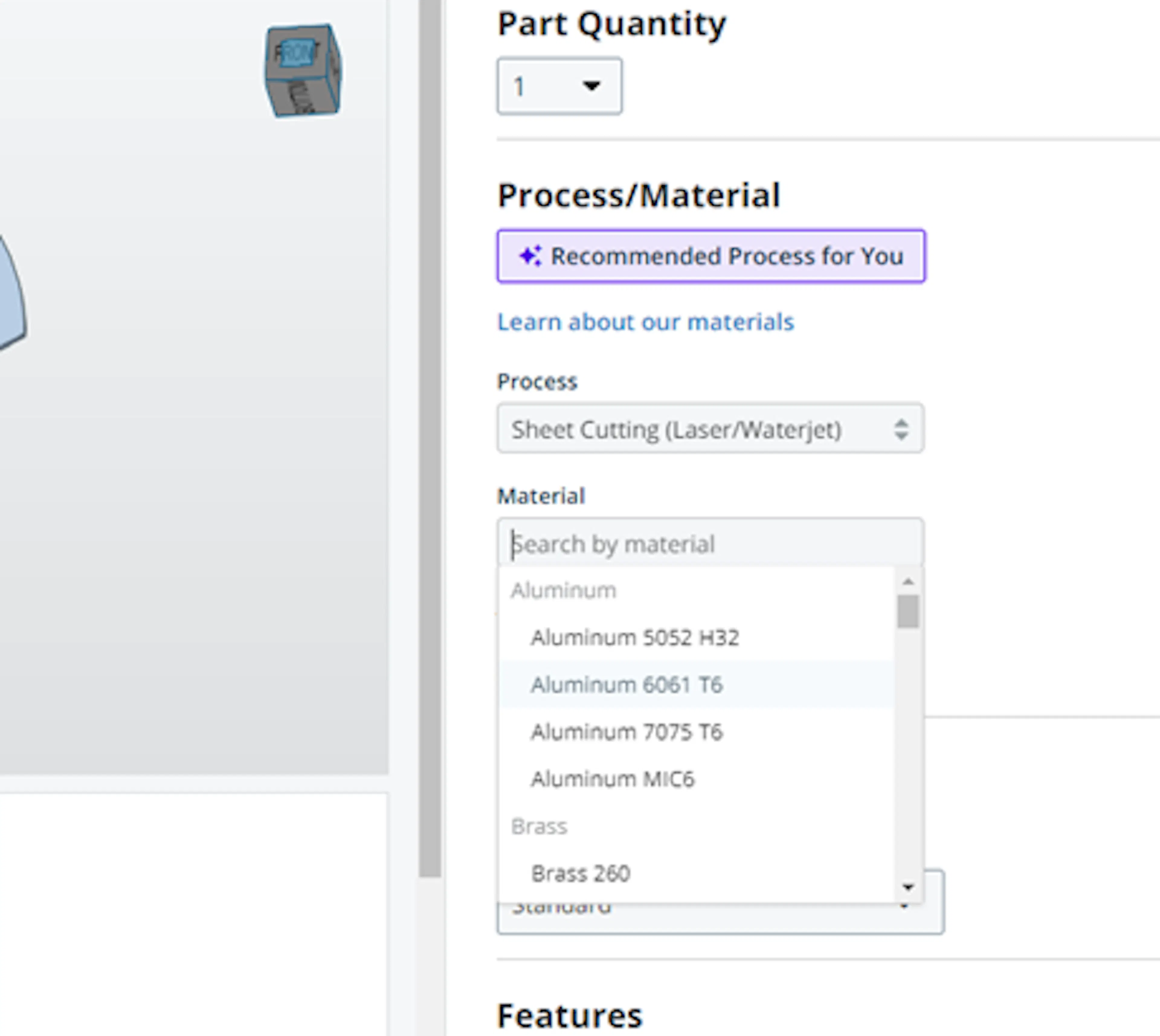

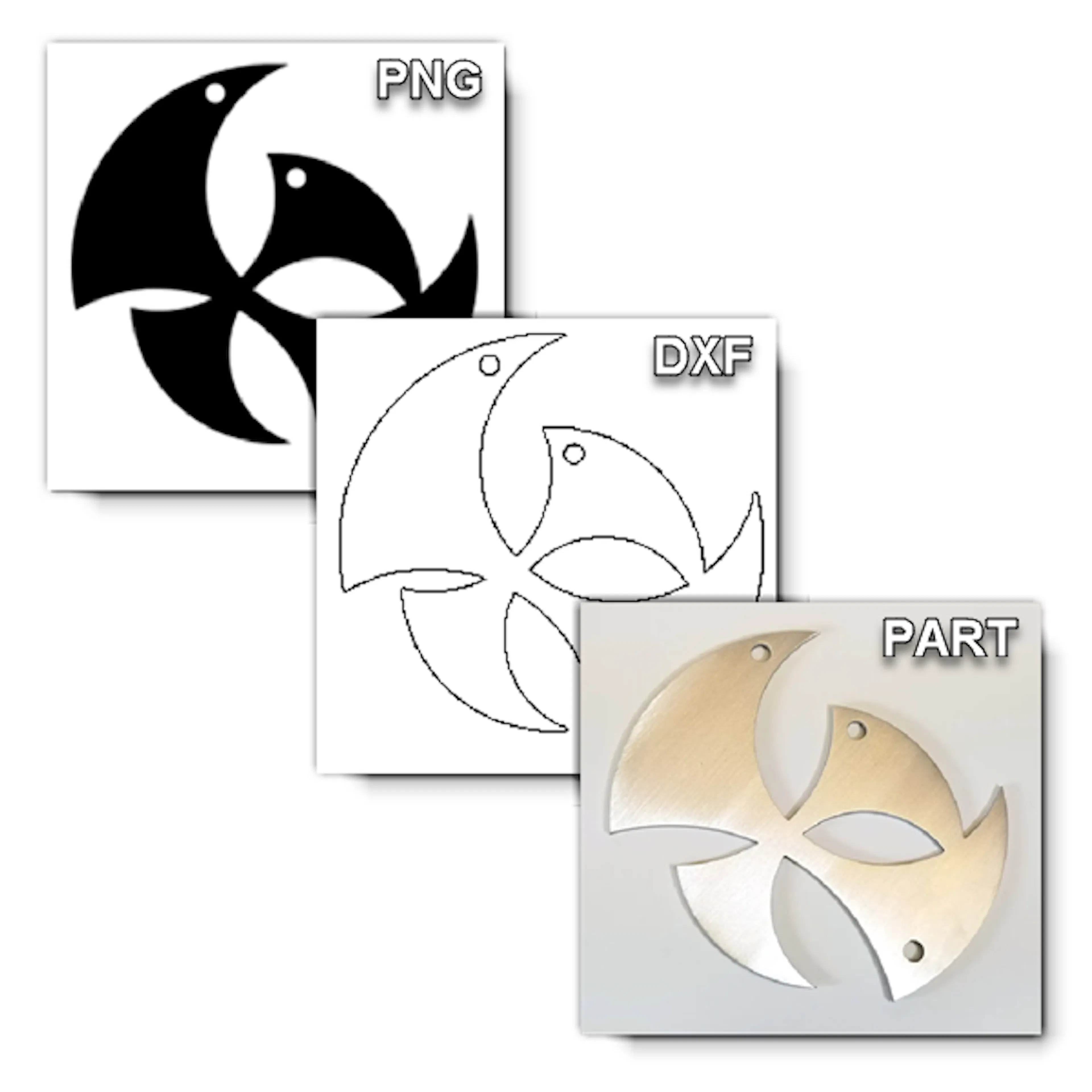

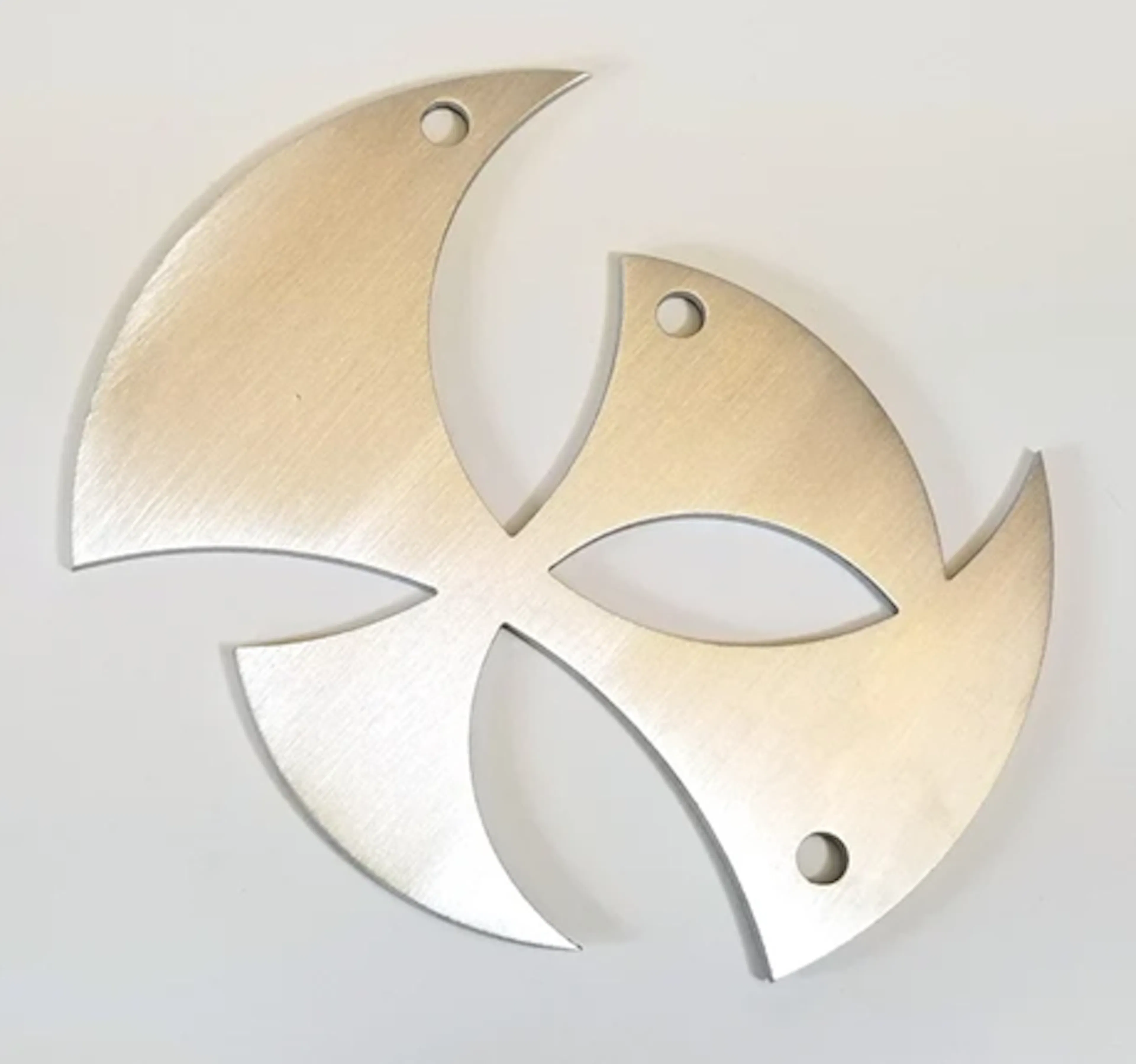

We now have a file that can be used for manufacturing. This design would be a great candidate for waterjet cutting or laser cutting. You can upload your DXF file to the Xometry Instant Quote Engine and choose from dozens of materials to get an instant price and lead time.
Once you are satisfied with your quote, you can proceed to checkout to order your custom parts. Below is a picture of how our part turned out.

In summary, we were able to go from an image to a real part by following these general guidelines:
  • Prepare our source image in GIMP by boosting the contrast and converting it to a 1-bit black and white image.
  • Use Inkscape's tracing function to generate a rough DXF from our prepared source image.
  • Clean up our DXF using LibreCAD.
  • Uploading our final DXF to the Xometry Instant Quoting Engine and ordering our part.
