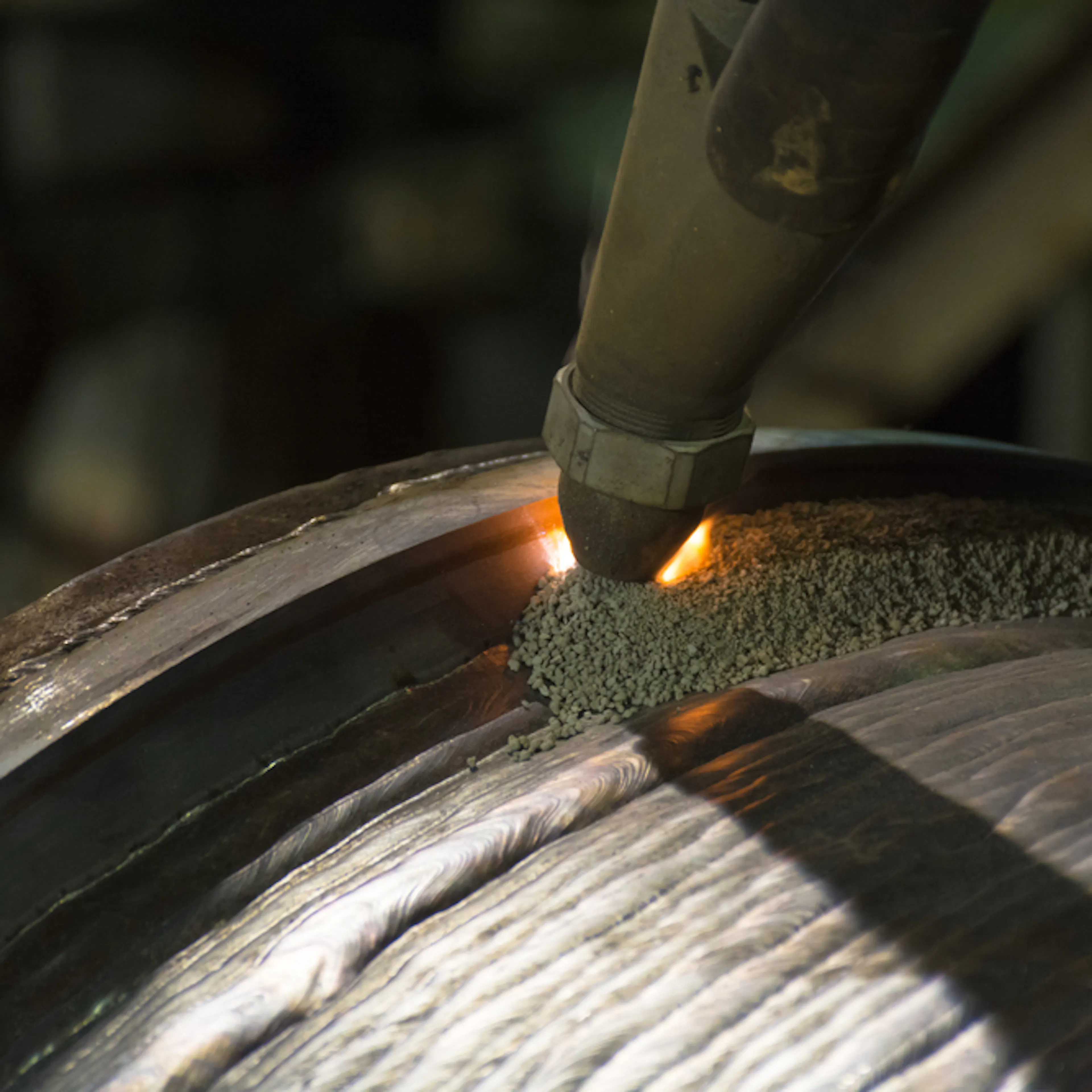

Submerged arc welding (SAW) is a well-established process that uses a continuous feed of a filler/electrode, melted by an electric arc between the electrode/filler and the work. Submersion refers to the hopper-fed flux powder that covers the weld path. This approach allows greater control and automation of straightforward welds. It reduces the direct need for operator skill, as the process—once established and validated—will be highly repeatable.
This article will discuss submerged arc welding, its importance, how it works, its advantages and disadvantages, and the equipment used.
What Is Submerged Arc Welding (SAW)?
Submerged arc welding is a long-established, automated welding process in which an AC arc is formed between a heavy gauge workpiece and a continuously fed electrode. The arc is shielded by a directly deposited granular flux material of several possible varieties. This flux stream is fed over the weld zone to provide the exclusion of atmospheric contamination and a reducing environment. It also acts to contain some of the arc energy in the melt pool, enhancing weld quality and improving the application of energy. The non-adhesive, gravity-fed nature of the flux material implies a significant limitation—that only welding of upward-facing and close-to-horizontal seams is practical using SAW.

What Is the Flux Used in Submerged Arc Welding?
In SAW, a granular flux material is used to cover the arc and the weld pool. It is gravity deposited as a blanket over the active weld area. The flux serves several purposes, playing a crucial role in the welding process. Flux composition and properties vary depending on the application and the base metals being welded. Examples of flux are: basic (alkali) fluxes, acidic fluxes, neutral fluxes, and alloyed fluxes.
