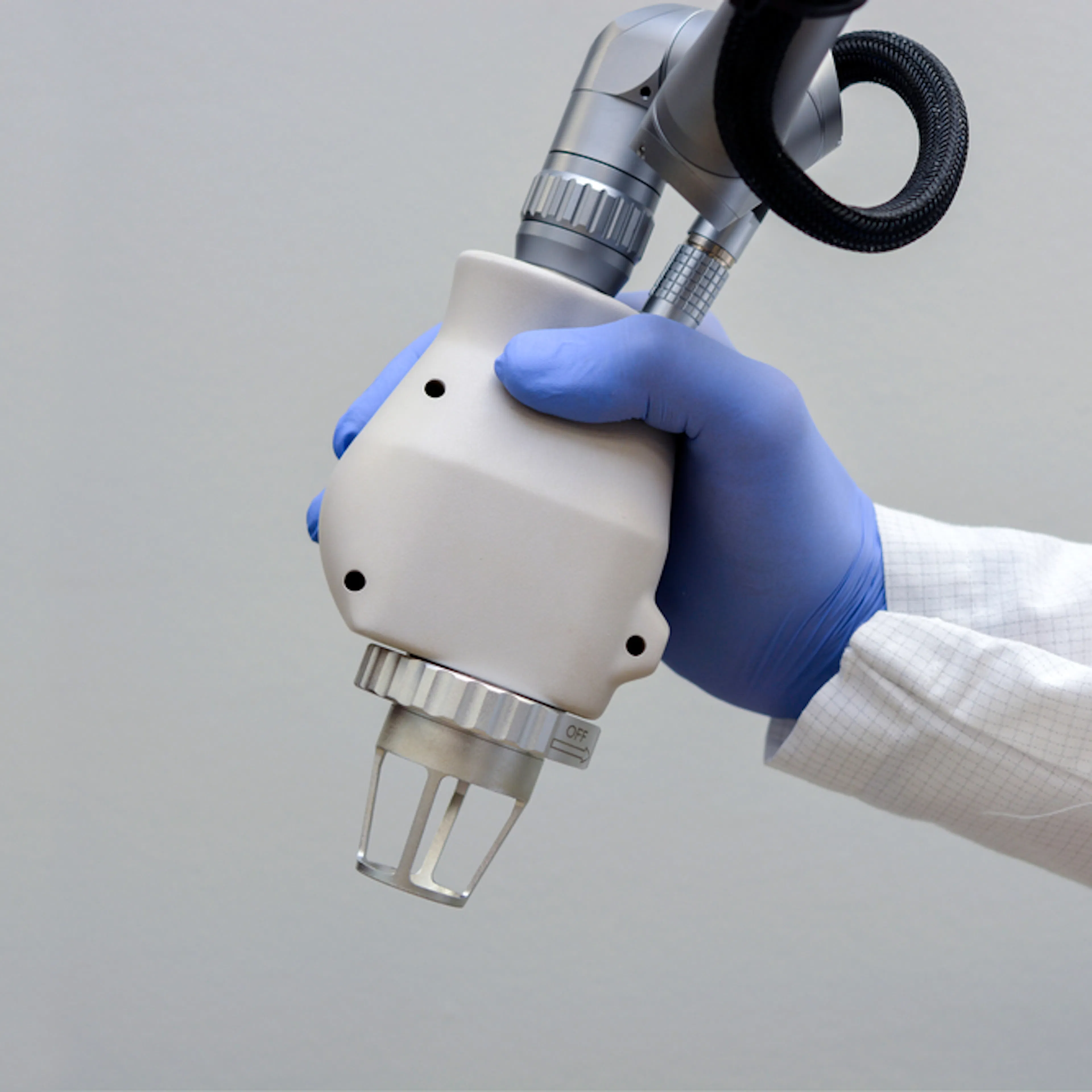

CO2 fractional laser hand piece. Image Credit: Shutterstock.com/AlteredR

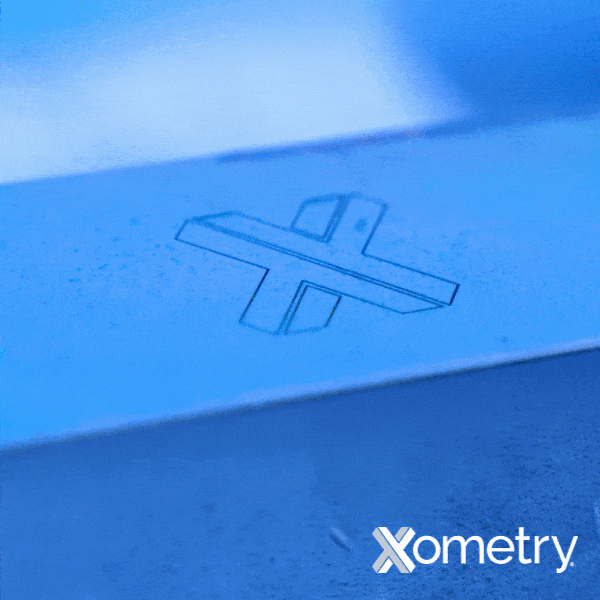

Laser marking
Laser marking at Xometry
