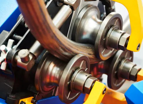

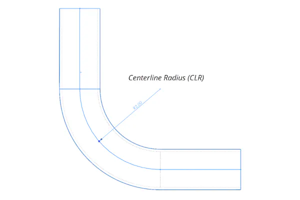

The bend radius of a tube is from the radius to the centerline of the tube. This curve is commonly referred to as the centerline radius and abbreviates as “CLR.” The minimum achievable bend radius will depend on factors such as the type of material and its wall thickness. Keep CLR at least 2*Ø and below 6” radius when possible. Your radius should be twice the size of the outer diameter of the tube. For example, if you use tubing with a 1” outside diameter, you should design your bends with at least a 2” CLR. This CLR is ideal because tooling to produce a “2*Ø” radius is common, and most materials won’t have an issue with this bend size. Designing below this may incur charges for specialized tooling and increase risk. For large bends which require the roll bending method, we recommend following the 7*Ø guideline. See a list of Xometry's standard tube sizes here.
Pro Tip: Limiting your centerline radius to below 6” and designing bends in whole number multiples of the OD (e.g., 1*Ø, 2*Ø, 3*Ø, etc.) will help avoid custom tooling charges and longer lead times. 2*Ø tooling is the minimum recommendation for draw bending and the most common tooling size.

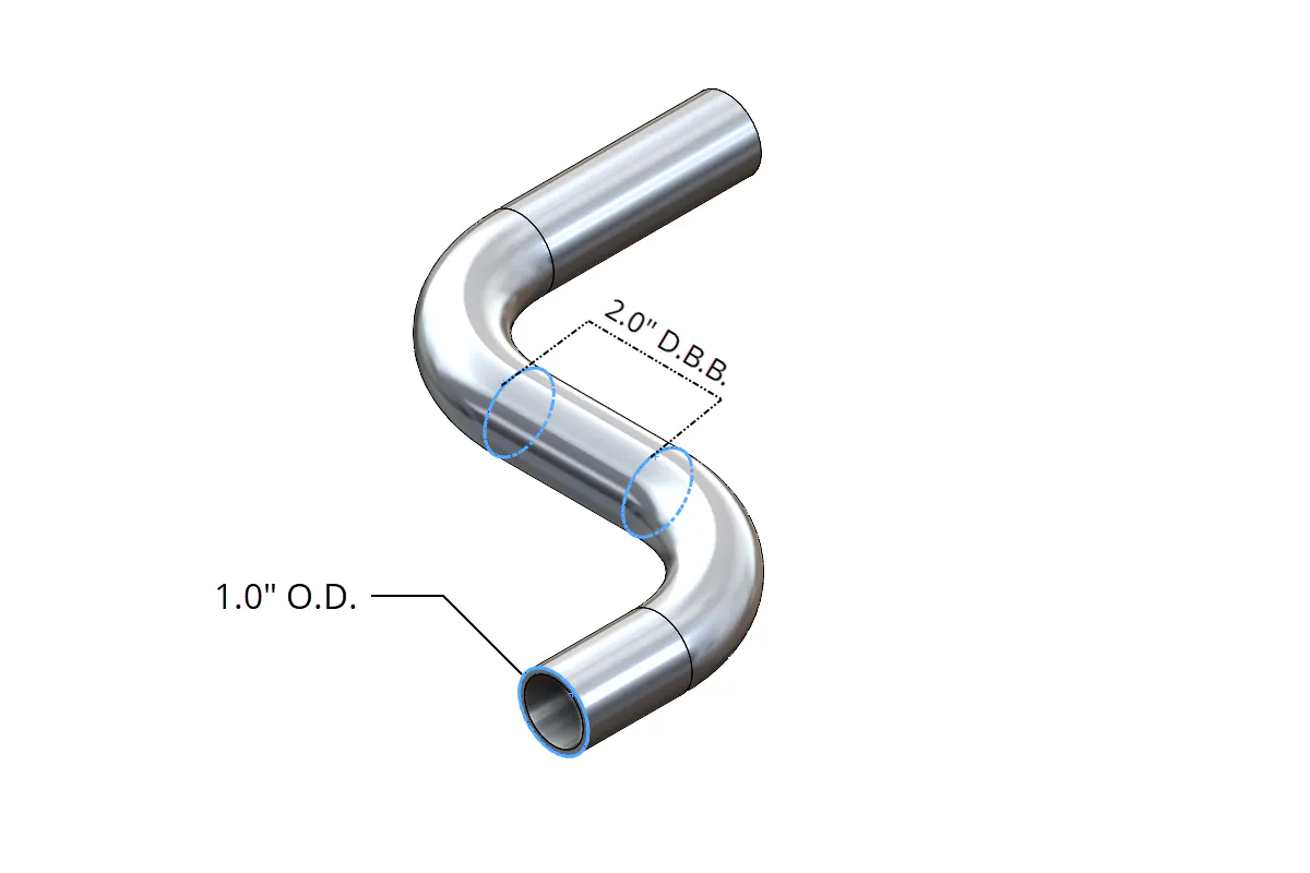

The distance between bends, or “DBB” for short, is an essential consideration in multi-bend designs. DBB is the length that remains straight before the first or next bend. Having enough straight distance is crucial to allow the tooling to grip the part during bending. Having too short of a gripping area reduces leverage which leads to slippage and requires the machine to exert greater forces to produce the next bend, which can wear down machinery and tooling more quickly. Multi-stack machines and compound tooling can work around a short DBB, but these setups will come at a higher cost.
Pro Tip: Maintain a minimum straight distance of at least 2xØ between bends; the more space, the better.

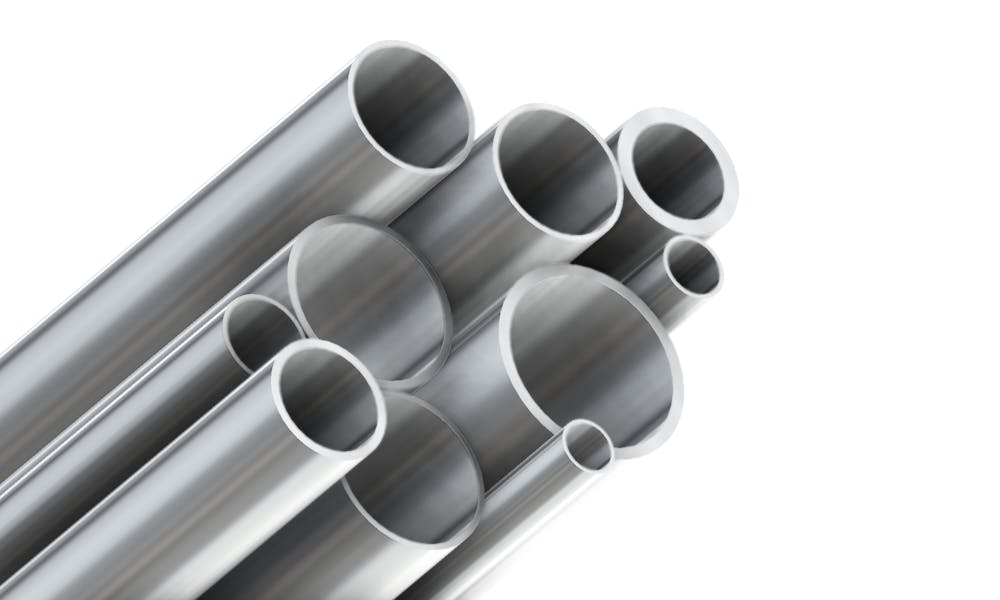

Choosing standard-sized tubing is vital regarding low costs and lead times. Common tubing materials will generally be more readily available and be suitable for orders of virtually any size. If a non-standard size is specified, it will require a custom material order or even a custom extrusion--drastically increasing lead time, pricing, and minimum batch requirements. Using standardized tubing also means the manufacturer is more likely to have tooling for that size of tubing, which helps avoid costly custom tooling charges.
It is essential to recognize the difference between pipe and tube stock because their measurements differ. For example, a 2” round tube will measure 2” outer diameter, whereas a 2” nominal pipe, schedule 40, will have an outer diameter of 2.38”. Pipes are for pressurized applications with their measurements described by inner nominal diameter plus the wall thickness, called schedule. Piping is always round, where tubes can be various shapes from round, rectangular, hexagonal, etc. A tube is for general purpose applications, including structural components and their measurements described by its outer and inner diameters. Tube also has tighter tolerances on dimensions.
Pro Tip: Design around readily available standardized tube sizes. Refer to Xometry’s Standard Tube Sizes page for a list of commonly stocked pipe and tube materials!

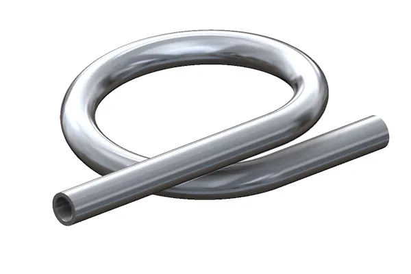

Certain bent shapes are highly complex or impossible to produce by bending from one piece. Some complex bends require sectioning and welding, which greatly affect cost and efficiency. The reason is that as a tube is bent too far, it can bend back towards the machinery and foul it. Below are some guidelines on shapes to avoid in your bent tube designs:
  • “Knot-like" bends
  • Tight coils
  • Bends greater than 180 degrees
  • “q" shapes
Pro Tip: Try to keep bends under 180 degrees and avoid designs where the tube crosses over itself.
