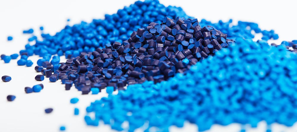

Rigid plastic materials:
ABS (acrylonitrile butadiene styrene): High-strength general-purpose engineering plastic, used for many commercial products.
  • ASA (acrylonitrile styrene acrylate): A material very similar to ABS with higher resistance to fading and better suited for outdoor use.
  • CA (cellulose acetate): Typically used in eyeglasses and film, CA is a flexible clear material that can be used in food contact.
  • HDPE (high-density polyethylene): Excellent strength-to-weight ratio and chemical resistance. It is often used for fuel tanks, connector insulators, and food containers. HDPE is also used in outdoor equipment like playgrounds.
  • LCP (liquid crystal polymer): LCP has mechanics even at elevated temperatures as well as low dielectric constants. This material provides exceptional features for micromolding and thin walled components. LCP is popular for electrical connectors and interconnects as well as medical devices.
  • LDPE (low-density polyethylene): A flexible and tough material with lower density versus HDPE. LDPE does not react to acids, bases, or alcohols. Useful for trays, snap lids, and general-purpose containers.
  • PA 6 (polyamide 6, nylon 6): Offers increased mechanical strength, rigidity, good stability under heat, and/or chemical resistance.
  • PA 6/6 (polyamide 6/6, nylon 6/6): Offers increased mechanical strength, rigidity, good stability under heat, and/or chemical resistance.
  • PARA (polyarylamide): Often combined with infills such as glass or mineral fibers, PARA creates very rigid parts with low creep and a slower rate of water absorption compared to nylon (PA). PARA is great for structural components in handheld electronics as well as medical devices.
  • PBT (polybutylene terephthalate, Valox): A common electronic insulator with a polyester base. Highly used in automotive as a longer-wear alternative to nylon.
  • PBT-PET (polybutylene terephthalate-polyethylene terephthalate): A compounded blend of PBT and PET.
  • PC (polycarbonate): A clear or colored, lightweight, glass-like plastic that is heavily used across multiple industries. PC is impact resistant, holds great feature detail, and can be used for safety equipment, lenses, electronic devices, and much more.
  • PC-ABS (polycarbonate-acrylonitrile butadiene styrene): The best of both PC and ABS. Higher-strength engineering thermoplastic with slightly more flexibility than standard polycarbonate.
  • PC-PBT (polycarbonate-polybutylene terephthalate, Xenoy): A tough and rigid material resistant to lubricants, solvents, and cleaning agents. Very common in electronic enclosures.
  • PC-PET (polycarbonate-polyethylene terephthalate): A blend of PC and PET provides tough and chemically resistant results and can be used as an alternate to PC-ABS. It endures harsh solvents and cleaners, making it excellent for sports equipment and healthcare applications.
  • PCT (polycyclohexylenedimethylene terephthalate): A thermoplastic polyester that typically outperforms PET due to lower moisture absorption and better environmental stability. PCT is often used for connectors and switches.
  • PE (polyethylene): One of the most common plastics used in the world, PE has high ductility, abrasion resistance, and chemical resistance. PE is often described by its molecular weight, such as UHMW PE (ultra-high molecular weight), LDPE (low density), or HDPE (high density). PE is used in packaging, tubing, films, bottles, and more.
  • PEEK (polyether ether ketone): Offering excellent tensile strength that surpasses most plastics, PEEK is often used as a lightweight substitute for metal parts in high-temperature, high-stress applications. PEEK resists chemicals, wear, and moisture.
  • PEI (polyetherimide, Ultem): Known best for its extremely high heat and flame resistance, PEI is used for many medical applications and is more affordable than PEEK.
  • PE-PP (polyethylene-polypropylene): A resin blend of the polyolefin’s polypropylene and polyethylene.
  • PE-PS (polyethylene-polystyrene): A resin blend of the polyethylene and polystyrene.
  • PES (polyethersulfone): A rigid, transparent plastic that is chemically inert, biocompatible, and sterilizable. PES is suitable for food-contact devices such as coffee machine components as well as aerospace and automotive where chemical exposure is high.
  • PET (polyethylene terephthalate, Rynite): Also abbreviated PETE, this is a clear, strong, and lightweight PE resin heavily used in food packaging, soda bottles, jars, and more. The material is food-safe. PET is recyclable with a resin code of 1.
  • PLA (polylactic acid): A biodegradable and renewable plastic. PLA has a relatively low glass transition temperature and is common in short-use applications.
  • PMMA (polymethyl methacrylate, acrylic): A clear glass-like plastic. Good wear and tear properties. Great for outdoor use.
  • POM (acetal polyoxymethylene, Delrin): Good moisture resistance, high wear-resistance, and low friction.
  • PP (polypropylene): Polypropylene has excellent electrical properties and little or no moisture absorption. It carries light loads for a long period in varying temperatures. It can be molded into parts requiring chemical or corrosion resistance.
  • PPA (polyphthalamide): A subset of nylons (polyamide) that typically exhibit a higher melting point and lower moisture absorption. PPA is typically used in automotive and industrial applications due to its ability to withstand harsh chemicals. PPA is good for fuel and fluid manifolds and headlight housings.
  • PPS (polyphenylene sulfide, Ryton): A high-performance thermoplastic with extreme resistance to solvents.
  • PS (polystyrene): A clear, hard, and brittle material widely used for food packaging, clamshell containers, and even disposable cutlery.
  • PS-PPE (polystyrene-polyphenyl ethers, Noryl): Exhibiting high heat and flame resistance, PPE-PS has high stiffness and tensile strength even at elevated temperatures.
  • PSU (polysulfone, Udel): A rigid, stiff, and transparent plastic which is a higher-performance alternative to polycarbonate.
  • PVC (polyvinyl chloride (Shore D)): A rigid, general-use plastic that is common in plumbing, non-food packaging, and trimming.
  • PVDF (polyvinylidene fluoride, Kynar): A chemically inert, high-temperature material. Due to its low friction, PVDF is used in plumbing parts, bearings, chemical handling, electrical wire insulation, and tubing.
  • SAN (styrene acrylonitrile): A polystyrene that is heat resistant and transparent. Due to its relationship with polystyrene, SAN is low cost and has enhanced clarity and shine. SAN is common in household goods, door handles, and kitchenware.
  • TPO (thermoplastic polyolefin): A flexible plastic with good chemical resistance but lower temperature resistance compared to PP.
  • TPU (thermoplastic polyurethane (Shore D)): A tough, highly abrasion-resistant resin that bridges the gap between rubbers and plastics. TPUs can be formulated to be rigid or elastomeric. TPU exhibits a high flex before break and is ideal for wheels and door panels.
Elastomer/Rubber molded materials:
Manufacturing elastomeric parts can be accomplished through injection molding, transfer molding, or compression molding. When getting a quote through Xometry, our team can help you decide the best method depending on the part geometry, estimated annual volume, and the type of material required.
  • EPDM (ethylene propylene diene monomer rubber): One of the highest performing rubber elastomers with high heat resistance, chemical resistance, and moisture sealing properties. EPDM is commonly found in automotive seals, gaskets, O-rings, and electrical insulators.
  • FKM (fluoroelastomer / Viton): A premium high-performance elastomer renowned for its exceptional resistance to extreme heat, aggressive fuels, and oils. FKM is frequently utilized in demanding environments such as automotive fuel systems, chemical processing seals, aerospace components, and high-temperature gaskets.
  • PEBA (polyether block amide): A soft, flexible, plastic or elastomer used for medical devices such as catheters. PEBA foams are used for padding, shoe insoles, and sports equipment. PEBA is resistant to moisture and UV exposure.
  • PVC (polyvinyl chloride (Shore A)): A rubber-like, general use elastomer, that is common in outdoor products, protective films, and mats. Shore A rubber-like PVC requires plasticizers to improve its flexibility from its typical rigid state. PVC is flame retardant due to its self-extinguishing properties.
  • TPE (thermoplastic elastomer): A broad class of elastomers that behave like a thermoset with high flex and elasticity but process like a thermoplastic through molding. TPE is an umbrella term for many unique elastomer classes.
  • TPU (thermoplastic polyurethane (Shore A)): A tough, highly abrasion-resistant elastomer that bridges the gap between rubbers and plastics. TPUs can be formulated to be rigid or elastomeric. TPU exhibits a high flex before break and is ideal for flexible tires, skateboard wheels, and weatherproof gaskets.
  • TPV (thermoplastics elastomer, vulcanized rubber (Santoprene)): An excellent elastomer with high versatility due to temperature resistance, compression, and elasticity.
  • LSR (liquid silicone rubber): Offering food and biocompatibility, extreme heat resistance, and excellent flexibility, silicones are a versatile rubber material. LSR is used for medical devices and automotive, aerospace, and consumer products. Liquid silicone rubber molding is a specialized process different from traditional injection molding (more on this below).
