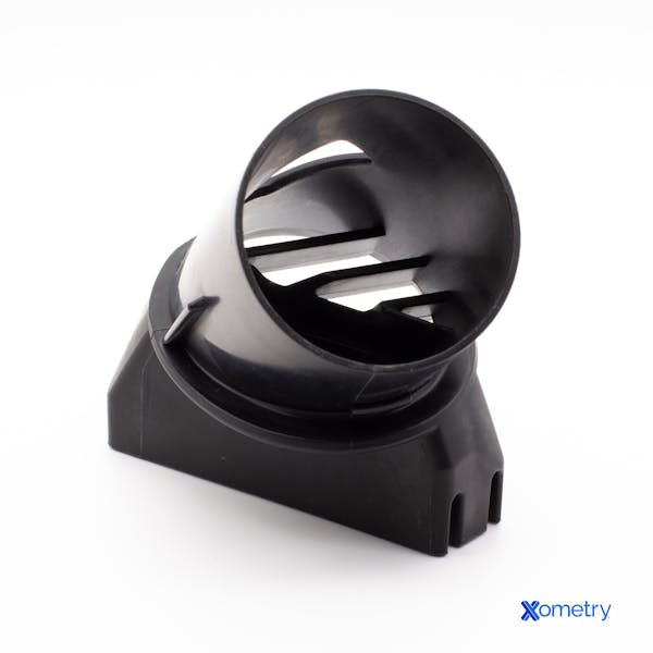

2. Injection Molding
Injection molding is the commonly applied manufacturing process for the production of the majority of plastic products. This includes small and simple components like plastic washers and large and complex parts such as entire car dashboards and bumpers.
Once a part design is finalized, an openable steel (occasionally aluminum) cavity is manufactured. It consists of two halves, referred to as the cavity and the core, which are close to forming the shape of the component. Thermoplastic material is heated to a molten state and then injected into the mold cavity under high pressure. The molten material fills the cavity and cools in place to solidify. The cavity tool is opened, and the finished part is ejected.
Injection molding is best suited to high-volume production, as the cost of tooling is very high relative to the typical value of a one-off plastic part. However, some applications demand prototypes that are closer to real production. Consequently, there is an active market in supply of very low volume injection-molded tools/parts, using a simplified process with typically low cost and very limited service prototype tools. Injection molding is very different from 3D printing, and it is unusual to see true early-stage prototype parts made in that way, as the cost is very high.

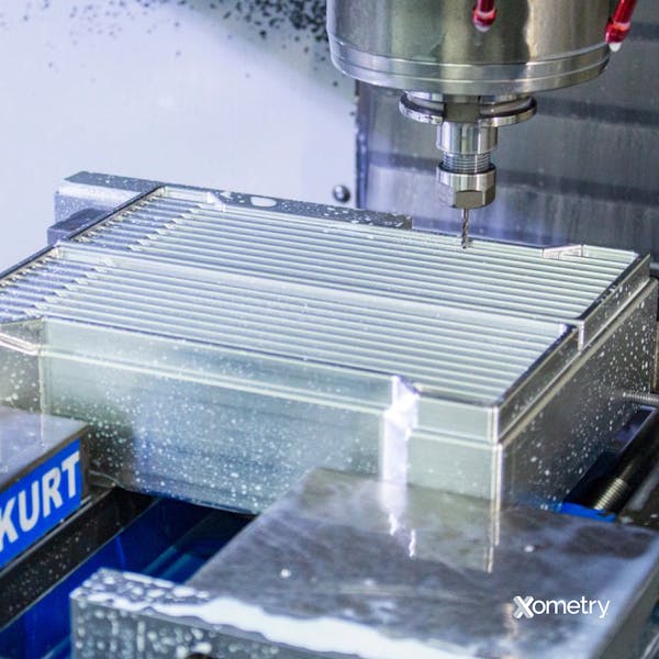

4. CNC Machining
Computer numerical control (CNC) machining is a subtractive manufacturing process used to produce high-quality, precision parts with tight tolerances and complex geometries. A wide variety of metal, plastic, and natural materials are typically used.
CAD models are translated into machine-readable instructions using computer-aided manufacturing (CAM) software. This process creates a tool path and specifies cutter diameters and operational parameters for feed rate, cut depth, and spindle speed. The most basic CNC machines operate by moving the workpiece in three axes relative to a rotating cutter. More-complex machines also integrate cutter-alignment movements such as tilting the rotational axis. The more sophisticated end of the market can move the cutter and the workpiece in multiple axes to a maximum of 12 distinct motion classes (so far embodied in available machines).
CNC machining of various complexity and adaptability is widely available as a prototype, low-volume, and mass-production process for making simple and complex parts ranging from a custom washer to a gas-turbine combustion chamber. Virtually all product areas can and do exploit CNC machining.
Virtually any material available for mass production can be worked by CNC machining, so plastic parts can represent mass-production components more closely than most 3D printing processes can deliver. Throughput can be considerably faster than 3D printing for relatively simple parts, though production times can approach the same level for both options as part complexity rises. CNC machines of very large format are widely available, whereas 3D printing processes are generally quite limited in build envelope dimensions. “Height” in 3D printing requires a considerable increase in process times, whereas CNC machines can rapidly traverse the Z-axis to deliver taller parts faster. While metal 3D printing processes are rapidly evolving, CNC machining of metal parts retains some distinct advantages in precision and surface finish. Z resolutions in metal 3D printing are generally 0.2 mm at best, whereas CNC can operate at a better tolerance than 0.05 mm if slower processing and shallower cuts can be accepted.
