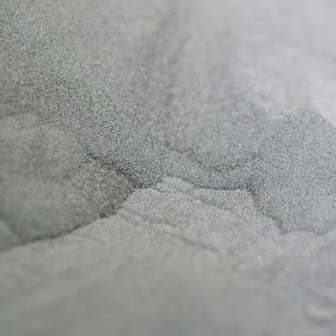

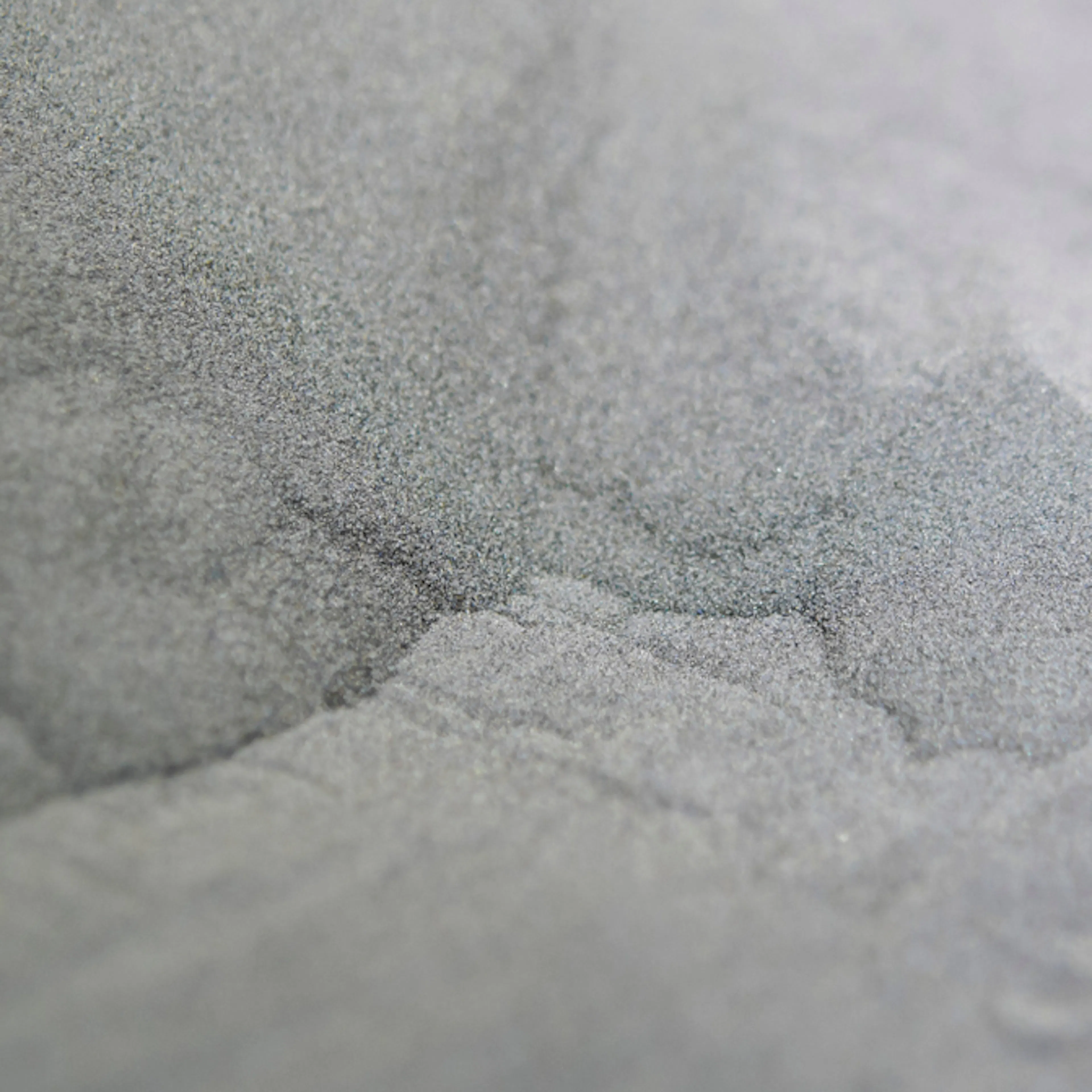

Binder jetting metal powder. Image Credit: Shutterstock.com/MarinaGrigorivna

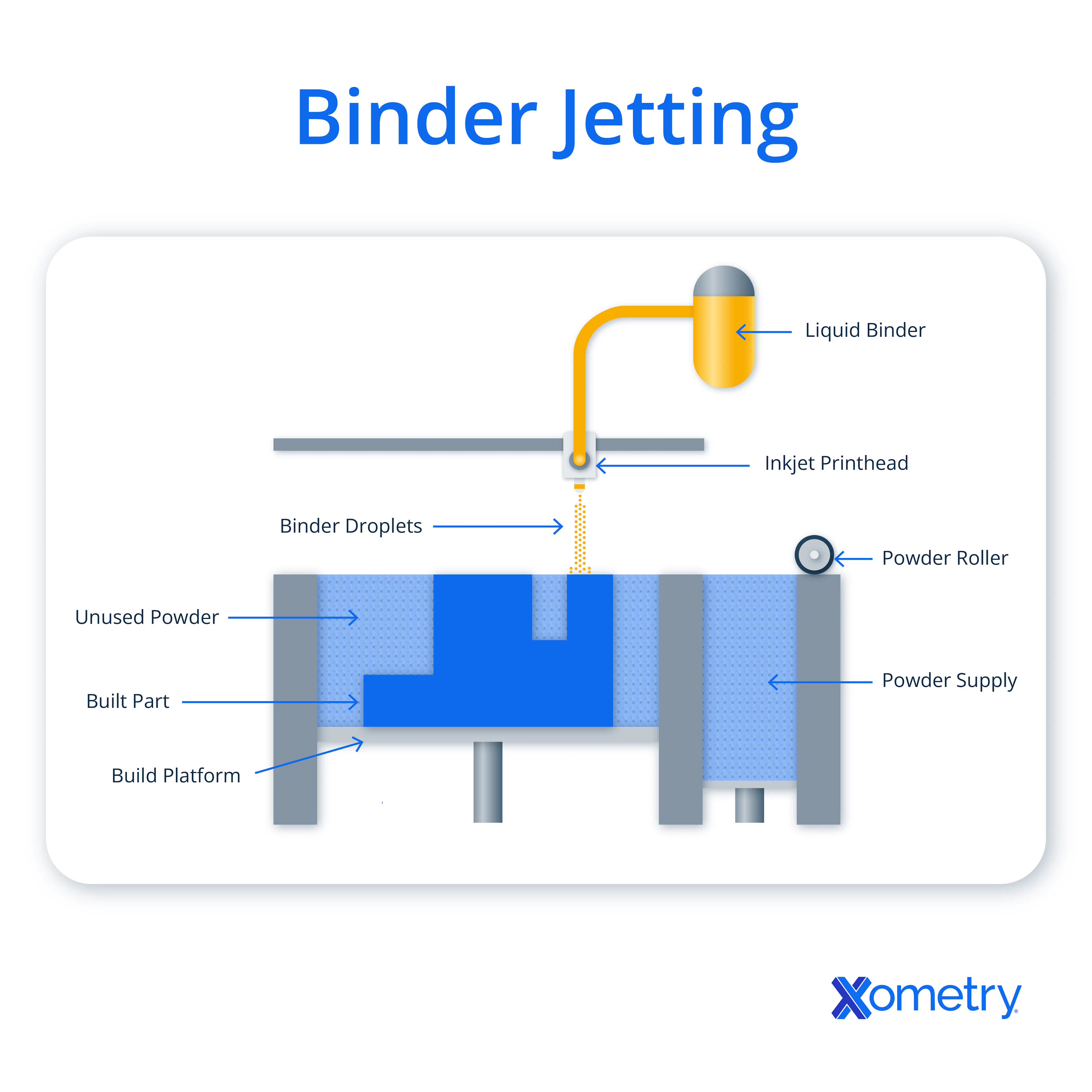

Binder jetting is an additive manufacturing process in which a powdered material, typically metal, sand, plaster, or ceramic, is deposited layer by layer. A liquid binding agent, usually a polymer, is selectively deposited onto the powder bed to adhere particles together. This process creates each slice of the 3D model by solidifying the binder upon contact or through a post-curing step.
The binder is applied using inkjet-style heads, such as piezoelectric or thermal (bubble jet) nozzles. Once deposited, the binder causes the particles in that layer to bond to each other and the previously printed layer. The unbound powder remains loose, serving as a natural support structure during the build. At the edges of the printed area, capillary action causes the binder to bleed slightly into the surrounding powder, which can reduce resolution and edge definition—especially in fine powder applications. This bleed zone is one of the primary limitations for achieving high-resolution features.
Some binder jetting systems incorporate an additional print stage to deposit full-color pigments, enabling the creation of detailed, multi-colored prototypes. These colors are embedded within the part and can withstand post-processing steps such as infiltration, sanding, or sealing.
To learn more, see our guide on Binder Jetting.
An illustration of binder jetting.

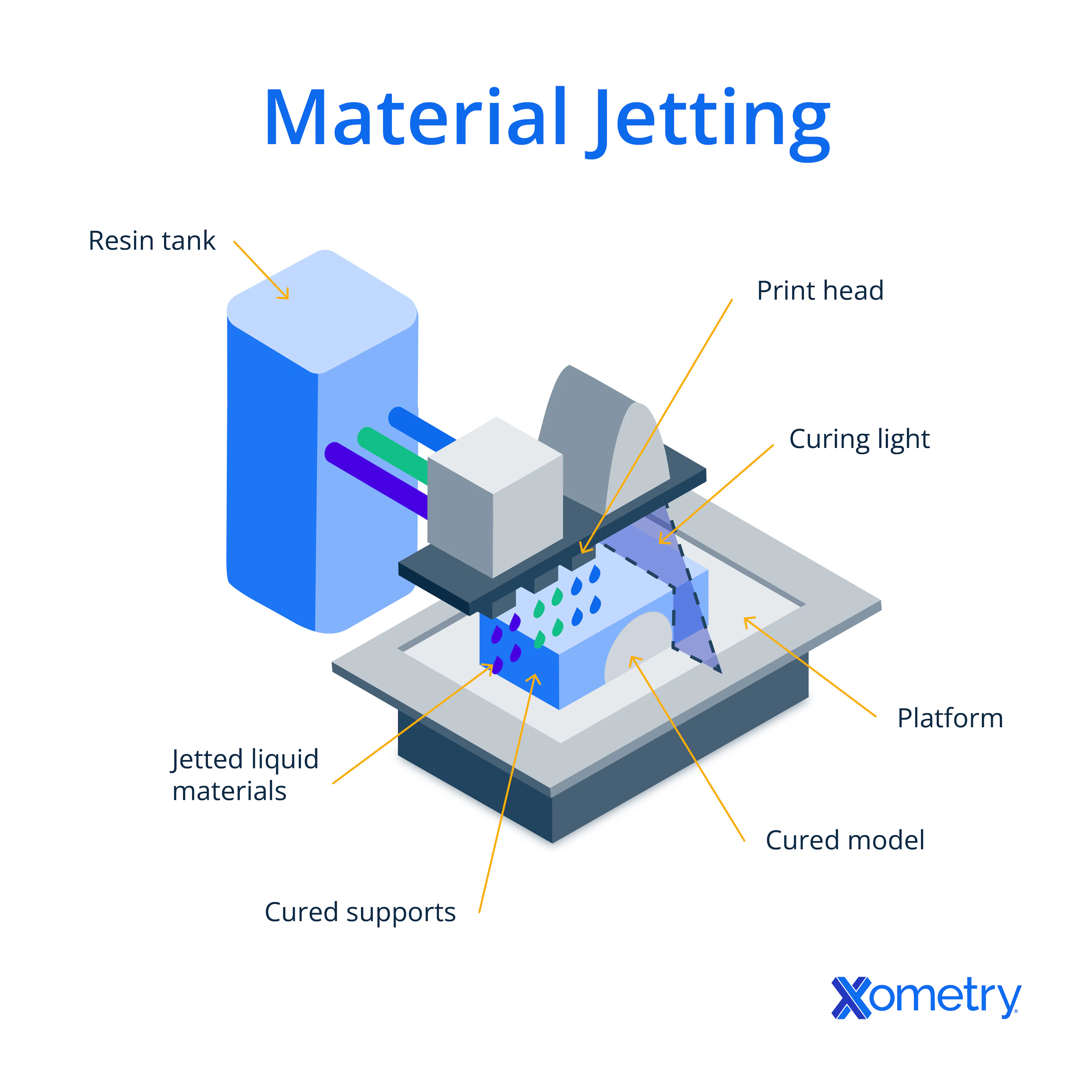

Material jetting is a 3D printing technology that uses inkjet or bubble-jet printing methods to deliver liquid photopolymer or wax build and support materials directly onto a build platform. The printed material is either partially or fully cured in the print process before the table lowers and the next slice of the model is applied.
The print process generally applies two (or more) related materials in the layer construction. Build materials are typically heat-cured or UV-light-cured polymers that can be rigid, semi-flexible, or pseudo-elastomers. Some variants of the process use wax as the build material, allowing direct production of investment casting masters of the highest quality without the need for skilled craftsmanship. Support material is co-printed by additional printer heads. Such support material will be either chemically soluble or a water-soluble version of the build material that couples fully to the model but can be later removed. Advanced systems may allow mixing or alternating different build materials during printing. This enables property gradation, where the mechanical characteristics of a part vary by region (e.g., from soft to rigid) and material switching, to change functional behavior within the same part geometry.
To learn more, see our guide on Material Jetting.
An illustration of material jetting.
