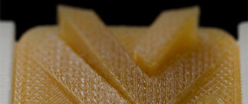

FDM Definition and Comparison to PolyJet
FDM technology was first created in 1988 by Scott Crump. The process works by melting a plastic filament in the print head. The temperature is controlled so that it delivers plastic in a gel state that has enough energy to fuse, but not enough to flow. The printing head translates in the X-Y plane and extrudes this gel as a continuous strand. The strands fuse together, but even the best printers cannot prevent porosity or make the material homogeneous.
FDM prints successive 2D slices of a model to build a solid 3D representation of the file. The nozzle moves horizontally to pack strands neatly against the layer below. FDM offers two major advantages over PolyJet: material and machine costs. FDM material generally costs 1/10 as much per kilogram as PolyJet resin. The machines are also three to five times cheaper.
To learn more, see our article on the FDM Printing Process.
FDM Ultem
FDM Ultem

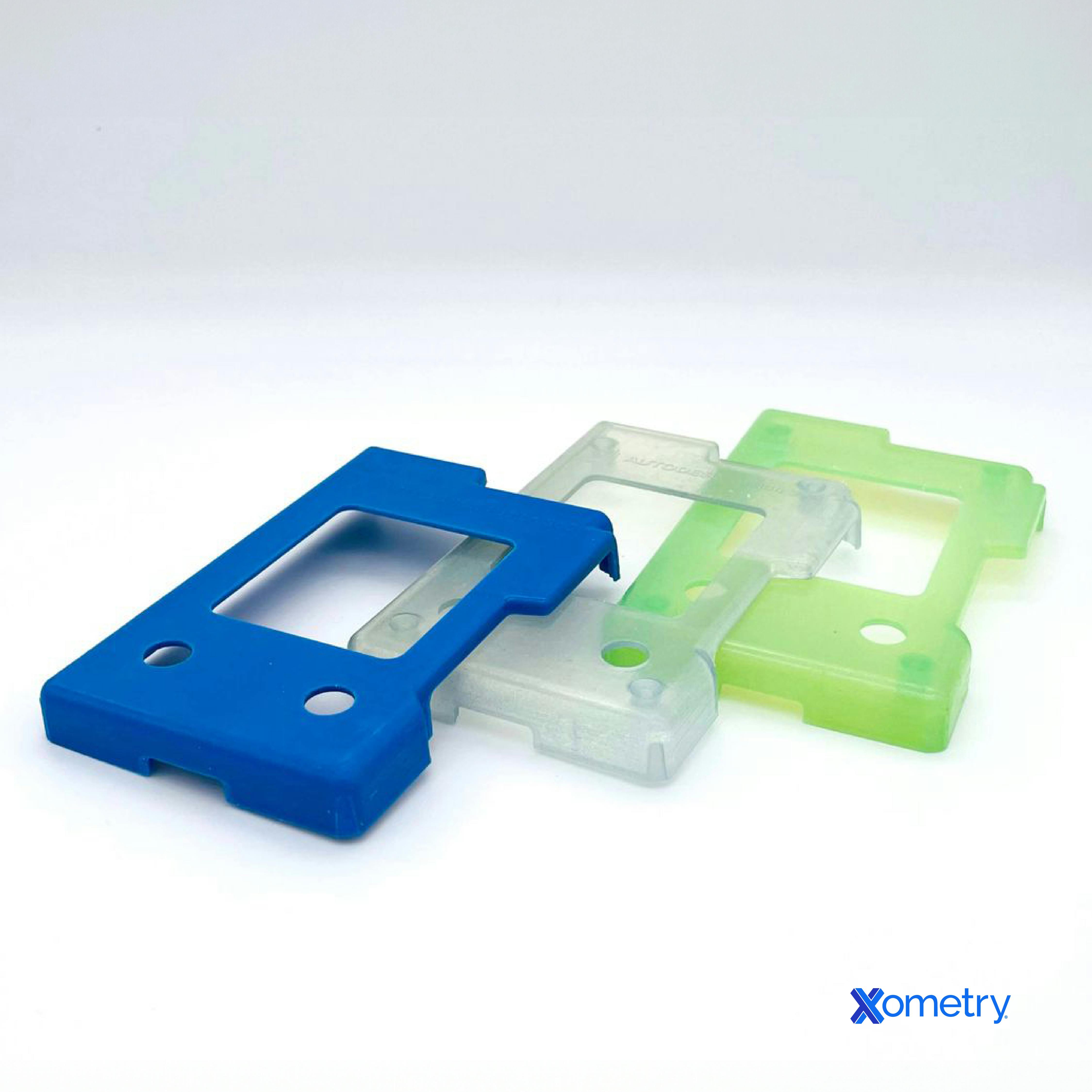

PolyJet Definition and Comparison to FDM
PolyJet modeling was developed in 1998 by Objet Geometries. The process makes a plastic 3D representation of a computer model by printing a layer of liquid photopolymer with an inkjet dispenser and curing the liquid during each print head pass. The inkjet process allows high resolution. Because each dot of liquid is small, PolyJet resolves fine details well. PolyJet can apply multiple resins in one pass. It can alter overall properties by proportioning rubber and rigid resin and can ‘overmold’ parts onto rigid structures all in one build.
Compared to FDM, PolyJet can print parts with smoother surfaces. It is also capable of printing fine details.
To learn more, see our guide on What is PolyJet.
polyjet prototype
PolyJet prototype
