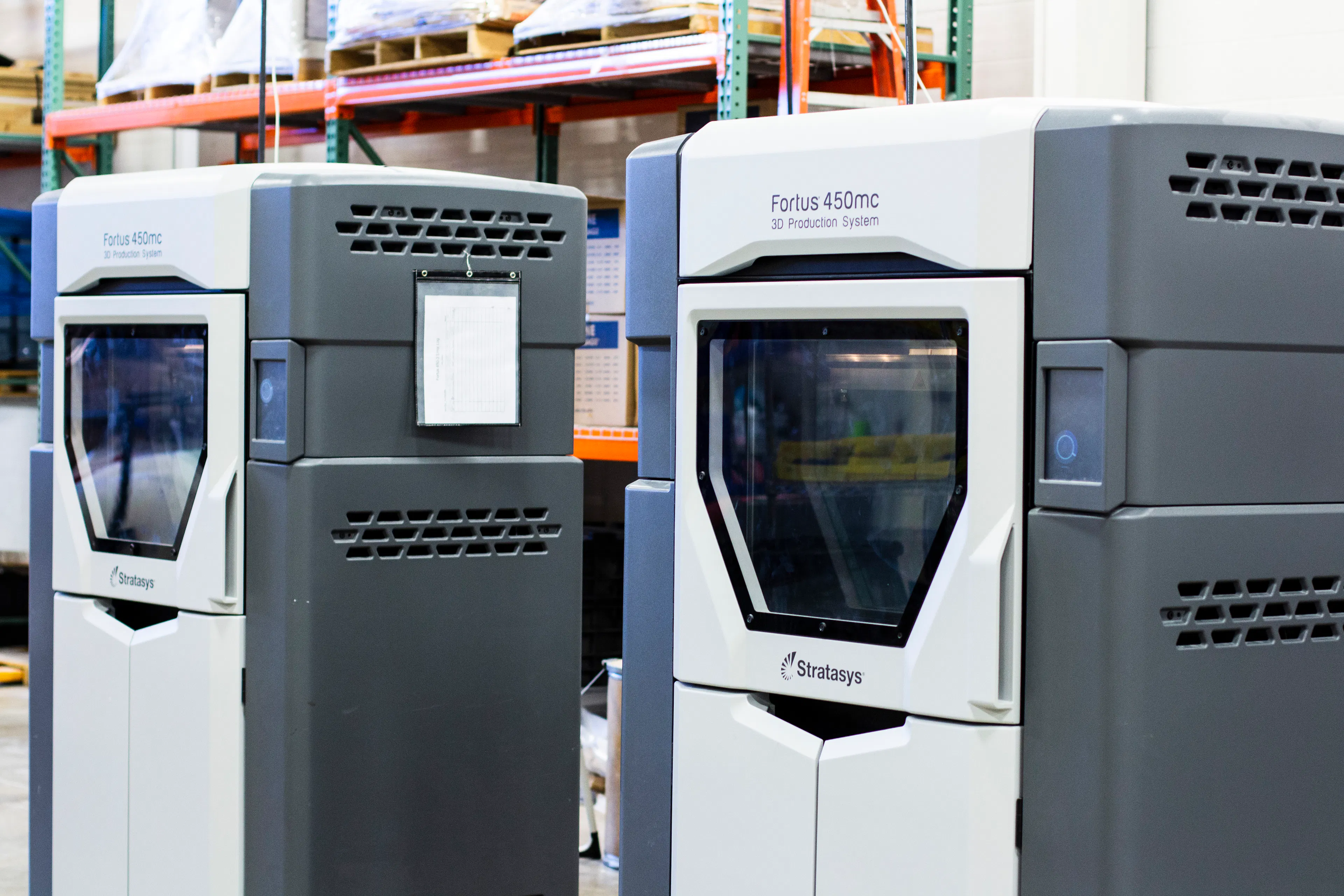

Like SLS, FDM uses thermoplastics, but in the form of a filament that’s poured out onto the print bed through a hot nozzle. When each layer is printed and cooled down, the nozzle gets started on the next, until eventually the part is complete. FDM is way cheaper than SLS and is the perfect starting point, even for hobbyists. To learn more, head on over to our article on What is FDM printing. This is one of our industrial FDM 3D printers here at Xometry:
Industrial FDM 3D printers at Xometry
FDM printers are generally easy to use, which is why many hobbyists love using them as a starting point. You can even get hold of rather large FDM machines, which allow you to print parts up to a few feet wide. On the flip side, though, they don’t have as high a print resolution as SLS printers do, so don’t expect perfection on small or detailed parts. They can also be quite slow, and the prints will require support structures during printing. Matthew Schmidt, a Senior Solutions Engineer here at Xometry, says, "SLS and FDM process are common in the respect that they both utilize real thermoplastic feedstock, however, the deposition process is much different. Selective Laser Sintering (SLS) provides a more dense, homogenous and isotropic part due to its laser melting process, but only from a limited number of Nylon derived materials. FDM on the other hand has a less dense, but unique contour and raster extrusion deposition process that can accommodate many different thermoplastics in different colors."
