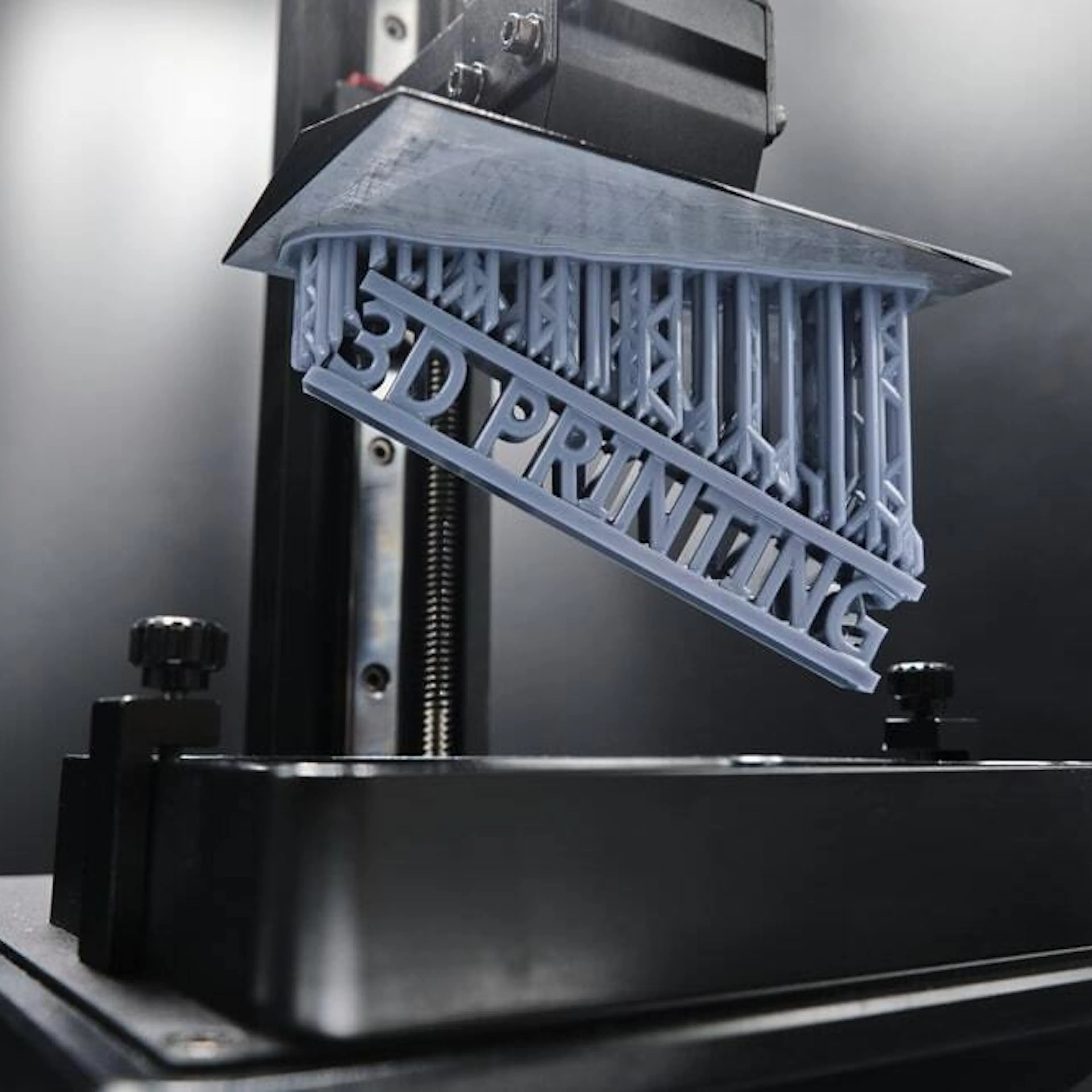

MSLA, short for masked stereolithography apparatus, is an enhanced form of SLA (stereolithography) 3D printing that matches an LCD screen with a powerful LED light source to selectively cure photosensitive resin. When successive layers are cured upon the previous ones, they form a three-dimensional object. An LED array is used as the light source and is projected through an LCD screen which acts as a reconfigurable mask.

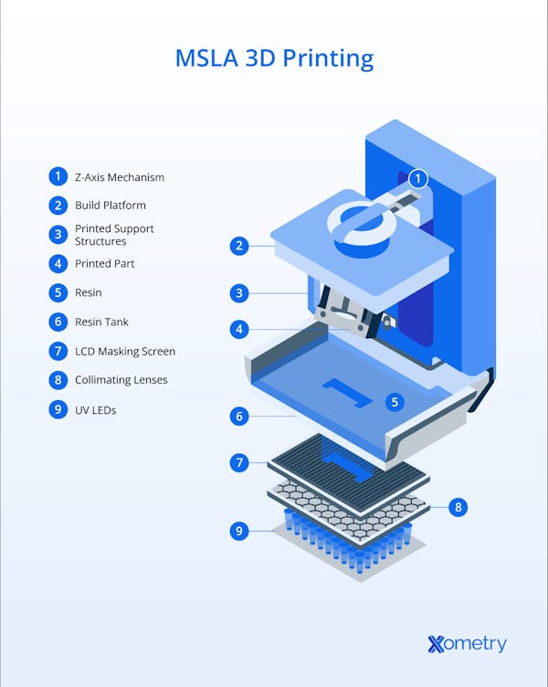

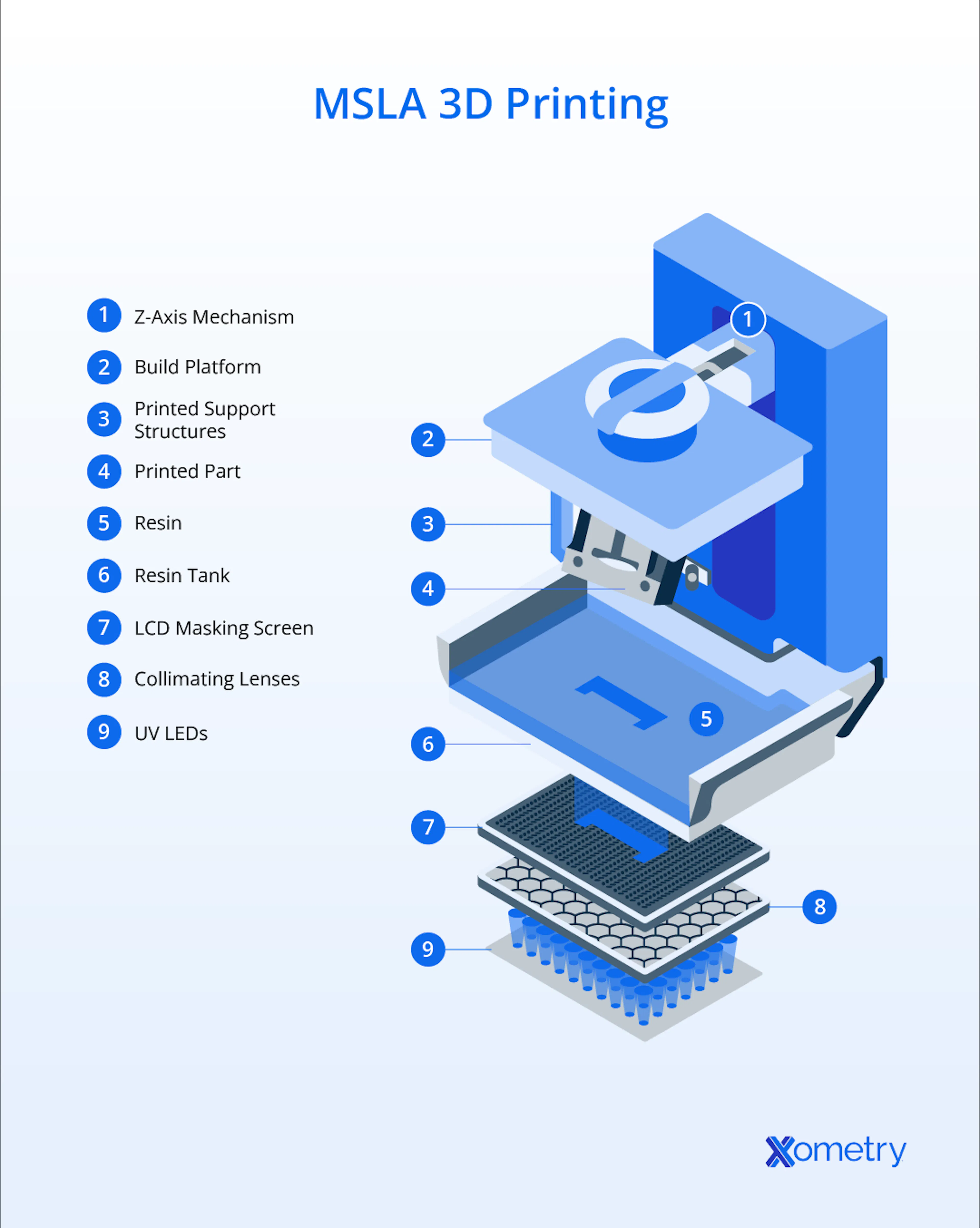

MSLA 3D printing works by placing a photosensitive resin above the LCD and LED array separated by a thin layer of fluorinated ethylene propylene (FEP) plastic. The function of the LCD is to control where light can shine through and impact the resin above. The LCD is made up of individual pixels that allow light to pass through when off and prevent the passage of light when on. This arrangement of pixels matches the shape of each desired layer. The light passes through the LCD, allowing parts of the resin between the build platform and FEP sheet to cure. The build platform then lifts and positions itself for the next layer. Just like other 3D printing methods, the process continues one layer at a time until the part is complete.

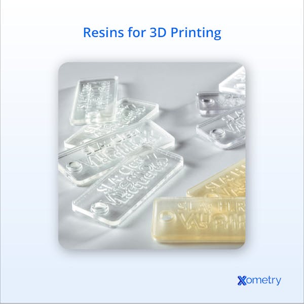

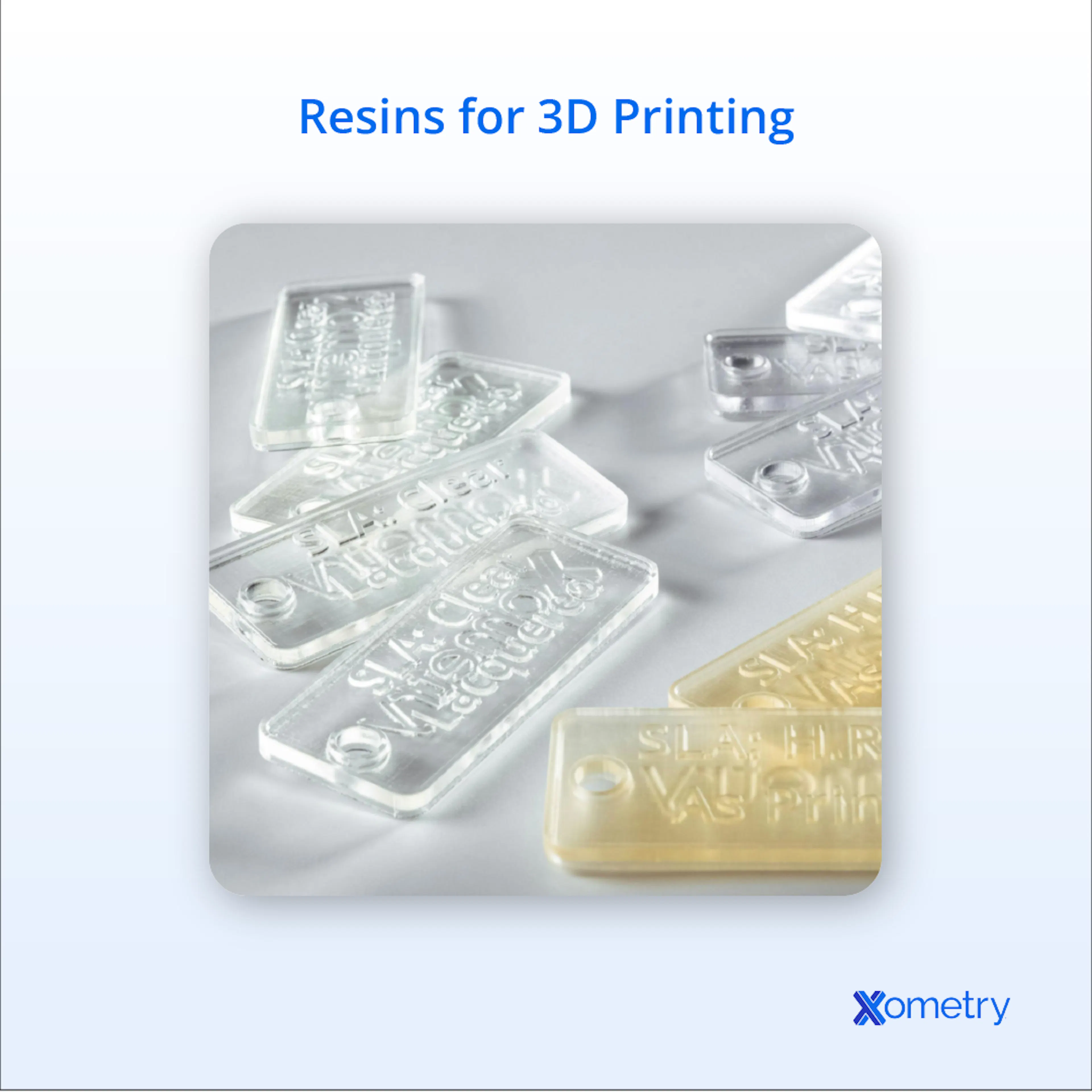

What is the Material Used in MSLA 3D Printing?
The MSL 3D printing process uses unique photopolymer resins that harden (cure) under UV light. The majority of 3D printing resins are either acrylate- or epoxy-based, with the latter being more common in desktop printers. Most resins fall into one of the following categories:
  1. Standard Resin: Standard resins work well for printing with great resolution and rigidity. They are best for prototyping.
  2. Tough Resin: Tough resins are comparable to ABS thermoplastic. They were developed to give printed parts good impact resistance.
  3. Clear Resin: Clear resins have mechanical qualities comparable to those of standard resin. The difference is that, with a little post-processing, they can be made optically transparent.
  4. Durable Resin: Durable resin has similar mechanical properties to polypropylene (PP). It is a flexible and wear-resistant material, particularly useful when prototyping consumer products such as ball joints and snap fits.
