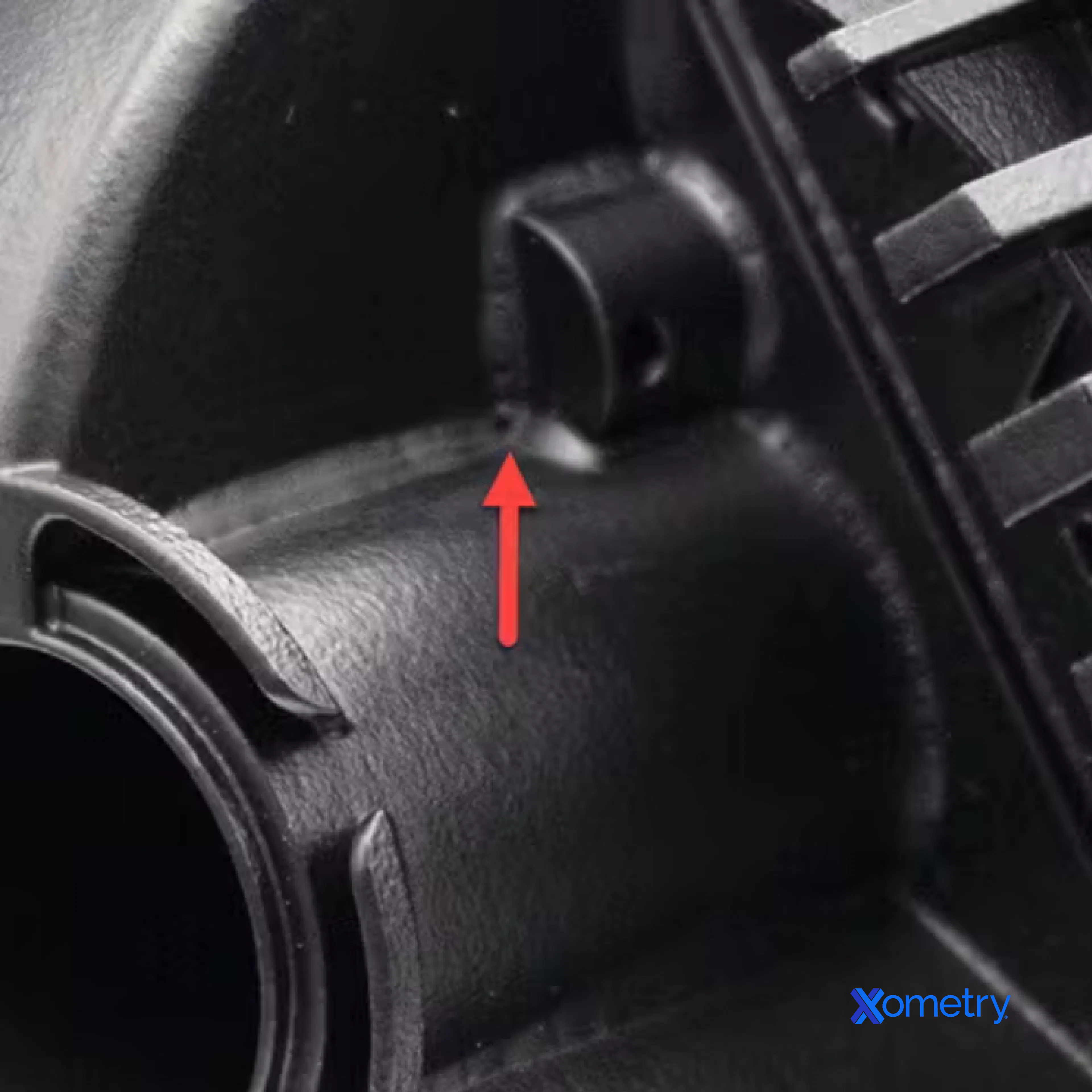

Bridging
The surface of a part may bubble during the liquefaction stage of the vapor smoothing process. The bubbling surface may cause the material to form a thin shell that connects between features like small gaps or walls of sharp corners. In some cases, a razor can be used on the bridging shells to free up the affected elements.
Design Tip:
Bridging can be mitigated by increasing the distance between gaps and adding ample radii to sharp internal corners.

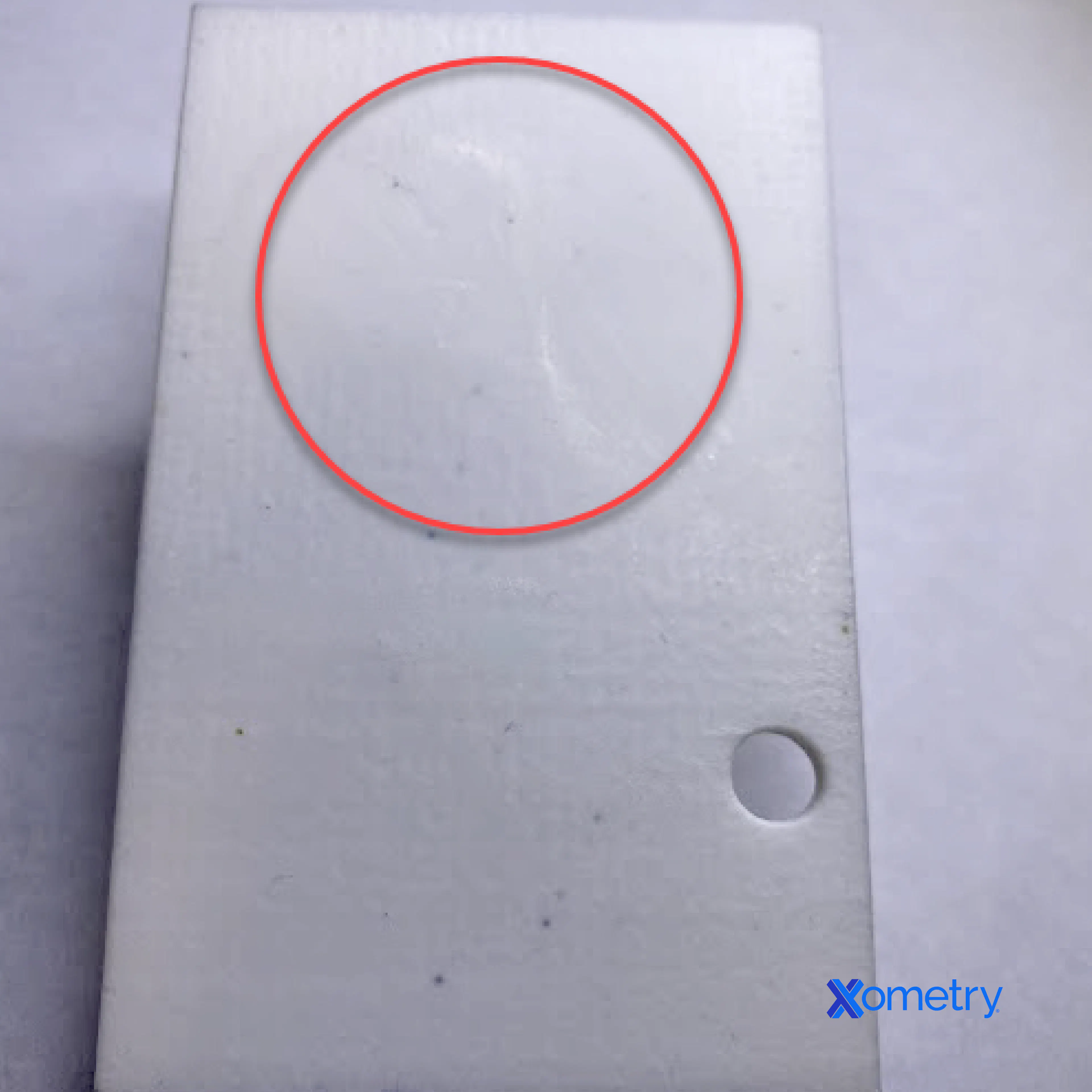

Bubbles / Blistering
Similar to bridging, blistering results from the surface bubbling during the liquefaction stage. Sometimes larger bubbles can form and remain in place while the solvent evacuation process is underway. After this, the bubble may harden and leave a blister-like appearance. Typically these are found on broad flat surfaces and sharp internal crevices.
Design Tip:
Avoid broad flat surfaces; organically shaped surfaces are less likely to blister. Adding radii on internal corners will also help mitigate bubbling and other defects.

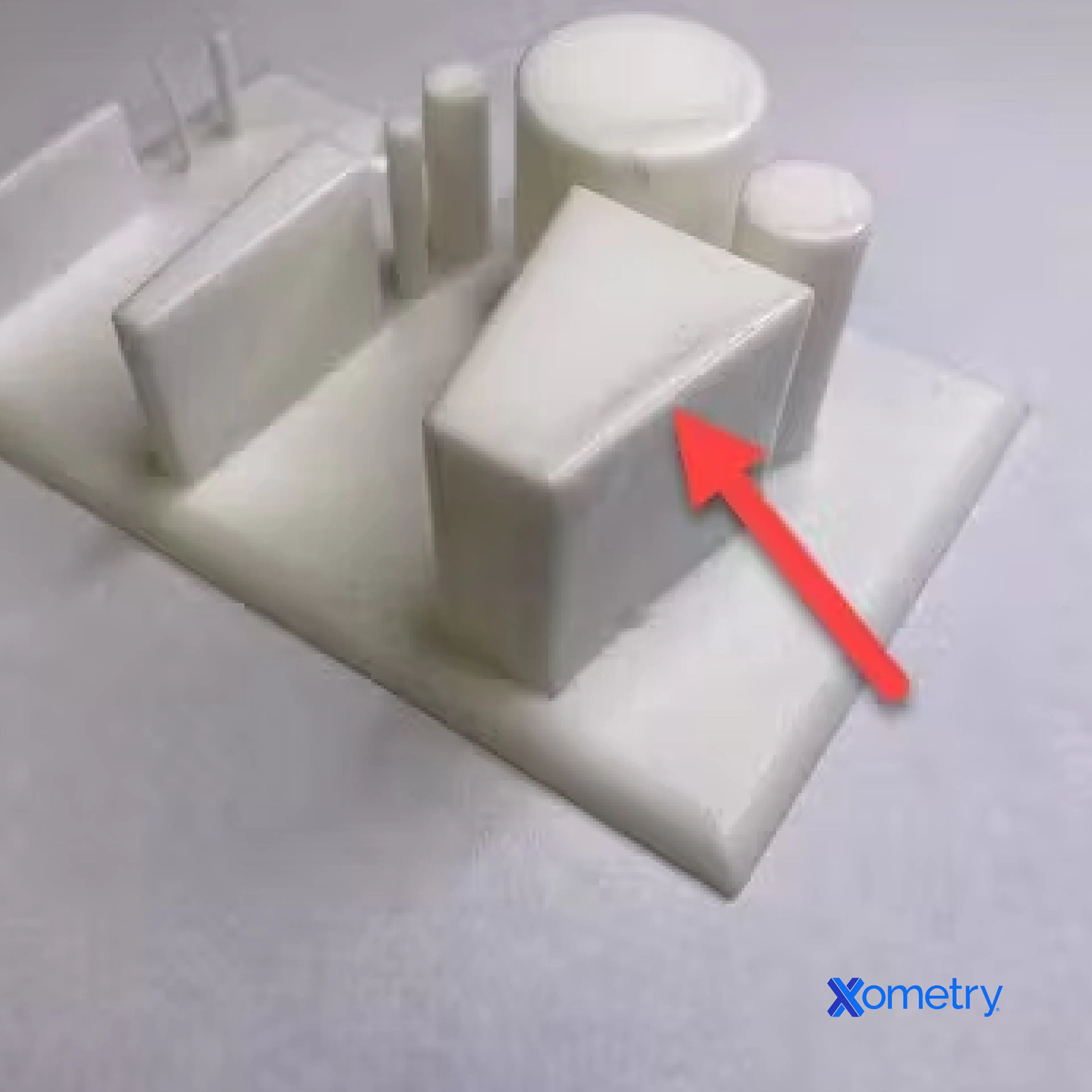

Edge Pooling
Abrupt turns on flat parts' sides may result in a visible bump around the edge. Bumps are caused by the liquified material moving with gravity to the edge and solidifying in place. Edge rounding and pooling can affect feature tolerances.
Design Tip:
Radii on sharp edges of flat-sided features will help mitigate the pooling of the liquified material.

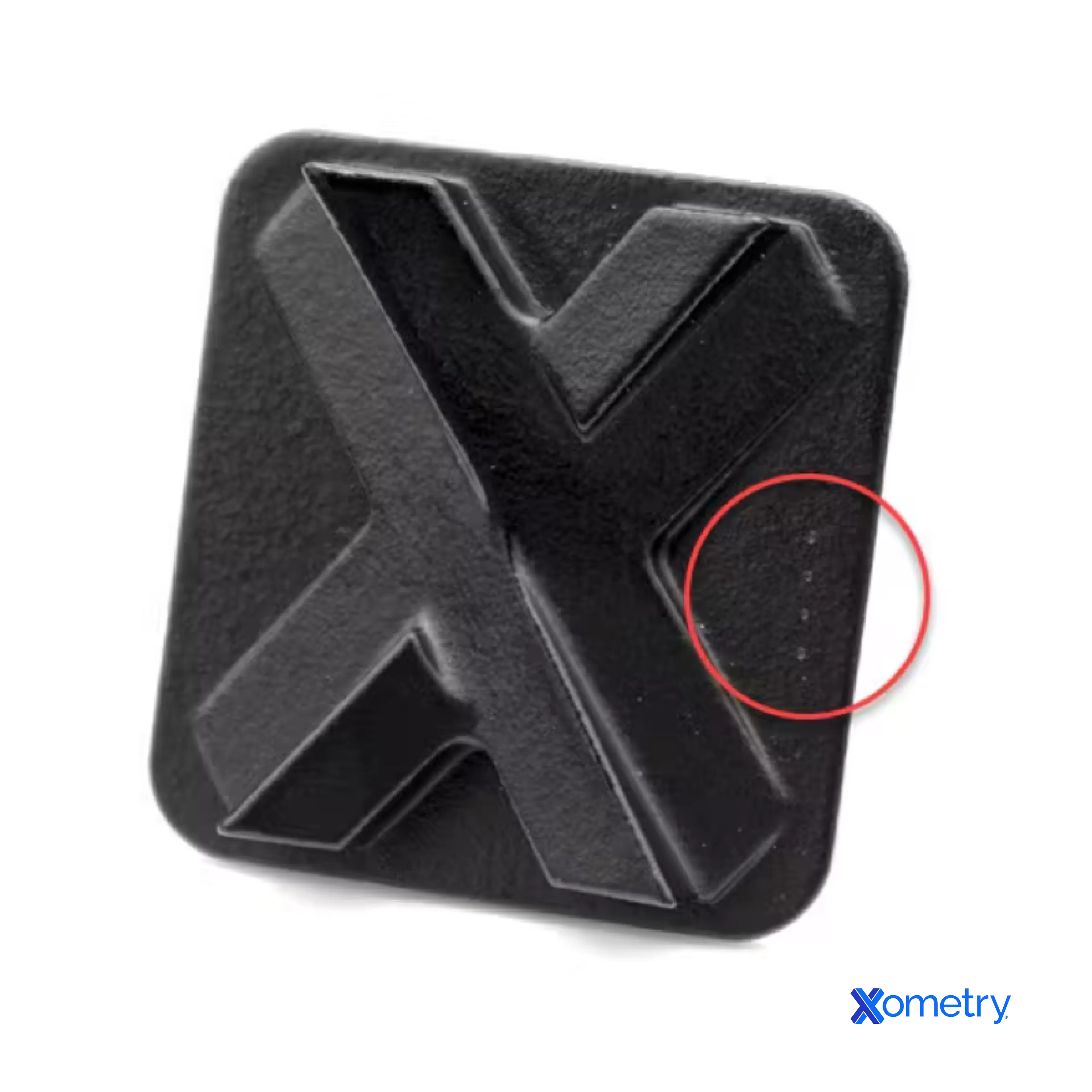

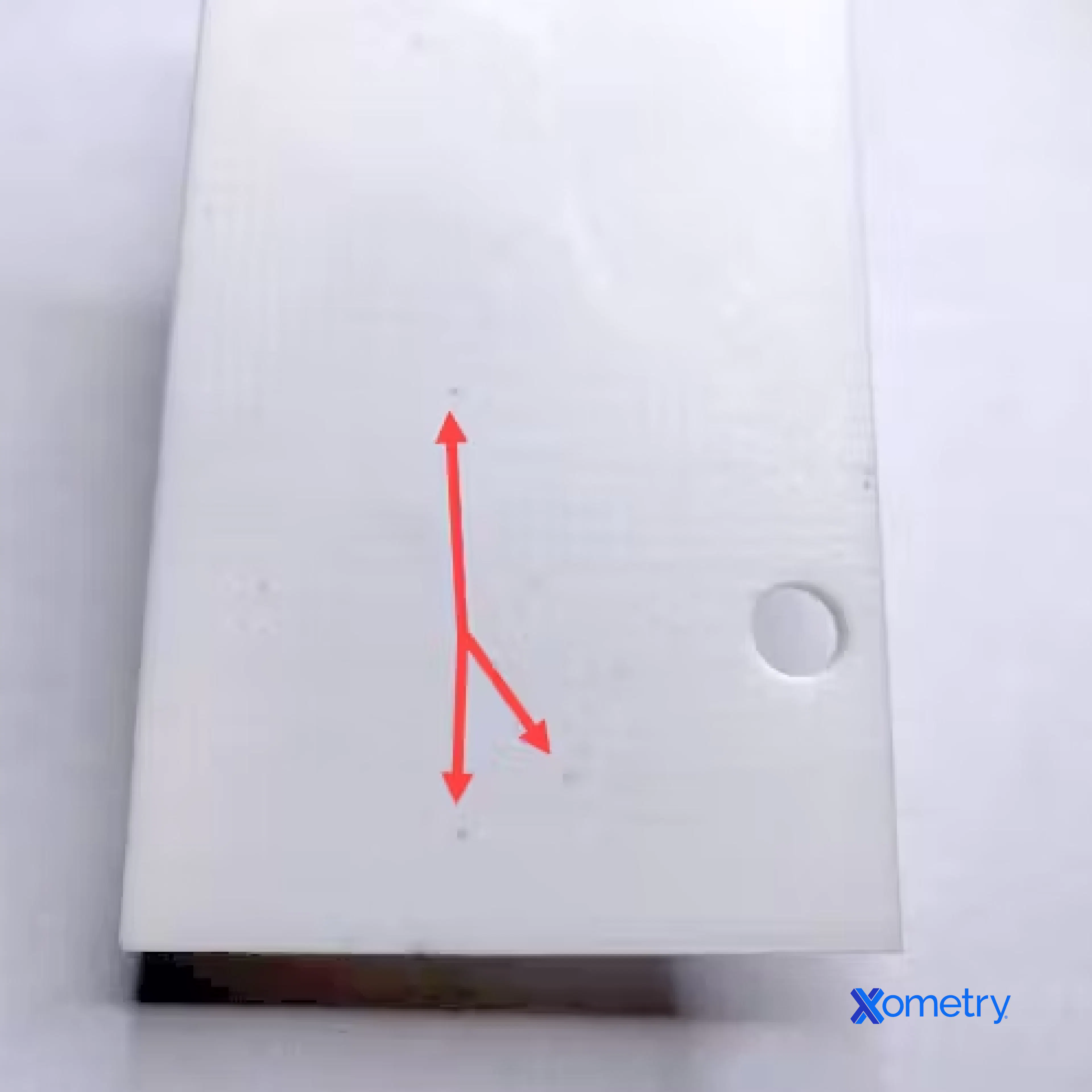

Speckling
Tiny dots of dark stain can appear on the surface of lightly colored materials after going through the process. We refer to this as speckling. Speckles are typically more noticeable on natural finishes and on surfaces dyed lighter colors such as yellow or red.
Design Tip:
Dying or selecting materials of darker colors, such as black, green, or blue, will reduce the visibility of speckling.
