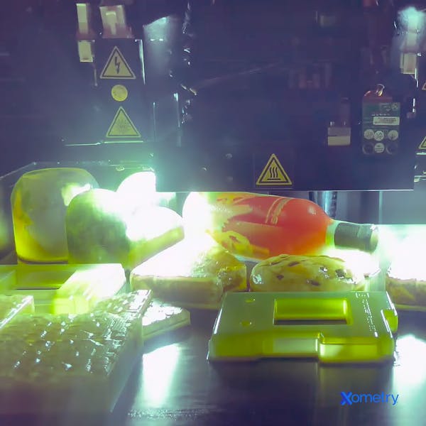

The photo below shows one of our PolyJet printers creating full-color parts:
PolyJet 3D printer at Xometry
Xometry's PolyJet 3D printer creating multi-color parts.

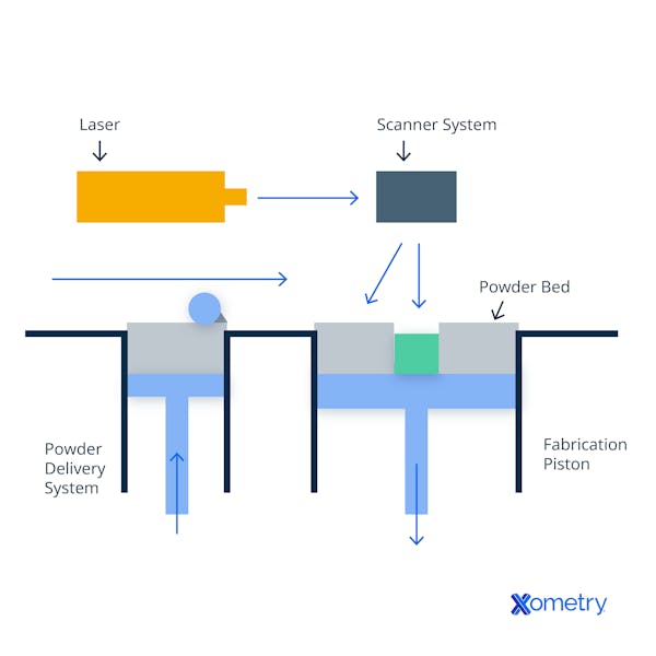

Selective laser sintering (SLS) swaps in those well-known plastic filaments for powdered plastic; typically nylon. This machine spreads a thin layer of this powder using a device called a recoater, then traces out the part’s cross-section with a laser. During the tracing, the heat from the laser melts the powder and it fuses together. The build chamber piston will then lower slightly, and another layer of powder will be spread across, and the process repeats until your product comes to life. This type of printing method does not require support structures as the un-sintered powder encases the parts throughout the medium, supporting them. For this reason, many parts can be built simultaneously in a single build which makes SLS printing superb for creating lots of parts at the same time, while retaining accuracy and quality.
The following diagram shows how an SLS 3D printer system works:
SLS 3D printing system.

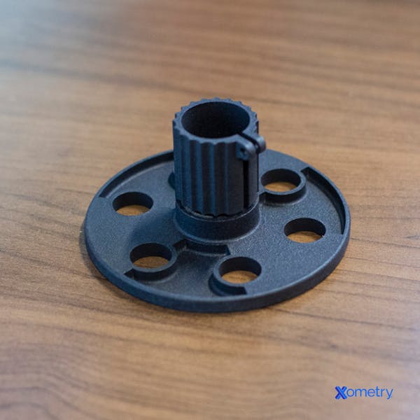

5. Multi-Jet Fusion (MJF)
Multi-jet fusion printing has a lot of moving parts. On these machines, a layer of plastic powder is deposited that’s then warmed up by a heating head. An inkjet-style array hovers over top and precisely sprays fusing and detailing agents into the powder. The heating elements fuse it all together, and the process repeats. Like SLS printing, MJF parts do not require support structures due to the powder-based method, and therefore many parts can be printed simultaneously both horizontally and vertically in the build chamber. At Xometry, we offer both rigid and flexible materials through MJF and multiple finishing options, such as dyeing and chemical vapor smoothing to enhance the prints further.
The image below is an example of a part made using Xometry's MJF services, which in this case, has also been dyed black:
MJF 3D printed nylon 12 part
Nylon 12 part printed using MJF with a dyed black finish.

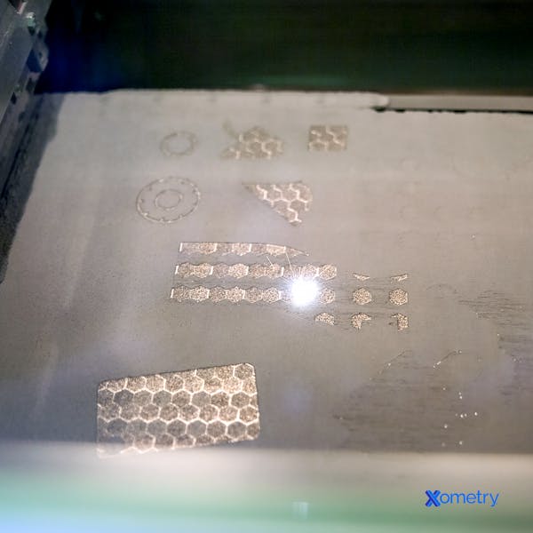

6. Direct Metal Laser Sintering (DMLS)
When you’re in the market for a process that can 3D print directly in metal, look to direct metal laser sintering (DMLS) services. Similar to selective laser sintering, DMLS machines deposit a thin layer of metallic powder, then use their powerful lasers to trace out each part’s cross section layer by layer, fusing the metallic particles together to form parts. Unlike SLS, support structures are required as the heat and stress generated by sintering metal is much greater than with plastics. Due to their size, high cost, and the extensive post-processing steps required on parts after printing is completed, DMLS machines tend to only be found in industrial shops, such as those within Xometry’s network.
This picture shows a DMLS printer at Xometry in the midst of sintering parts from steel powder:
DMLS 3D printer
DMLS 3D printer sintering steel powder to form parts.
