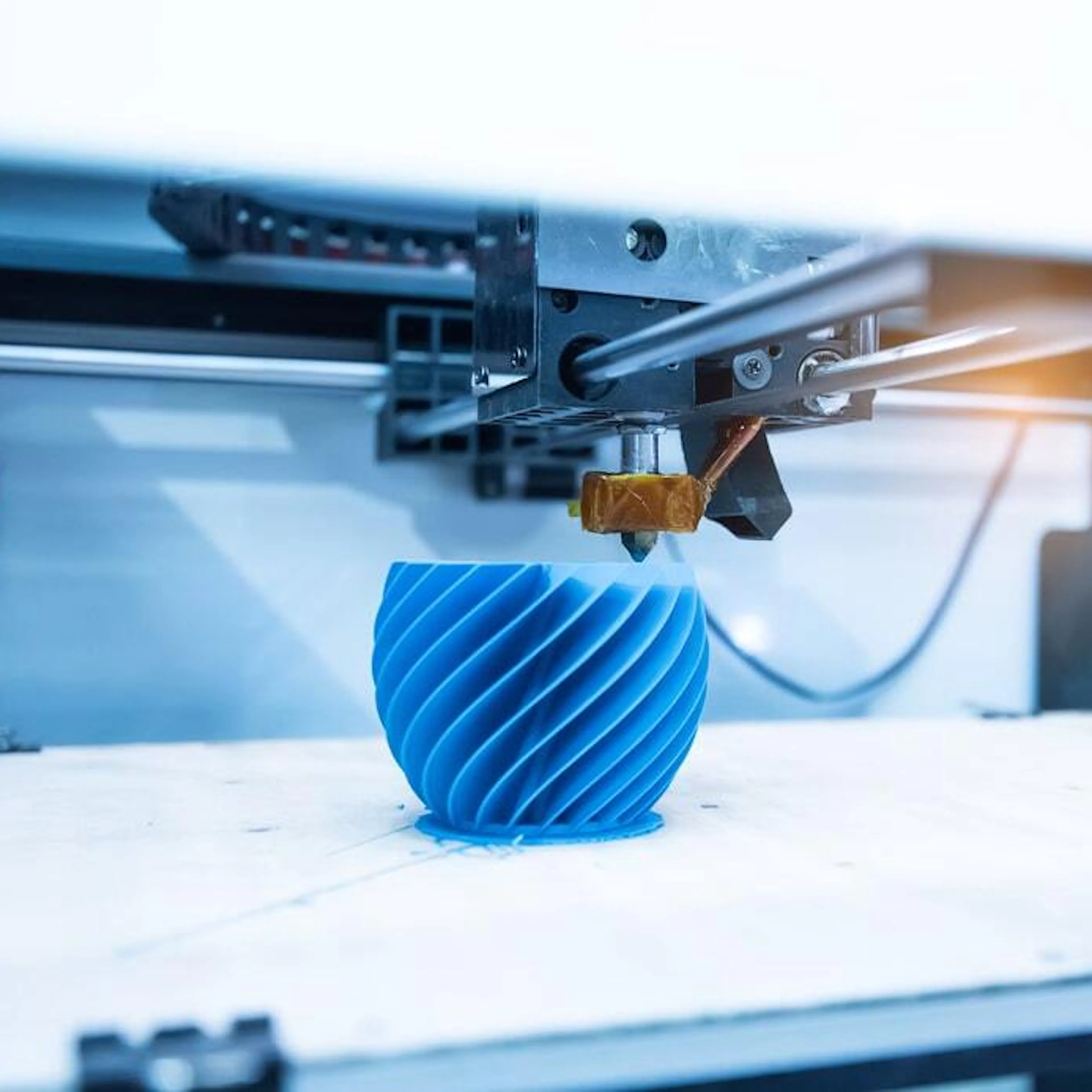

Learn about the most common 3D printer filament materials.
Up close of modern 3d printer. Image Credit: asharkyu/Shutterstock.com

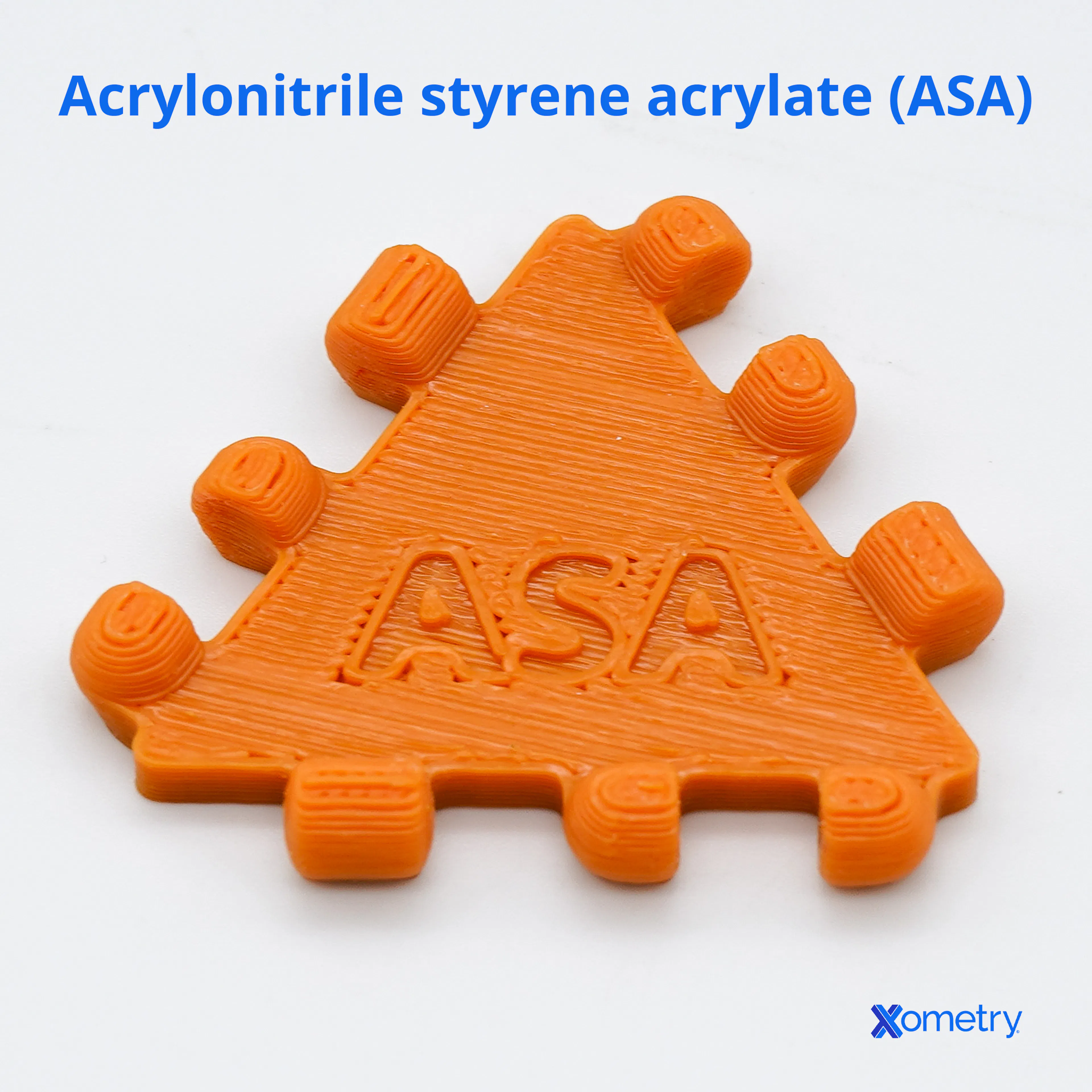

2. ASA (Acrylic Styrene Acrylonitrile)
ASA is an engineering-grade thermoplastic commonly viewed as a UV-stable alternative to ABS in both 3D printing and injection molding. It shares a similar chemical structure with ABS but replaces the butadiene component with an acrylate rubber, significantly enhancing its resistance to ultraviolet light, weathering, and environmental stress cracking. As a result, ASA is especially well-suited for outdoor applications where long-term exposure to sunlight would cause ABS to fade or degrade.
ASA offers comparable strength, impact, and thermal resistance to ABS. Its glass transition temperature is typically around 105 °C. However, its superior color stability under UV exposure, along with greater resistance to yellowing, makes it advantageous in applications requiring long-term aesthetic durability. ASA also exhibits lower warping tendencies during 3D printing, contributing to more consistent print quality, particularly in semi-enclosed or well-calibrated desktop printers.
A sample of Xometrys ASA material.

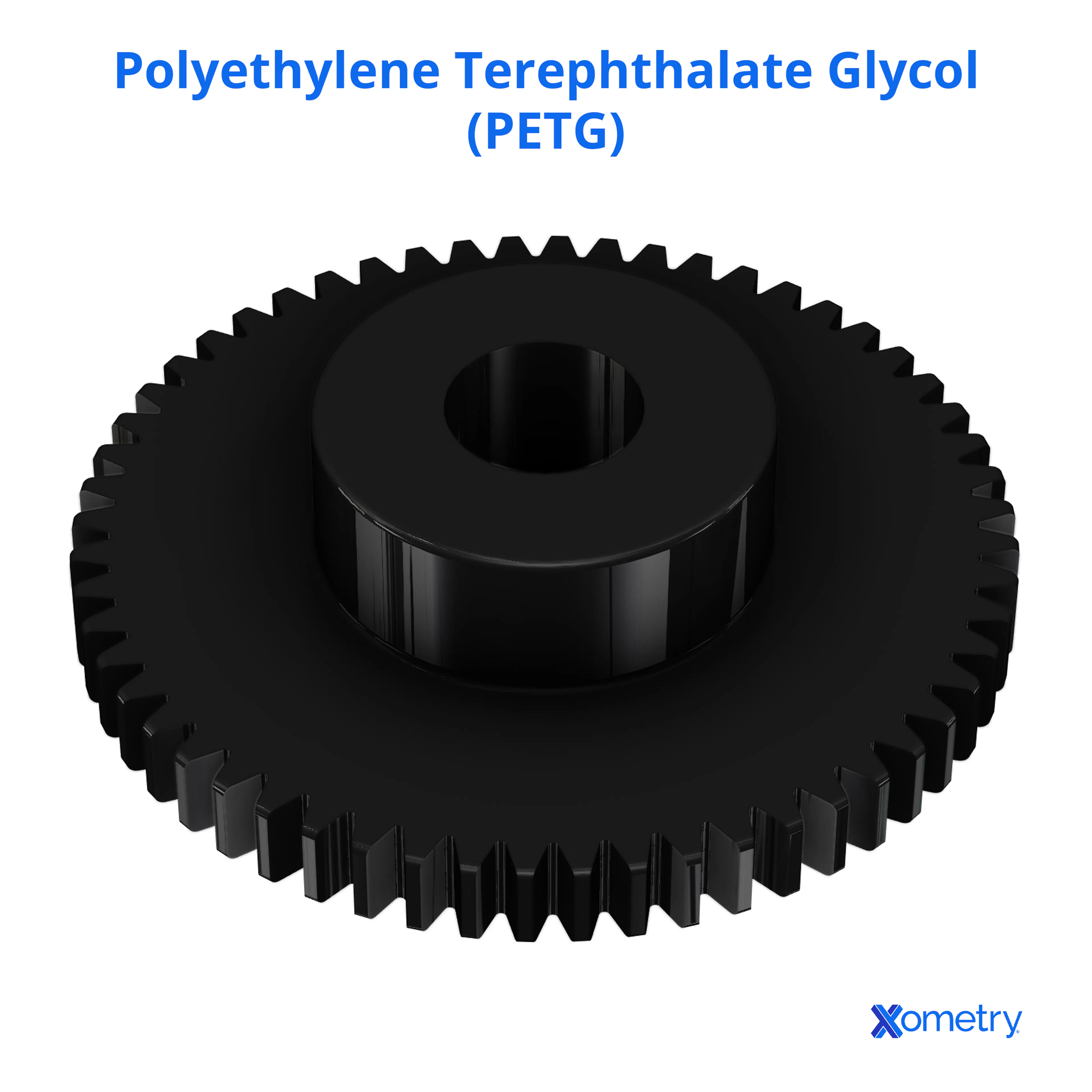

15. PET and PETG Filaments
PETG is a filament derived from polyethylene terephthalate (PET), the same material found in plastic water bottles. However, in PETG, a portion of the ethylene glycol is substituted with CHDM (cyclohexanedimethanol), signified by the "G" in its name, which stands for "glycol-modified." This modification yields a filament that boasts greater clarity, reduced brittleness, and enhanced ease of use compared to its unmodified PET counterpart.
PETG is a suitable alternative to ABS, offering heat-resistant properties without the production of toxic fumes. It is also popular for being food-safe. Additionally, PETG can be post-processed by sanding, akin to PLA. While most FDM printers compatible with PLA can also handle PETG, it may require more calibration and effort for optimal results.
The advantages of PETG include its ease of printing compared to ABS, the ability to maintain a smooth finish, and convenient storage properties. However, it comes with certain drawbacks, such as the requirement for high printing temperatures, which can lead to wear and tear on printer components over time. While PETG may not excel in bridging due to its high stickiness, this attribute translates into excellent layer adhesion. It is worth noting that PETG is more hygroscopic than PLA, making it susceptible to issues like substantial stringing and moisture absorption from the air if left exposed.
PETG gear
PETG gear
