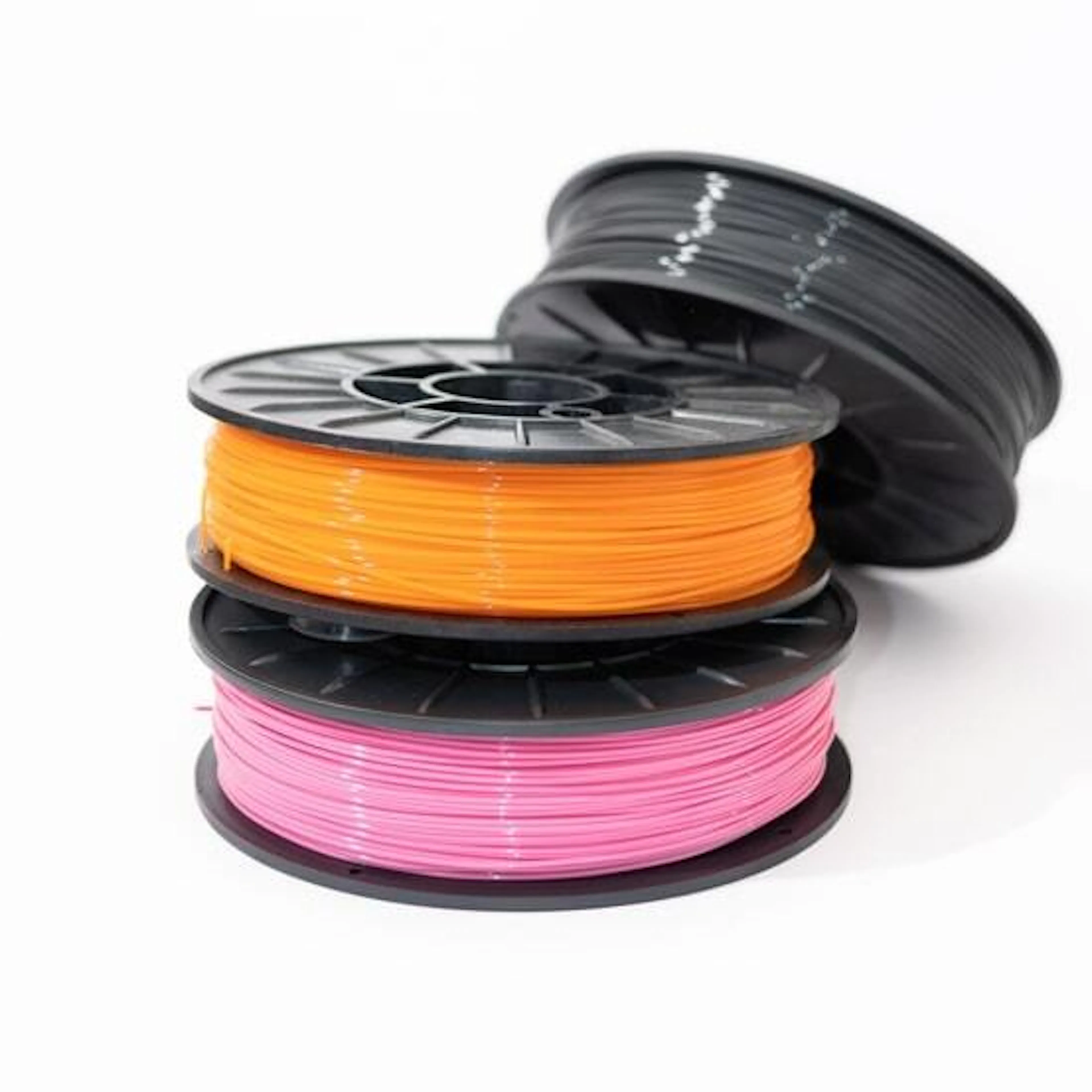

PLA plastic for 3D printing. Image Credit: Shutterstock.com/Yushchuk Myroslava
PLA (polylactic acid) filament is one of the most commonly used in fused deposition modeling (FDM) 3D printing because it’s easy to work with and looks great. In the history of plastics, PLA is the OG (well, one of them). It was invented in 1938 by DuPont chemist Wallace Carothers (who also, coincidentally, invented nylon), but took quite a long time to become mainstream. In the ‘50s, large manufacturing product materials companies started doing more in-depth research on it, and by the ‘90s, PLA was on the market commercially. It was first adopted as a biodegradable PET alternative and has since been used for everything from packaging and disposable cutlery to appliances and devices. When 3D printers emerged in the late '00s, PLA was one of the first filament materials used and, today, it accounts for more than 40% of the plastics used in additive manufacturing.

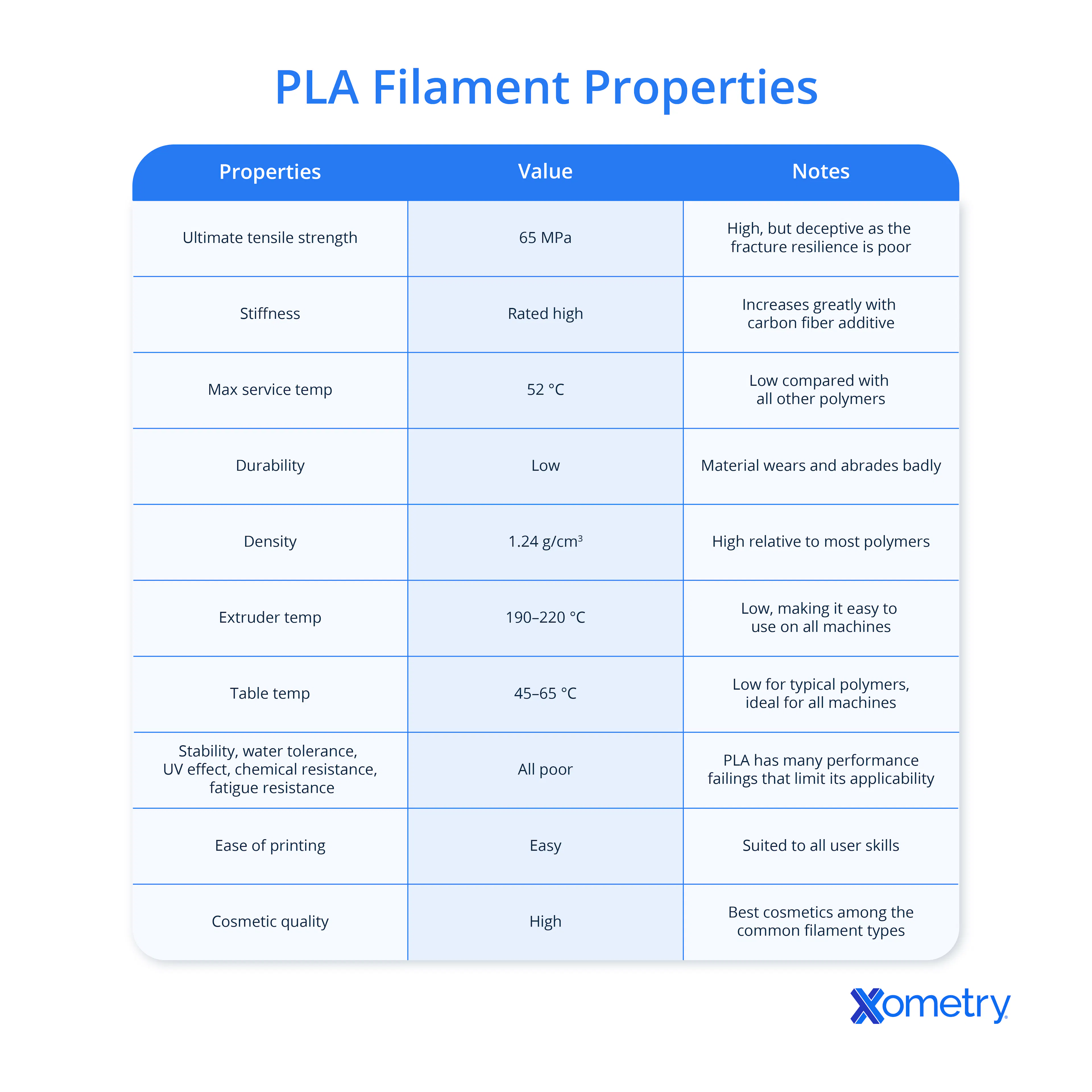

What are the Properties of PLA Filament?
All the important properties of PLA filament are listed in the table below.
PLA filament properties

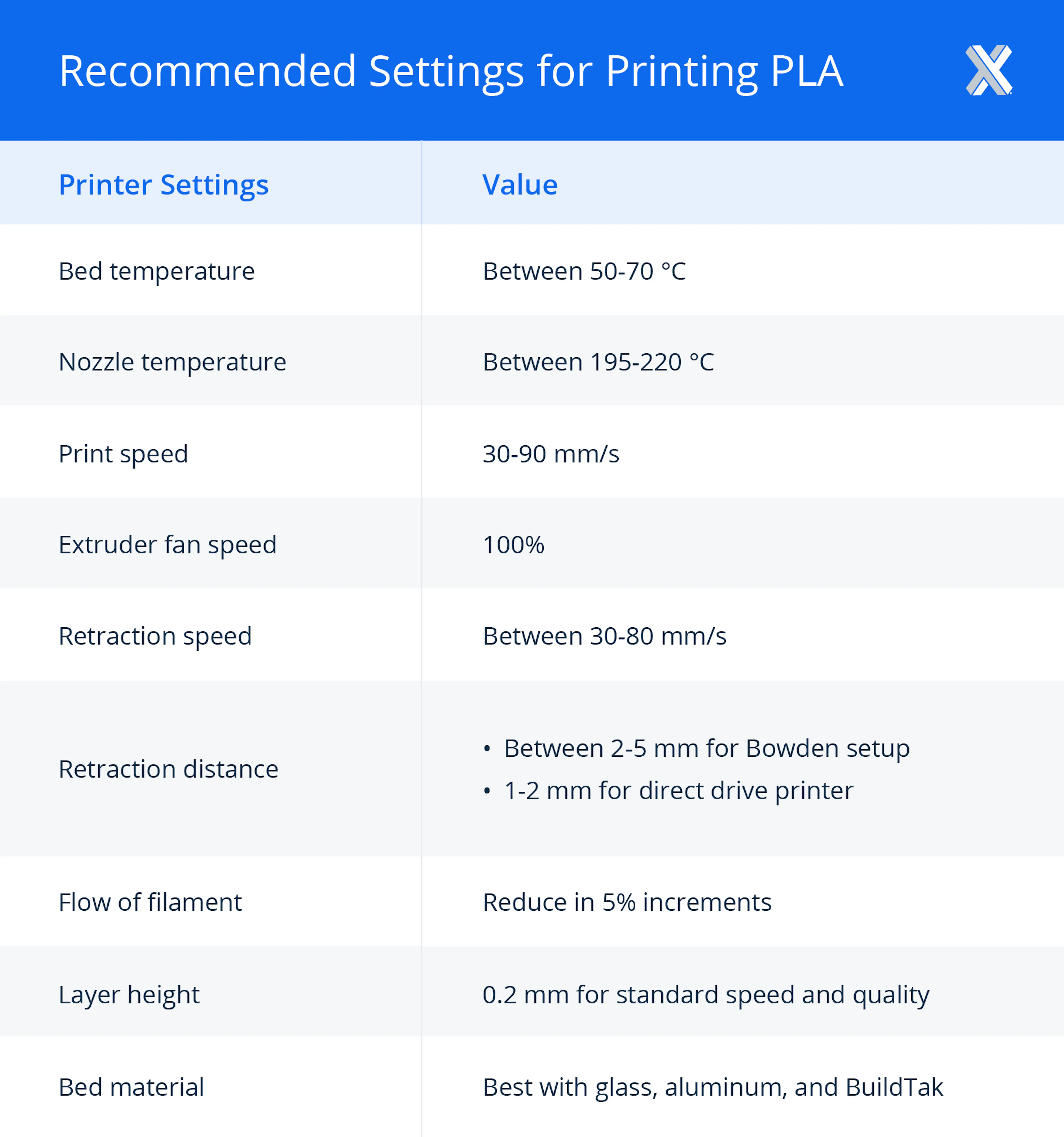

What is the PLA Filament Melting Temperature?
The PLA filament melting temperature is between 170 to 200°C. For best results in melting PLA filament, table 2 below summarizes the recommended printer settings:
When melting PLA filament, adjust your machine from a low temperature in small increments – while taking care not to mistake other issues such as over- or underfeeding of filament for nozzle temperature issues. Once the setup is right, it will need at most only small adjustments for general use thereafter.

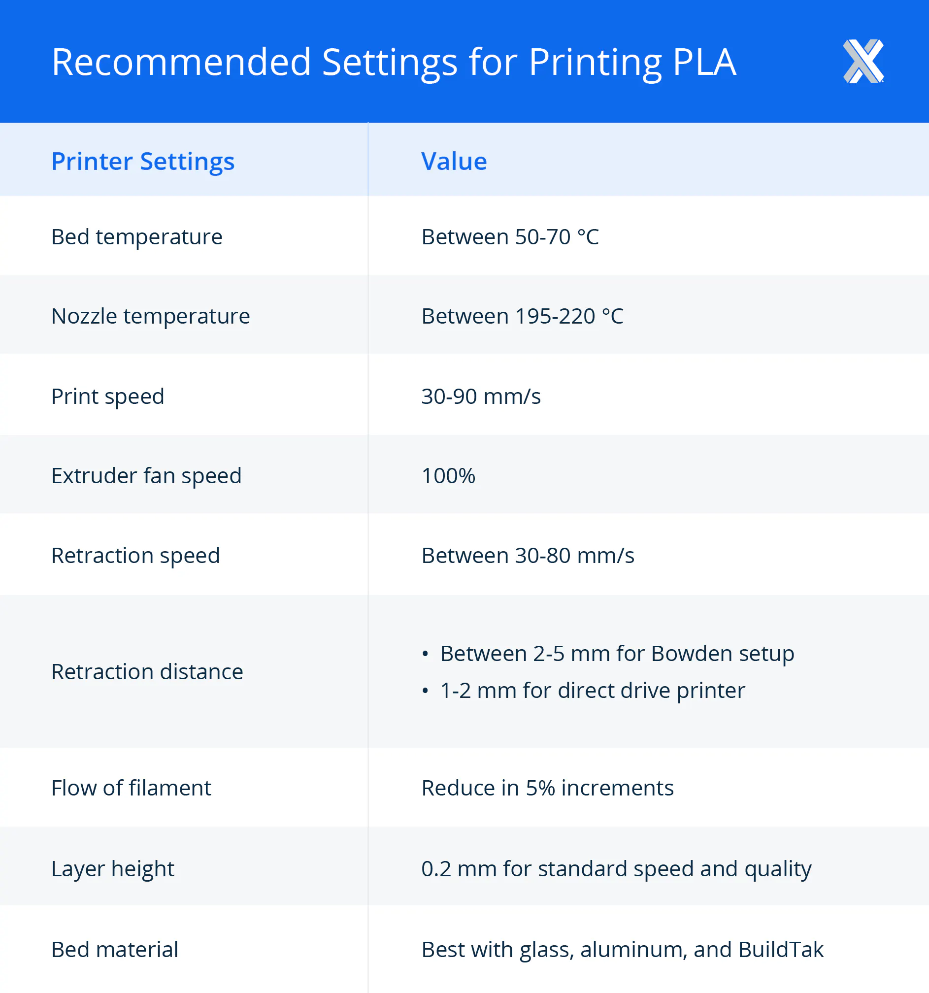

Best Settings for PLA 3D Printing Filament
To get the best results when 3D printing with PLA filament, you’ll want to make sure your printer has the right settings (although, to be fair, this material is pretty forgiving of settings). When melting it, the machine should be increased from a low setting in small increments, while being careful not to over- or under-feed the filament. You don’t particularly need a heated bed with this filament; the only thing that it would help with is easier removal of the final print. To make your piece stronger, you’ll want a wall thickness of 1.2–2.2mm, but for items with a solely cosmetic purpose, this can be 0.8mm. Getting the wall thickness just right is probably the only thing that will need a little skill. The settings we recommend for working with PLA filament are listed in the table below.
PLA printer settings
