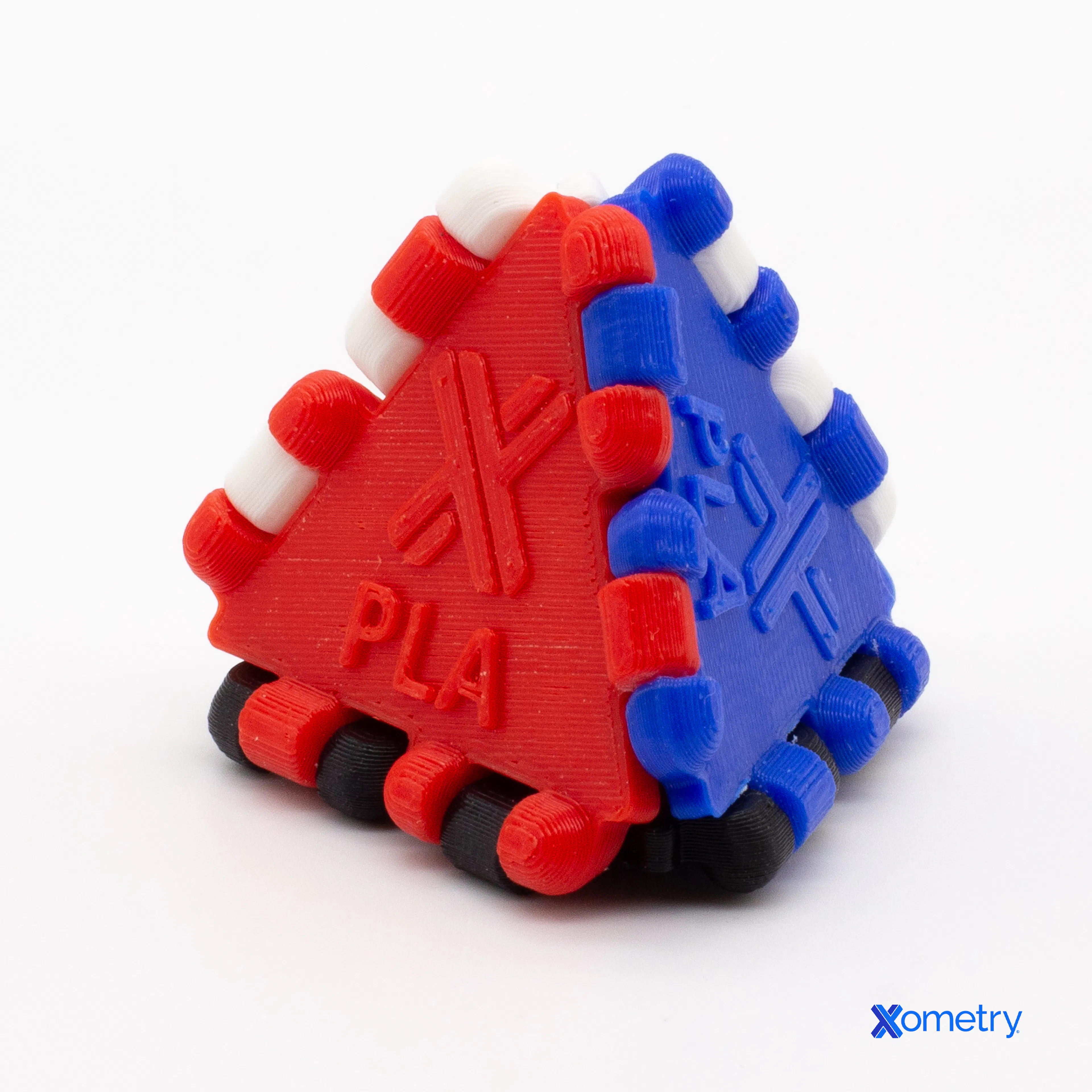

The image below shows a few parts that Xometry 3D printed using PLA:
Interconnected PLA parts 3D printed by Xometry.

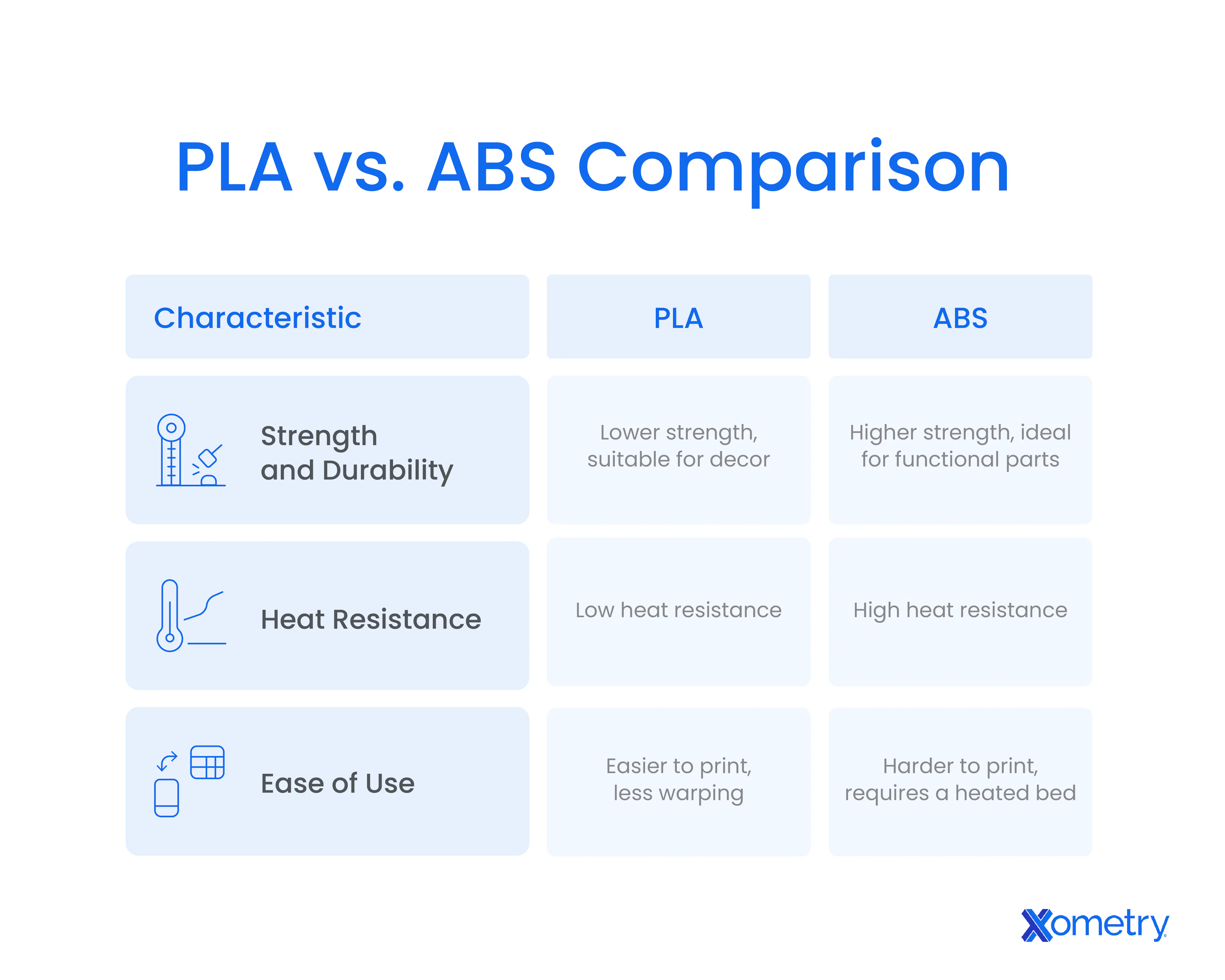

PLA and ABS differ fundamentally in thermal behavior, mechanical response, and processing requirements, which drives their distinct use cases in FDM printing. PLA has dimensional stability, low shrinkage, and is easy to process, allowing accurate prints at lower extrusion temperatures without heated beds or enclosures. However, it suffers from low glass-transition temperature and brittle failure under impact or sustained heat. ABS offers higher impact resistance, superior layer fusion, chemical resistance, and significantly higher heat tolerance due to its higher glass-transition temperature, at the cost of increased warping risk, higher energy input, and the need for controlled thermal environments. Material selection therefore hinges on whether the application favors visual quality, accuracy, and indoor safety (PLA) or functional durability, thermal resilience, and mechanical toughness under real-world loads (ABS).
What Are the Main Material Differences Between ABS and PLA for 3D Printing?
The main material differences between ABS and PLA for 3D printing are listed below.
  • Printing Temperature: PLA has a lower printing temperature, between 180°C and 220°C, while ABS requires higher temperatures, ranging from 220°C to 250°C. The difference affects the ease of printing, with PLA being easier to print at lower temperatures.
  • Strength and Durability: ABS is stronger and more impact-resistant than PLA. ABS is more flexible and handles higher stress without breaking. PLA is more rigid and brittle, making it less suitable for parts that undergo mechanical stress.
  • Heat Resistance: ABS has better heat resistance, maintaining its shape at higher temperatures (up to 100°C). PLA begins to deform at around 60°C, limiting its use in high-temperature environments.
  • Surface Finish: PLA provides a smoother, shinier finish compared to ABS. ABS is smoothed with acetone to achieve a glossy finish, while PLA’s finish is more consistent.
