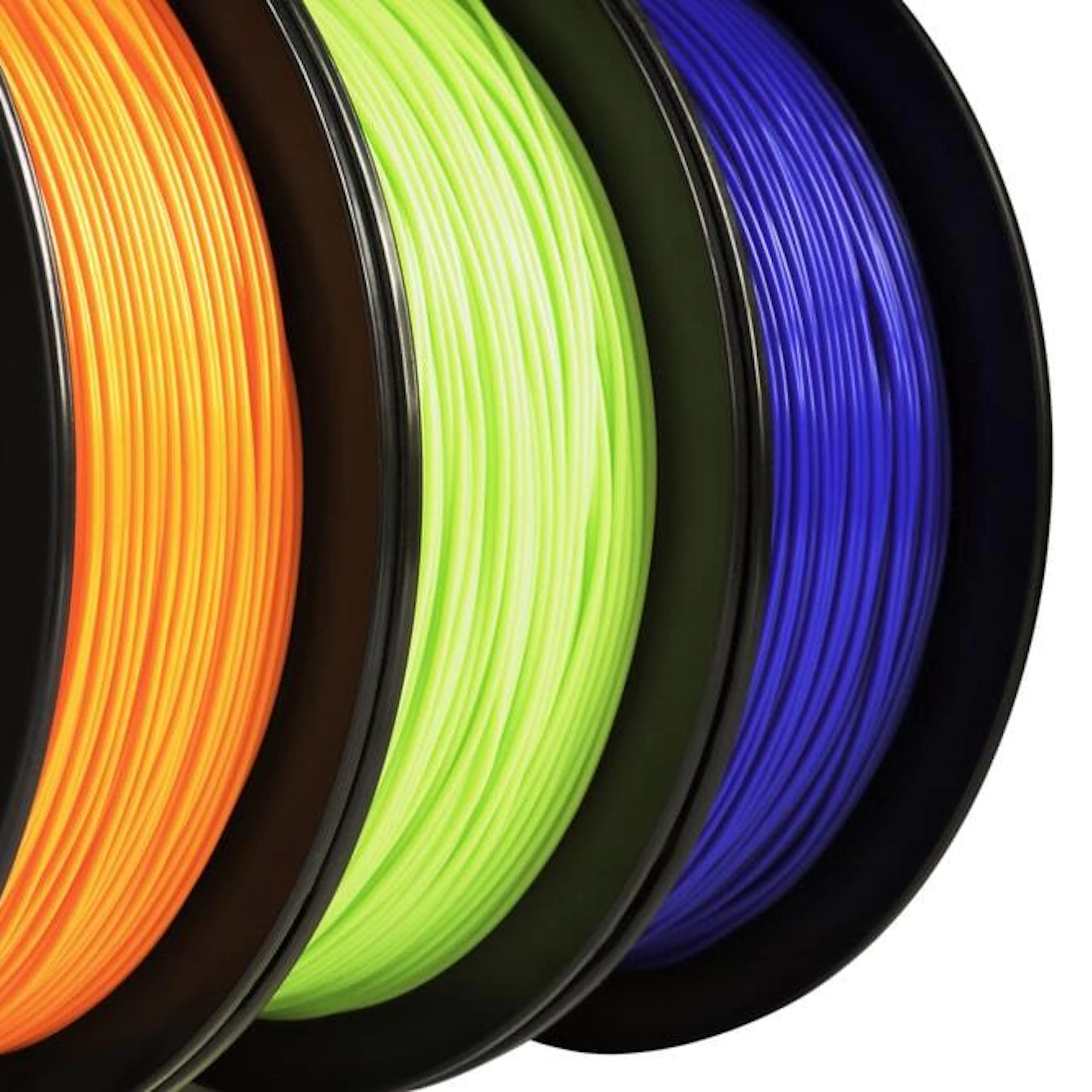

Bright filament for 3D printing. Image Credit: Shutterstock.com/Grigoryeva Photo Video

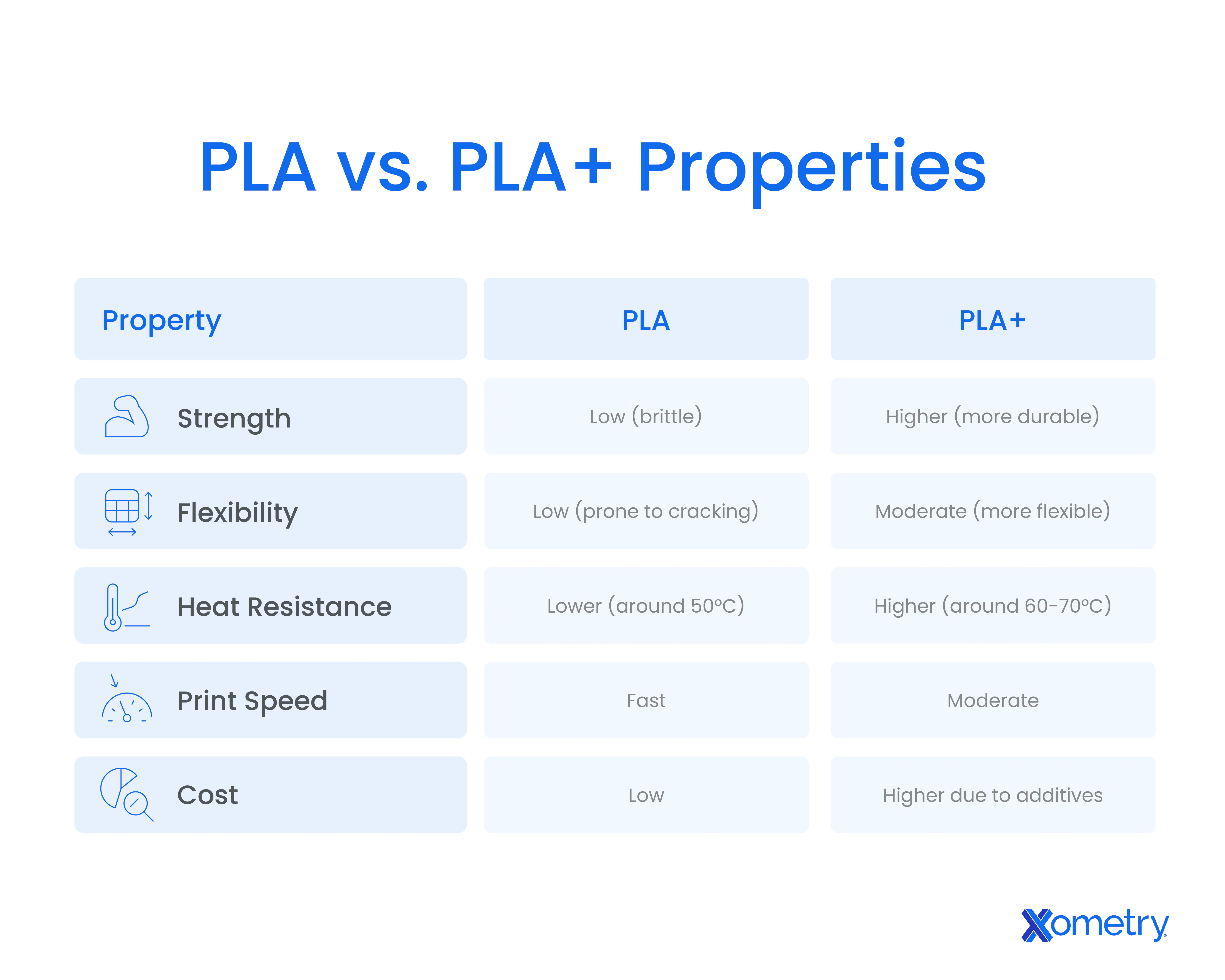

PLA vs. PLA+ Properties
What Are the Disadvantages of PLA Compared to PLA+?
The Disadvantages of PLA compared to PLA+ are listed below.
  • Brittleness: PLA is more brittle compared to PLA+, which results in cracks or breaks under stress or impact. PLA's lack of flexibility makes it unsuitable for parts that need to withstand mechanical stress. PLA+ overcomes limitations by increasing toughness and strength, offering better impact resistance and durability for more demanding applications. The added PLA+ strength makes PLA+ a better choice for parts requiring more resilience.
  • Low Heat Resistance: PLA softens at relatively low temperatures around 60°C (140°F), which is problematic for items exposed to heat. PLA+ addresses the issue by offering higher heat resistance, making it more suitable for functional parts exposed to warmer environments. The answer to the question, ‘What temperature does PLA soften? PLA softens at a lower temperature compared to PLA+, which withstands higher temperatures due to its improved thermal stability.
