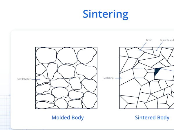

What Is Sintering?
Sintering involves heating powdered materials, such as metals or ceramics, slightly below their melting point to cause the particles to combine into a solid mass. Atomic diffusion across particle boundaries creates strong bonds. Successful sintering decreases porosity and improves properties including strength, thermal conductivity, electrical conductivity, and translucency.
Controlled sintering strengthens materials while maintaining porosity in some circumstances, as shown in filters and catalysts that need to be gas absorbent. Atomic diffusion removes surface flaws in the powder during the process, moving from pore formation to neck formation. The driving force behind the development of new, lower-energy solid-solid interfaces is the decline in free energy from surface reduction.
Controlling bond area, particle size, and vapor pressure allows for precise management of temperature and grain size during sintering, which directly affects the final material properties. The impact of temperature on diffusion and overall process quality is important. Figure 1 is a schematic diagram of the sintering process:
Sintering process schematic.
