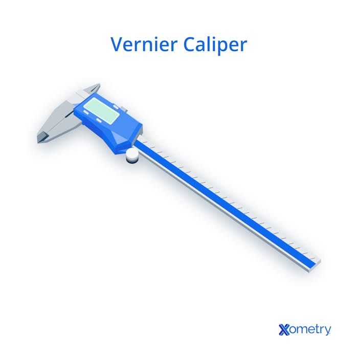

  • Vernier Caliper: The most basic of metrology tools, a vernier caliper is one of the least precise tools because its measured values depend heavily on how the tool is used. Different clamping pressures, for example, can result in different values.
Vernier Caliper
Vernier Caliper

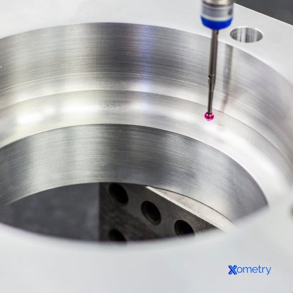

  • Coordinate Measuring Machine (CMM): A CMM is one of the most precise tools used for manufacturing metrology. It works by moving a gantry-mounted probe until it contacts the part. Once it touches the part, the probe generates an electrical signal. Its internal computer tracks the probe’s exact X, Y, and Z coordinate position as it moves, so it can generate an accurate measurement report in three dimensions. Doing this on multiple surfaces will map out a parts’ overall dimensional accuracy.
  • Optical Comparator: Optical comparators work by imaging a 2D silhouette of a part and comparing it to the prescribed dimensions. This machine excels at quick measurements on 2D part profiles. Digital comparators are similar to optical comparators, but use computations to measure features without manual tools.
Metrology tool being used by CMM
CMM inspecting a part with a metrology tool
