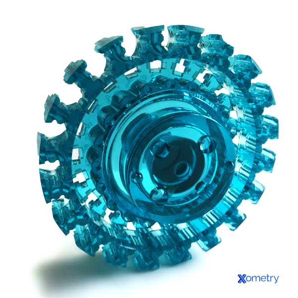

Urethane-cast parts can be either rigid, flexible, or even rubber-like depending on the composition of the urethane used. We offer urethane in a wide variety of color options including translucent, black, and PMS/RAL color matching. Parts may also be applied with a standard, smooth finish, or a custom finish, which includes adding hardware installations and painting.
Polyurethane part
Polyurethane part
