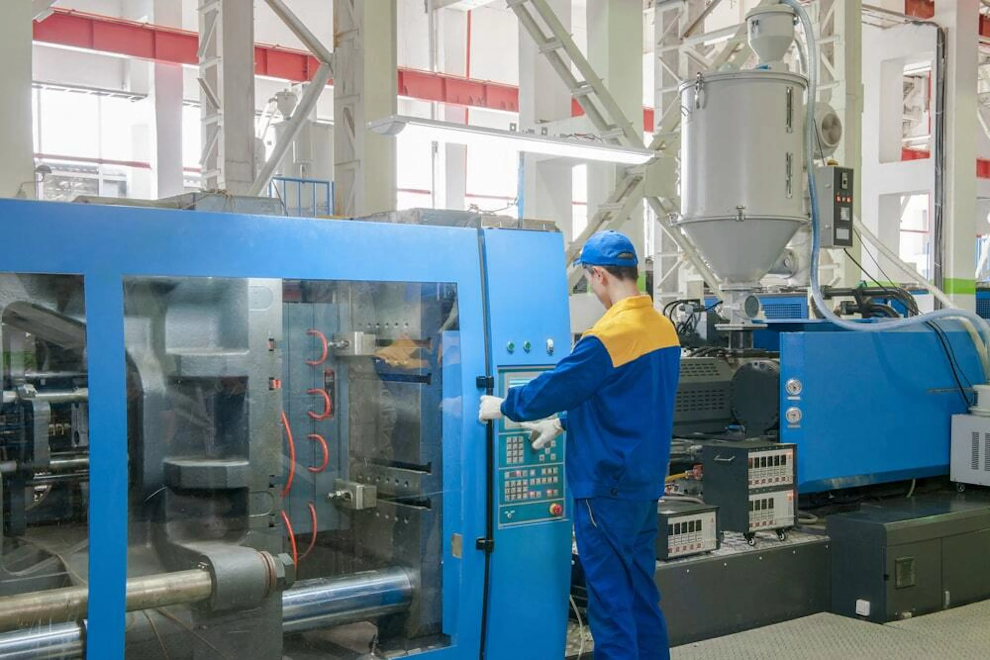

Plastic injection molding is a method used to produce plastic parts at an extremely high rate. As such, it should be no surprise that injection molding is the go-to technology for most plastic consumer products.

Plastic injection molding advantages include, but are not limited to, the following.
