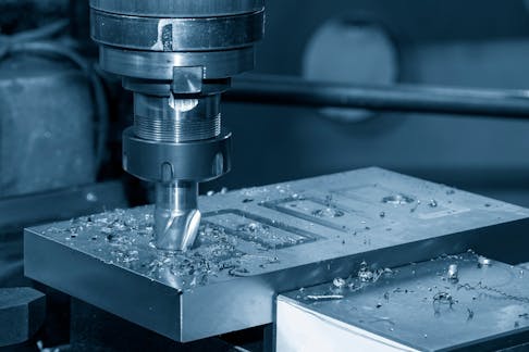

What is Milling?
Milling is a subtractive machining technique. A rotating cutter removes material from either a fixed or advancing workpiece. High-speed rotation produces chips during cutting. Advancement of the workpiece against the cutter forms flat planes, recessed pockets, and linear grooves. Metals, plastics, and composites undergo shaping through this method. Milling can achieve precision depending on machine capability, tooling, setup, and process parameters. Multiple teeth on the cutter allow uninterrupted removal of material. Feed rate establishes the pace of workpiece movement. Rotation speed influences the smoothness of the finished surface. Milling executes roughing operations and finishing operations. Cutter geometry dictates the final contour. Complex three-dimensional structures emerge through successive passes. Dimensional refinement occurs at each stage. Accuracy, consistency, and production capacity secure milling as a cornerstone of machine shops.
Is Milling a Machining Process That Uses a Rotating Cutter?
Yes, Milling is a machining process that uses a rotating cutter. A rotating cutter removes material from a workpiece and generates chips during cutting. The cutter rotates around an axis while the workpiece advances into the cutting edges. Each tooth of the cutter performs a separate cut, producing controlled material removal. Metals and plastics undergo shaping through the method.  Cutter speed is selected based on material properties (including hardness), tool material, and cutting conditions; chip evacuation depends primarily on tool geometry, feed rate, and coolant use. Milling involves intermittent cutting (each tooth engages and disengages), not continuous contact. Milling equipment provides stable support that maintains accurate rotation. Precision depends on the stability of both the cutter and workpiece. Cutter geometry defines the operation and establishes the final form. Milling serves industrial tasks that demand reliability, dimensional accuracy, and repeatable performance.
What is a Milling Machine?
A milling machine operates as a power-driven device that removes material through a rotating cutter. The workpiece remains secured on a movable table, allowing precise positioning during machining. The spindle drives the cutter at high speeds, enabling efficient removal of material. Movement of the table along the X, Y, and Z axes provides flexibility in shaping. Feed rate controls material removal rate and chip load, while cutting speed is determined by spindle speed; both influence accuracy.
The rigid frame maintains tight tolerances throughout operation. Modern machines incorporate automated controls that streamline repetitive tasks. Manual versions rely on handwheels for table movement. The frame supports the motor and drive mechanisms, while cooling systems prevent overheating during extended use. Milling machines create components (gears, slots, and flat surfaces). Reliability and accuracy characterize their performance. Different cutters accommodate specialized functions. Manufacturers employ milling machines for heavy-duty removal of metal and for delicate finishing tasks.
How Does a Milling Machine Work in Machining?
The milling machine works by rotating a multi-point cutting tool while feeding the workpiece against it. The motor powers the spindle for high rotational speeds, and the workpiece is clamped on the worktable to prevent movement. The table moves along different axes to guide the material into the cutter, with each tool revolution removing a layer of material in the form of chips.
The operator or computer program controls the cut depth, and lubrication or coolant flows over the cutting zone to reduce friction. The machine’s precision ensures the workpiece meets design specifications. Motion follows linear or circular paths, depending on the desired shape. Rigidity in the machine frame prevents vibrations that affect surface quality. The process repeats until the part reaches the final dimensions. Stability is critical for high-quality results, with the tool-material interaction defining the shaping process.
Does a Milling Machine Remove Material Using a Milling Cutter?
Yes, a milling machine removes material using a rotating milling cutter with multiple sharp teeth. Each tooth removes a small portion of material as the workpiece enters the tool's path, shaping the part. Cutter types vary based on the operation (end mills, face mills, slab mills), with tool sharpness ensuring clean cuts and high accuracy.
Material removal rates depend on spindle speed and feed rate, with the machine providing the necessary torque to shear material effectively. Chip formation indicates cutting efficiency, and proper tool selection prevents excessive heat buildup and wear. The cutter is the primary interface between the machine and workpiece, with high-quality cutters yielding better surface finishes. The mechanical action enables rapid material removal in industrial settings, with each rotation contributing to the part's final geometry.

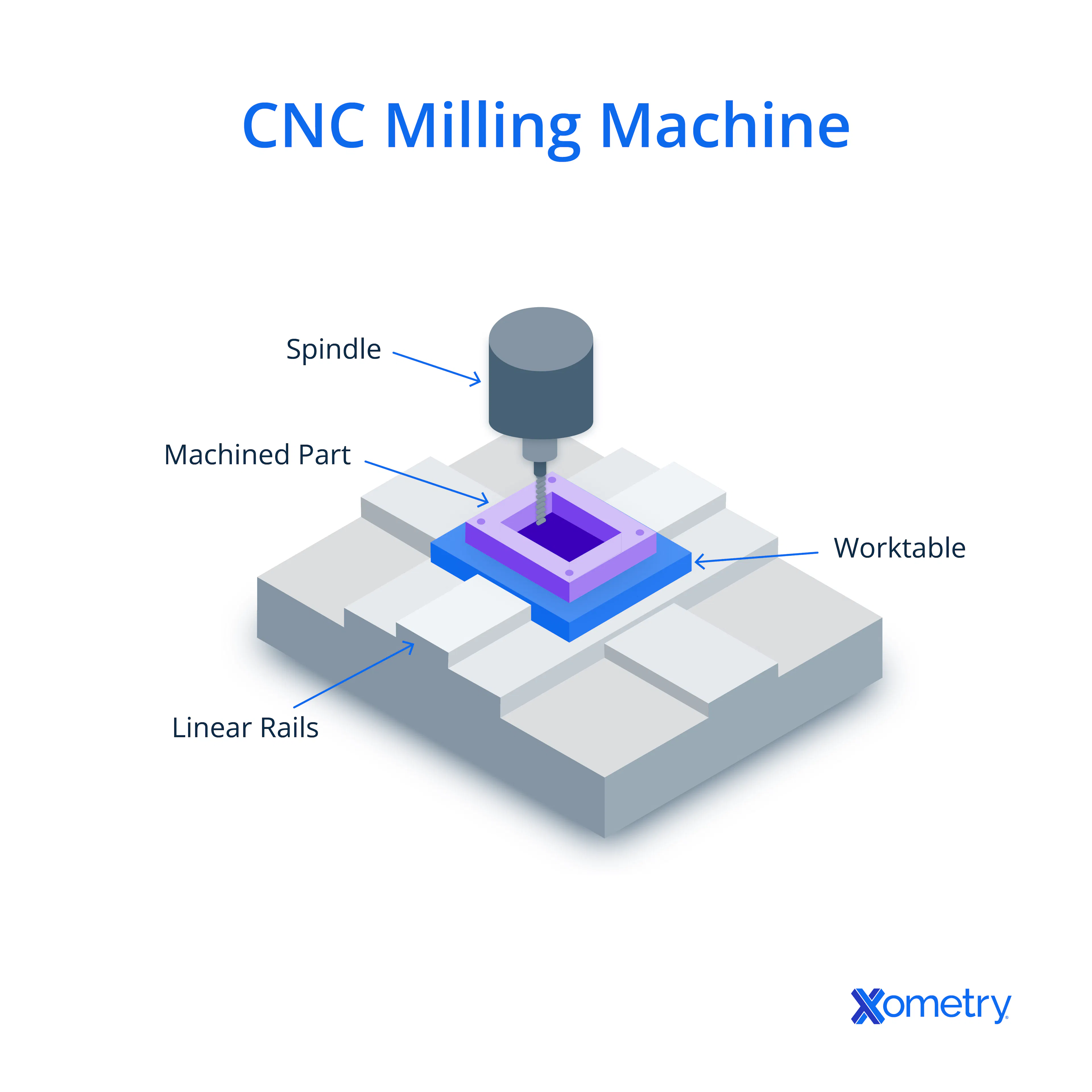

What Does a Milling Machine Diagram Show?
A milling machine diagram shows the internal and external components and their relationships, highlighting the spindle, worktable, column, and knee. It identifies the motor and drive system locations and illustrates the movement of the X, Y, and Z axes to help operators understand the machine. Feed mechanisms and control handles are clearly labelled for easy identification.
The diagram aids machinists in setting up the workpiece and tool, and assists maintenance teams in locating parts for repair or lubrication. It visualizes the relationship between the tool and workpiece, including coolant lines and safety guards. The diagram provides an overview of the machine architecture, essential for safe and accurate operation. It is a reference for milling tasks and supports the training of new operators, improving setup reliability.
A diagram for a CNC Milling Machine
Does a Milling Machine Diagram Include the Spindle and Worktable?
Yes, a milling machine diagram includes the spindle and worktable, which are the primary components. The spindle holds and rotates the cutting tool, while the worktable secures and moves the workpiece. The diagram shows their spatial relationship and how the table moves relative to the spindle. It depicts controls for adjusting their positions. Understanding these parts is crucial for setting up milling operations. The diagram provides a clear view of how the tool interacts with the material and helps troubleshoot movement or alignment issues. Safety features near the components are typically shown. The diagram is important for machine shop education, as understanding machine layout supports proper setup and operation.

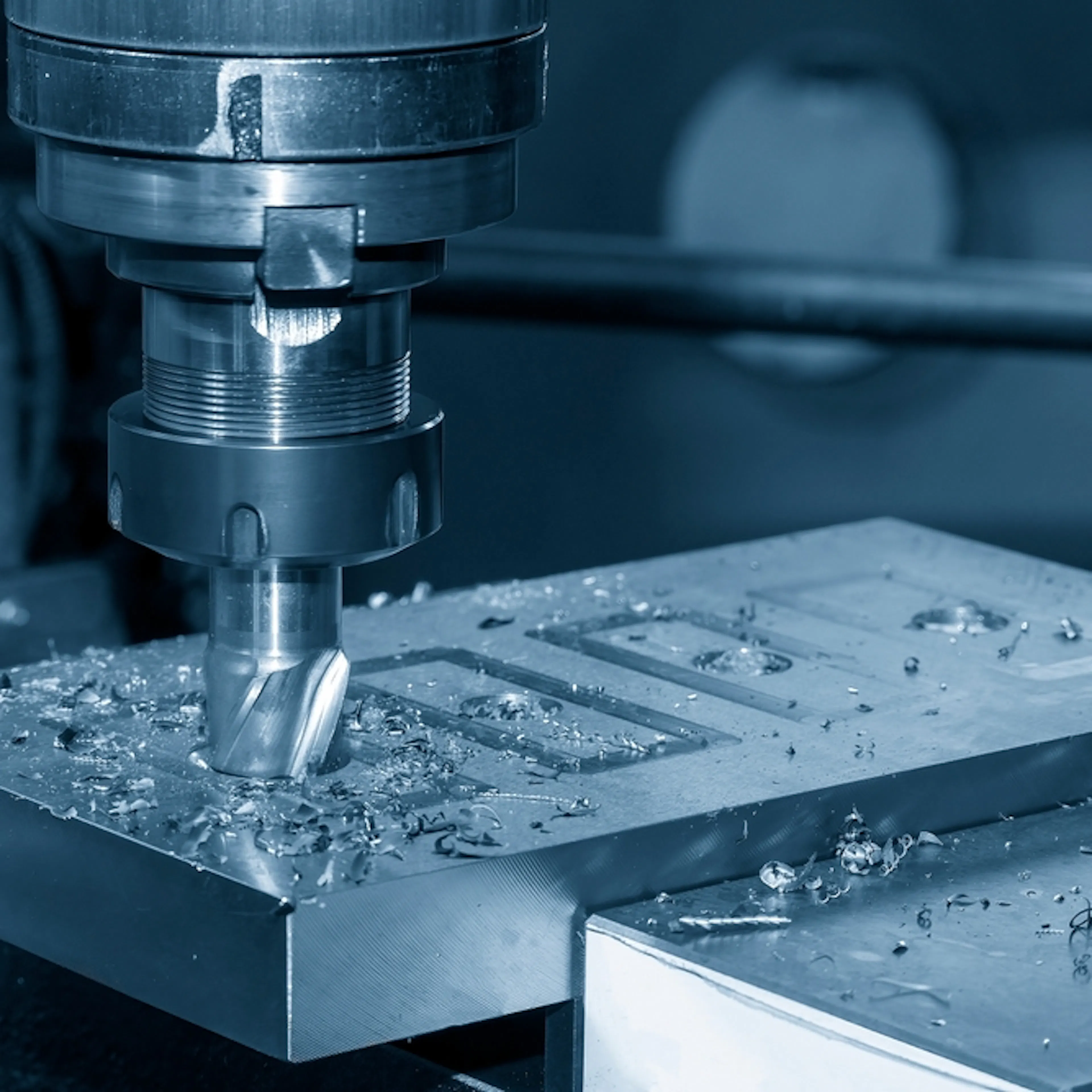

What is a Milling Cutter?
A milling cutter is a rotating multi-edge tool used for subtractive material removal. The milling cutter has sharp teeth to shave off chips as the cutter spins, with each tooth acting as a separate cutting edge for high-speed operation. The cutter is mounted on the spindle and moved across the workpiece surface. Milling cutters come in various shapes (cylindrical, conical, spherical), and the material (carbide, high-speed steel, ceramics) depends on the workpiece hardness. The number of teeth affects surface finish and feed rate. The cutter performs tasks such as slotting, facing, and profiling; drilling is typically performed by drills, though milling can create holes via interpolation. Its tooth geometry determines the type of chip produced. High-quality cutters resist heat and wear, and their sharpness and accuracy are crucial for precision machining. The cutter is a consumable part, requiring replacement or sharpening. Efficiency and reliability are key to maintaining production standards.
How Does a Milling Cutter Perform Cutting Operations?
A milling cutter performs cutting operations by rotating at high speeds, engaging the material with multiple teeth. The spindle, driven by the motor, spins the tool while the workpiece moves into its path. Each tooth shears a small amount of material, generating heat and chips, which are evacuated from the cutting zone.
The rotation speed and feed rate determine chip thickness, and cutting can occur in the same direction as the feed (climb milling) or against it (conventional milling). Sharp tool edges ensure clean, precise material removal, with coolant applied to protect the tool and improve surface finish. The tool geometry defines the final shape of the feature, and machine stability prevents tool vibration during operation. The process continues until the desired dimensions are achieved, with accuracy dependent on the interaction between the cutter and material. The mechanical force enables the shaping of hard metals.
