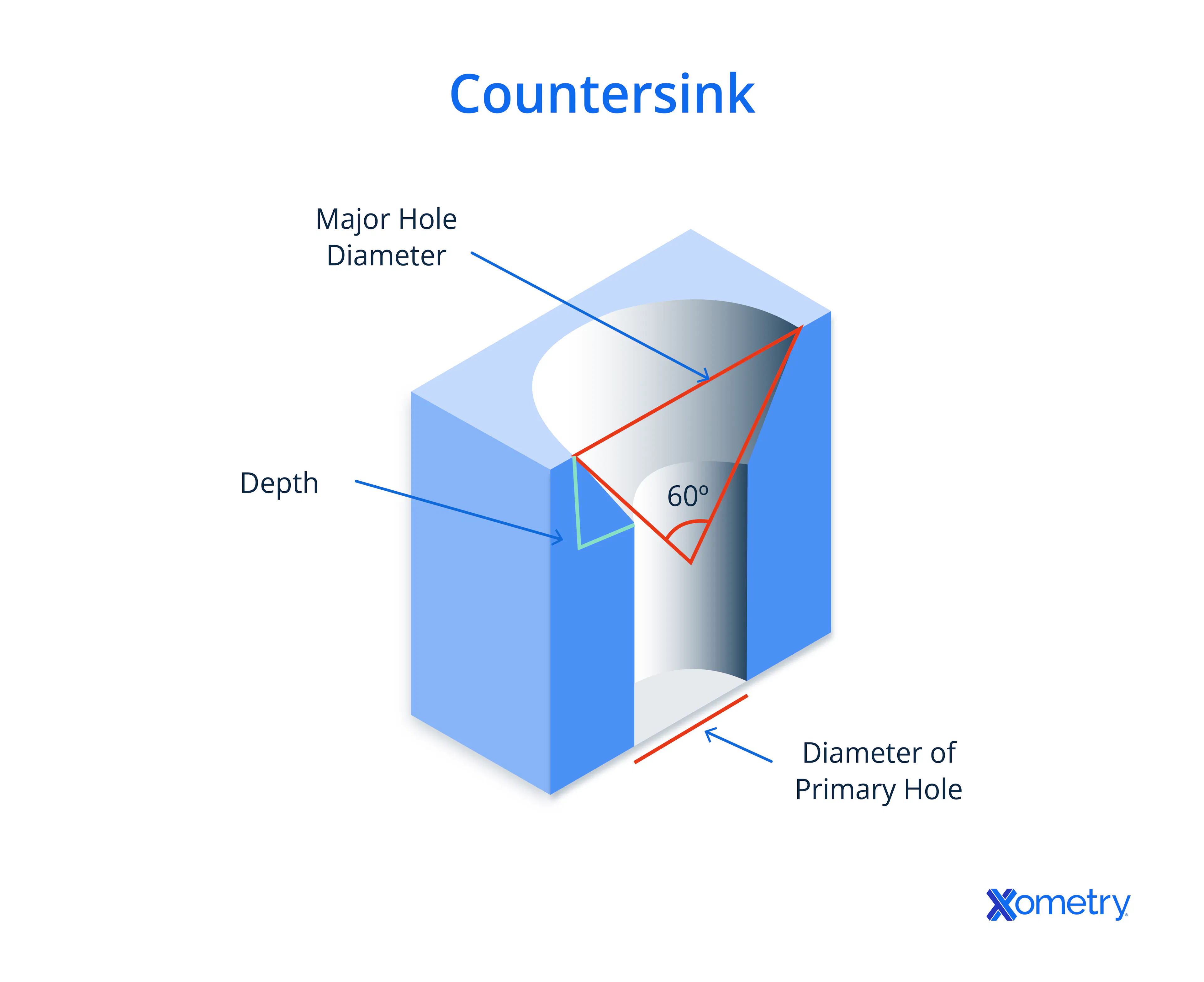

Often used in woodworking on softer materials, countersink holes (callout symbol “⌵”) are cylindrical holes made to match the angle of a screw so it can be secured in place and sit nice and flush. It comes in many angles, from 60° to 120°, although 90° is the most common. Here’s an example of a countersunk hole:
A countersink hole
A countersink hole
The cone-shaped hole’s widest part (the “Major Hole Diameter” shown in the image above) is specifically designed for a screw or bolt to be inserted. The angle is important when it comes to these holes because this is what will determine how deep the fastener can be sunk in—the deeper it goes, the more secure it will be. Aside from making a joint stronger, a countersunk hole allows the fastener to go in at a shallower angle, lowering the chances of it stripping the material.

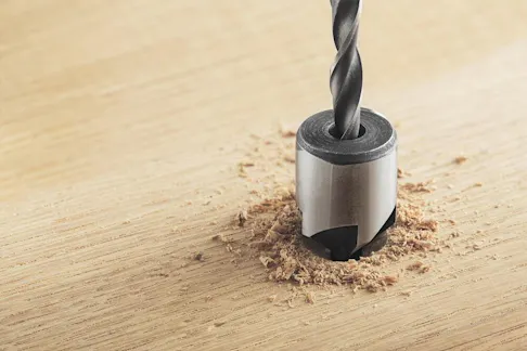

These holes can be made with a drill and a countersink bit or machined with endmills. The most important thing to do is make sure the hole is the right size and shape for whatever is going into it.

Making one of these holes is a breeze: first drill a small pilot hole with a drill bit of an appropriate diameter, and then make that hole bigger with an endmill or a counterbore cutter which is specially designed for the job. If you make a counterbore hole big enough for a washer, this could ramp up its holding power.

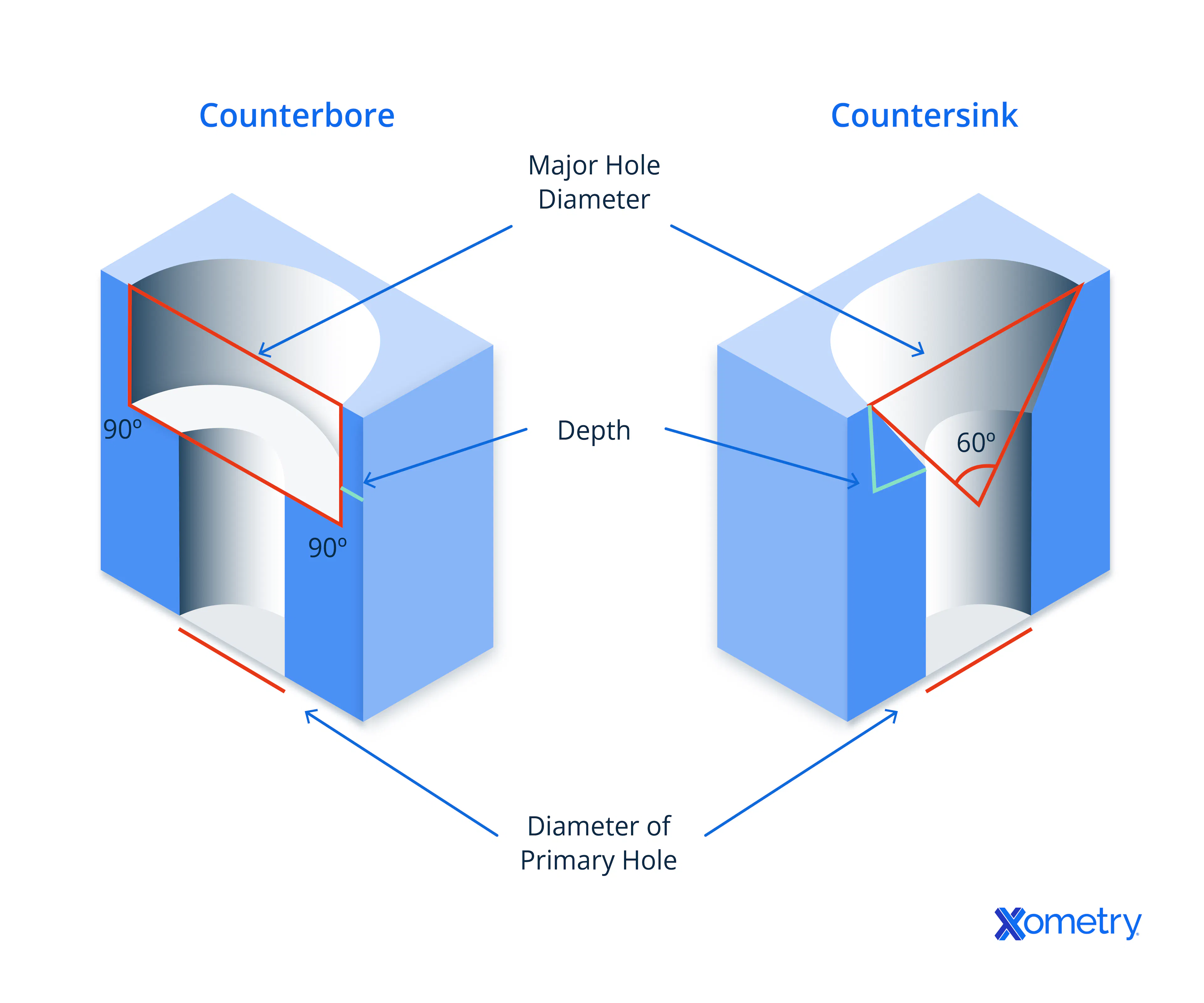

Countersink vs. Counterbore: Size
Counterbore holes are normally not as deep as a countersink hole, and instead of having tapered sides, they’re straight. They also tend to have more holding strength than countersink holes for two main reasons: the force applied by the socket cap screw head is parallel to the axis, and the force applied by the screw or bolt is evenly distributed over a larger surface area. You won’t find these strengths with countersunk holes, which have tapered angled sides and unevenly distributed force. The below image will give you a better idea of their differences.
Countersink vs. Counterbore: Shape
A countersink is a cone-shaped hole. A counterbore, on the other hand, is a cylindrical flat-bottomed hole that is created to contain a socket or hexhead cap screw. In other words, a countersink hole is cone-shaped while a counterbore hole is cylindrical.
countersink vs. counterbore holes
A comparison of counterbore and countersink holes
