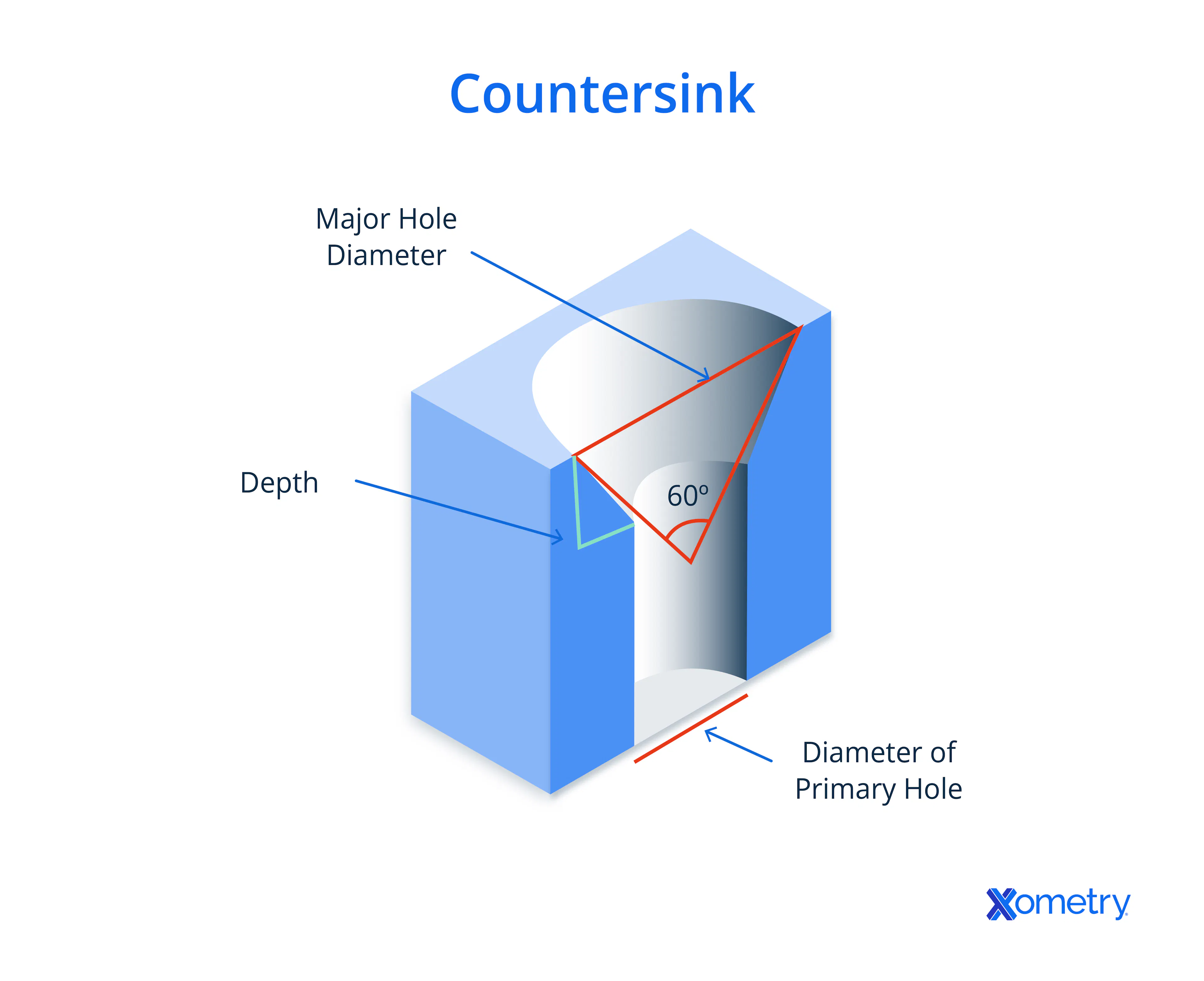

A countersink hole is one in which the outer edge of the hole has been opened up to a conical entry. For ANSI/Imperial fasteners, it is commonly at 82°, 90° for metric fasteners, 100° for BA threaded fasteners, and 120° for sheet metal rivets. The ISO callout for a countersink is:. The countersink is generally sized according to the head dimensions of the fastener being fitted, such that a flat-faced fastener will sit flush with the countersunk surface. It is common to further recess the head to sit below the countersunk surface by increasing the diameter of the countersink. This process allows for variations in the head and potential distortion of the drive recess in the fastener, caused by driver bruising.
Where the countersink is further drilled parallel, this is referred to as a “counterdrilled” hole. This allows plugs or caps to be fitted, which renders the fasteners invisible, taking the improved appearance to its logical conclusion. This generally applies to fasteners that are not at risk of requiring later removal. Additional practical reasons for countersinking holes to bury the heads of fasteners are: in moving equipment, to remove obstacles and reduce the need for clearances; in walkways, and on stairs and gantries, to remove obstructions and trip hazards; and to bury fastener heads where additional components must overlay the fastener, removing the need for precise relief holes/recesses in the overlying part.

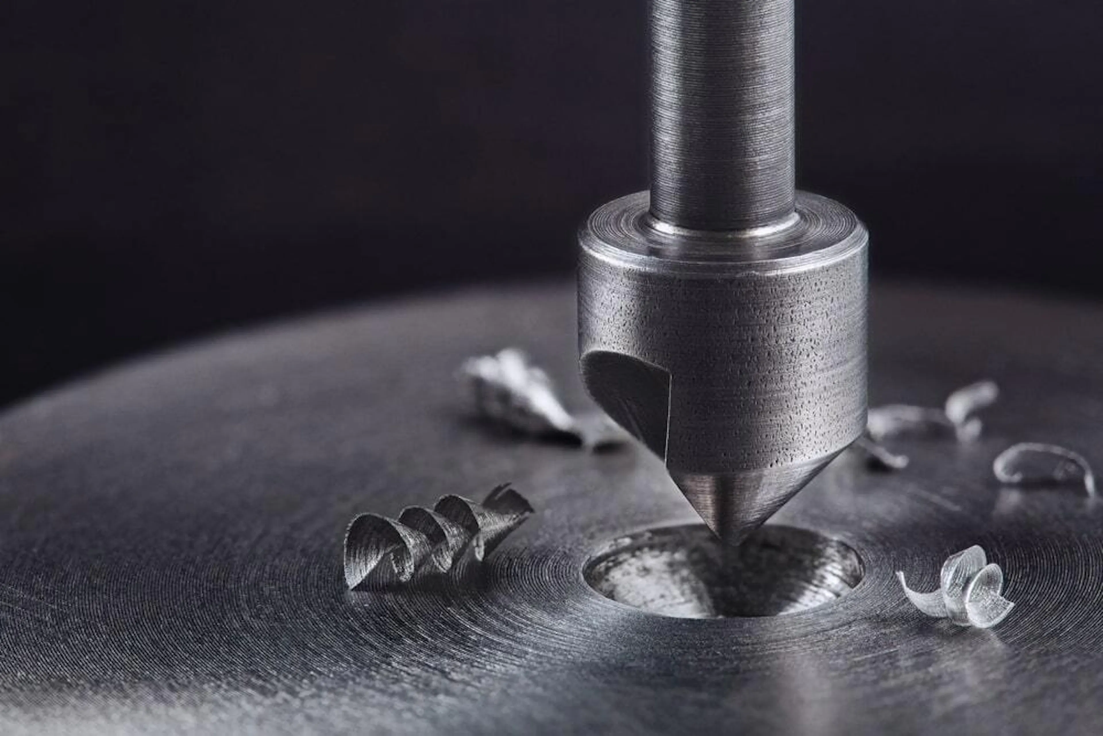

Countersinking is usually performed as a secondary operation after the hole is formed/drilled. The countersink tool does not cut at its center of rotation and can, in some cases, have a smooth post that locates the tool into the hole to ensure a smoother start and precise centering.
Countersinking tools are specialist drill bits and cutters that can have multiple cutting faces. In the case of larger countersinks, and particularly those for machine use, they commonly have only one flute/cutter. This feature aids in centering on the hole and producing a more even and regular cut.
Countersinking operations can be manual or machine performed but involve plunge cutting a specialist cutter of the correct included tip angle into a pre-made hole, to a defined and controlled depth, to produce a standardized and repeatable conical recess. A countersink hole is pictured below:

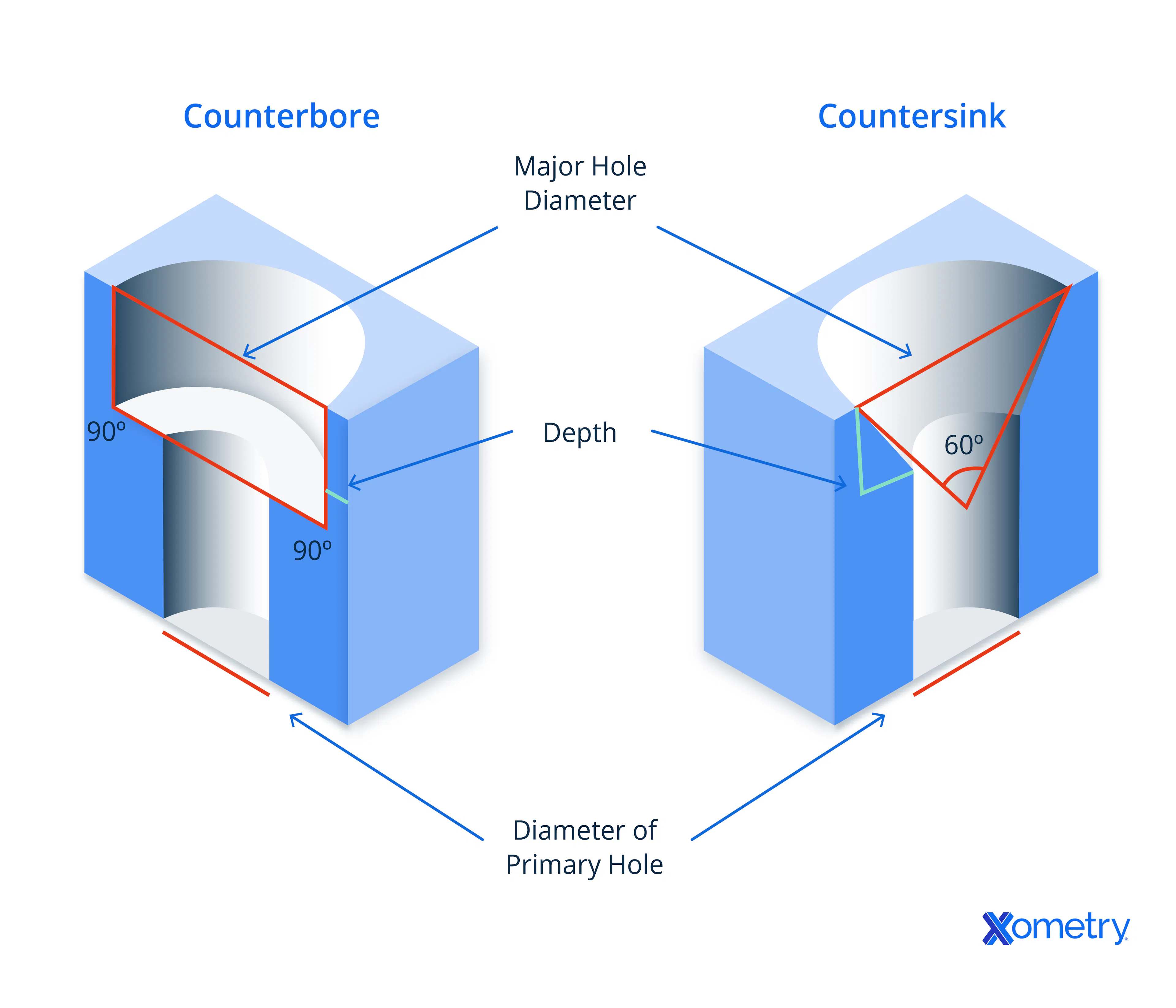

Both countersink holes and counterbore holes apply to much the same range of fastener types and are used for the same purpose–to give fasteners a flush (or below flush) finish for cosmetic or technical reasons. Below you’ll see a diagram of the hole differences.
countersink vs. counterbore holes
Countersink vs. counterbore holes
Countersinking requires a conical rather than cylindrical recess, angle, and diameter to match the underside of the intended fastener head and applies to:
  1. All types of heads for drives used for rotating threaded fasteners—internal hex, Phillips, crosshead, Torx, pin Torx, slot, and many more.
  2. All conical-bottomed threaded fastener head types such as pan, button, cap, and more.
  3. Wide variety of knock-down joint fasteners that are not threaded, such as quarter-turn locks and more.
  4. Various rivet types such as pop, peened, and push rivets
  5. A counterbore hole serves the purpose of recessing and thereby concealing fastener heads that have flat, perpendicular lower faces.
Counterbore holes have a cylindrical opening that’s larger in diameter than the hole, cut at the outer face of a blind or through hole, whose diameter and depth are defined to fit a particular fastener head, or a family of fastener heads, or according to ANSI and ISO standards.
