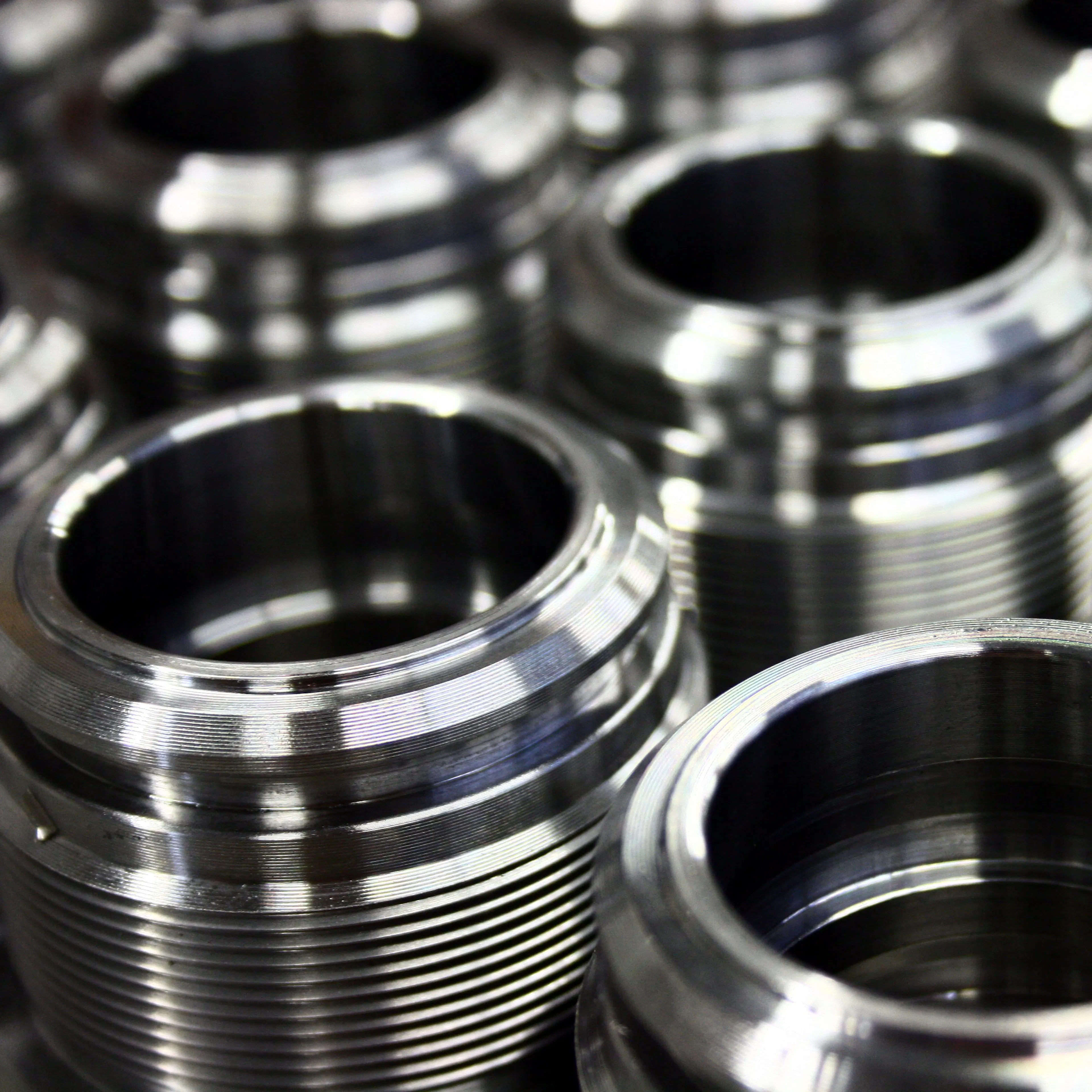

There are several ways to cut threads - tapping, thread milling or turning, thread rolling, and die threading, among others. However, no matter what method is used and no matter whether the threads are cut internally or externally, the defects that can occur in threads across all methods are similar. The most common defects, the reasons they occur in threaded parts, and how to solve them are described below:
