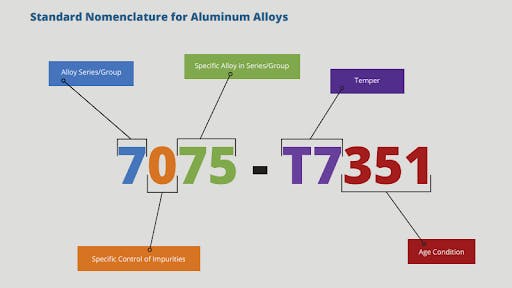

Annotation of Aluminum Alloy Nomenclature
The specification of aluminum alloy can be broken down by its series, temper, and conditions.
An additional suffix after tempers can signify the wrought product type for even more specific material specifications. The example table below shows the classifications for aluminum 7075-T7351.
Classifications for Aluminum 7075-T7351
Letter Indicator in 7075-T7351
7XXX-series
T7
351
A breakdown of what each character in aluminum 7075-T7351 means for that specific alloy.
