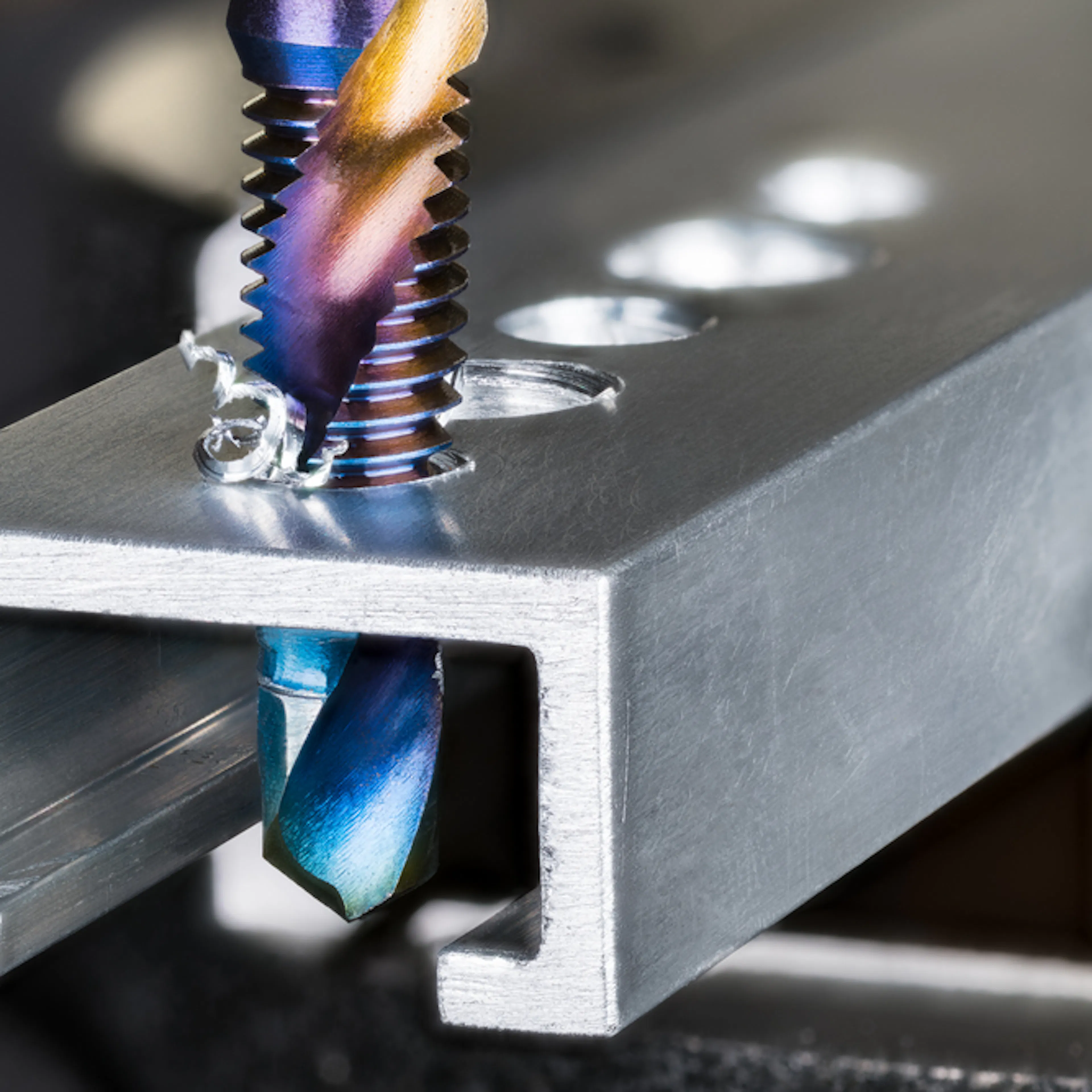

In certain instances, the drilling operation that precedes tapping is performed with a combination drill and tap tool, in which the drill presents the cutting tip that forms the hole, and a tapping region is machined onto the flutes above the tip, to switch from drilling to tapping as the operation proceeds. These tools are unusual in that they use helical flutes like a twist drill, to allow effective bulk chip clearance from the drilling stage and they are used for relatively low-criticality and low-precision threading.

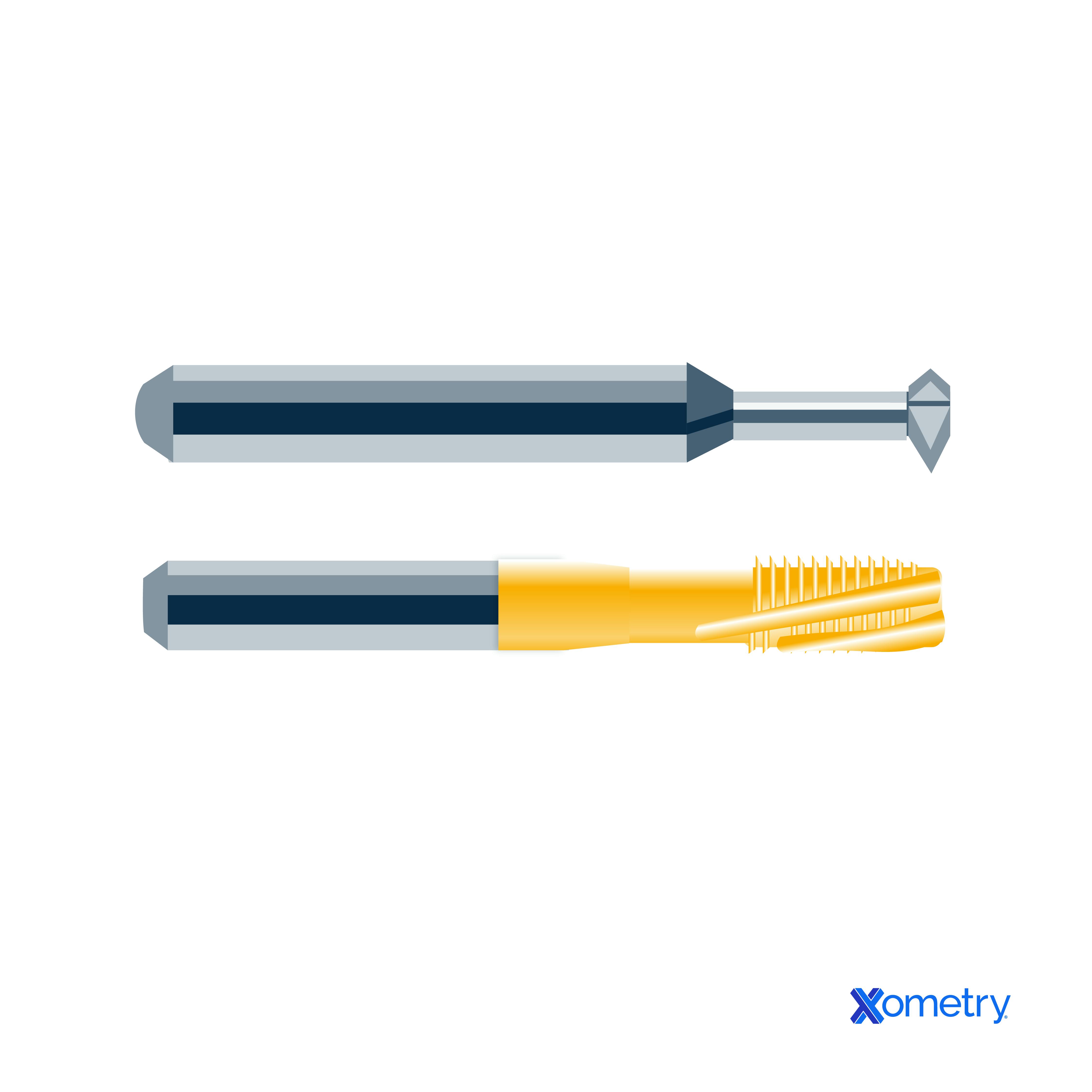

drawing of a thread mill
Drawing comparing a thread mill and tapping tool

What Is the Difference Between Tapping and Thread Milling?
Tapping and thread milling are two distinct machining processes used to create threads in a workpiece, each with its advantages and disadvantages. For example, tapping uses a tap that has all of the thread diameter and tooth profile in its form, and it cuts the threads as it rotates concentrically with the hole. Thread milling, on the other hand, uses a milling cutter with multiple flutes or inserts to create threads. Instead of cutting threads with a single-point tool like a tap, thread milling removes material by spiraling along the desired thread path.
Additionally, tapping is a faster and more straightforward process for creating threads in certain applications but has limitations in terms of thread type, diameter, and depth. Thread milling offers greater flexibility and versatility. The choice between tapping and thread milling depends on the specific needs of the machining operation and, most of all, on the intended diameter of the bore to be threaded.
