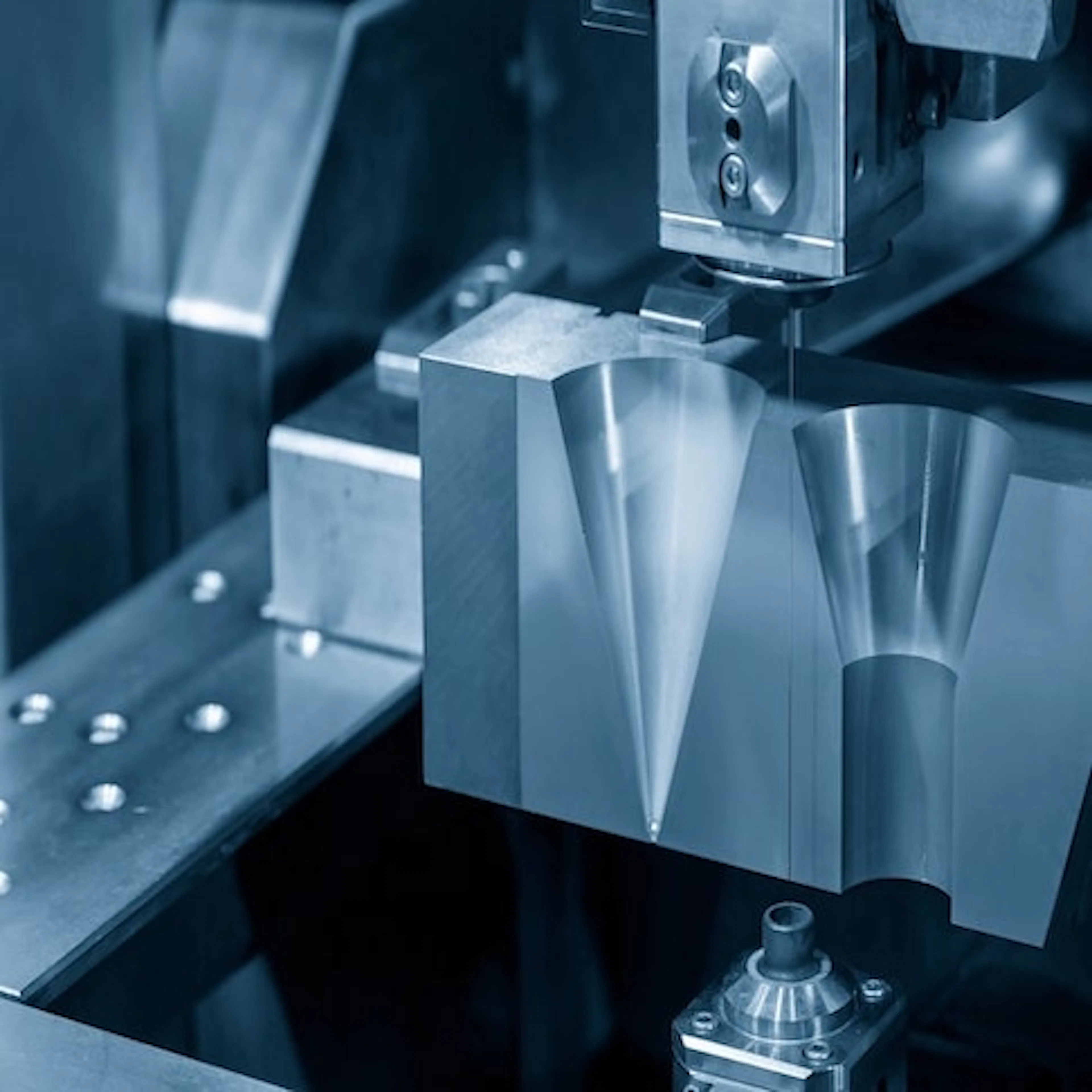

Wire cutting electrical discharge machining, commonly referred to as wire cut EDM, uses a wire as the “cutter” and erodes material by sparking between wire and workpiece. The wire electrode discharges along the whole length of a cut and feeds through, aiding the removal of cuttings. The technique developed as a way of performing 2D cuts (cuts that could only proceed along the x and y axes of a part, with the z-axis the thickness of the material) in hard materials, but it has grown in complexity. Offsetting the wire rollers from each other made cuts at a controlled angle to the z-axis possible. Later, it also became possible to add a rotational axis to the wire EDM process, resulting in highly capable 5-axis wire EDM centers.
This method can make start-free cuts. It is most commonly used for making extrusion tools and punch/die sets when combined with EDM drilling (to lace the electrode). Brass, zinc-coated brass, and zinc-diffused copper (stratified wire), running on sapphire or diamond guides are used as electrodes in the wire EDM process. Various conductivities, hardnesses, and tensile strengths of electrode wire offer different machining characteristics. For more information, see our guide on All About Wire EDM Machining.
Example of a part Wire EDM would be useful for

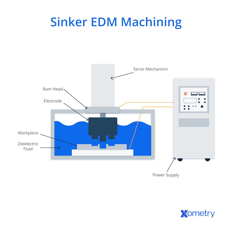

Sinker discharge machining (also known as "ram" or "cavity" EDM) uses discharge from an essentially 2D electrode. This 2D electrode can have a complex 3D-shaped end that is repeatedly plunged to arc erode into the work and raised a short distance on the Z axis to clear debris. This electrode can have any cross-sectional shape and a complex end form (without undercuts). For sinker discharge machining, precise copper and/or graphite electrodes are first machined to the desired cavity shape and then used to erode the shape into hard materials.
Ram EDM is widely employed in the injection molding and die-casting tool-making sectors. It is used to make nonmachinable complexity and finely detailed cavity features in molds without imposing any machining or impact stress on the mold. It also reduces the need for post-processing for surface quality improvement or hardening.
Sinker EDM machining process diagram

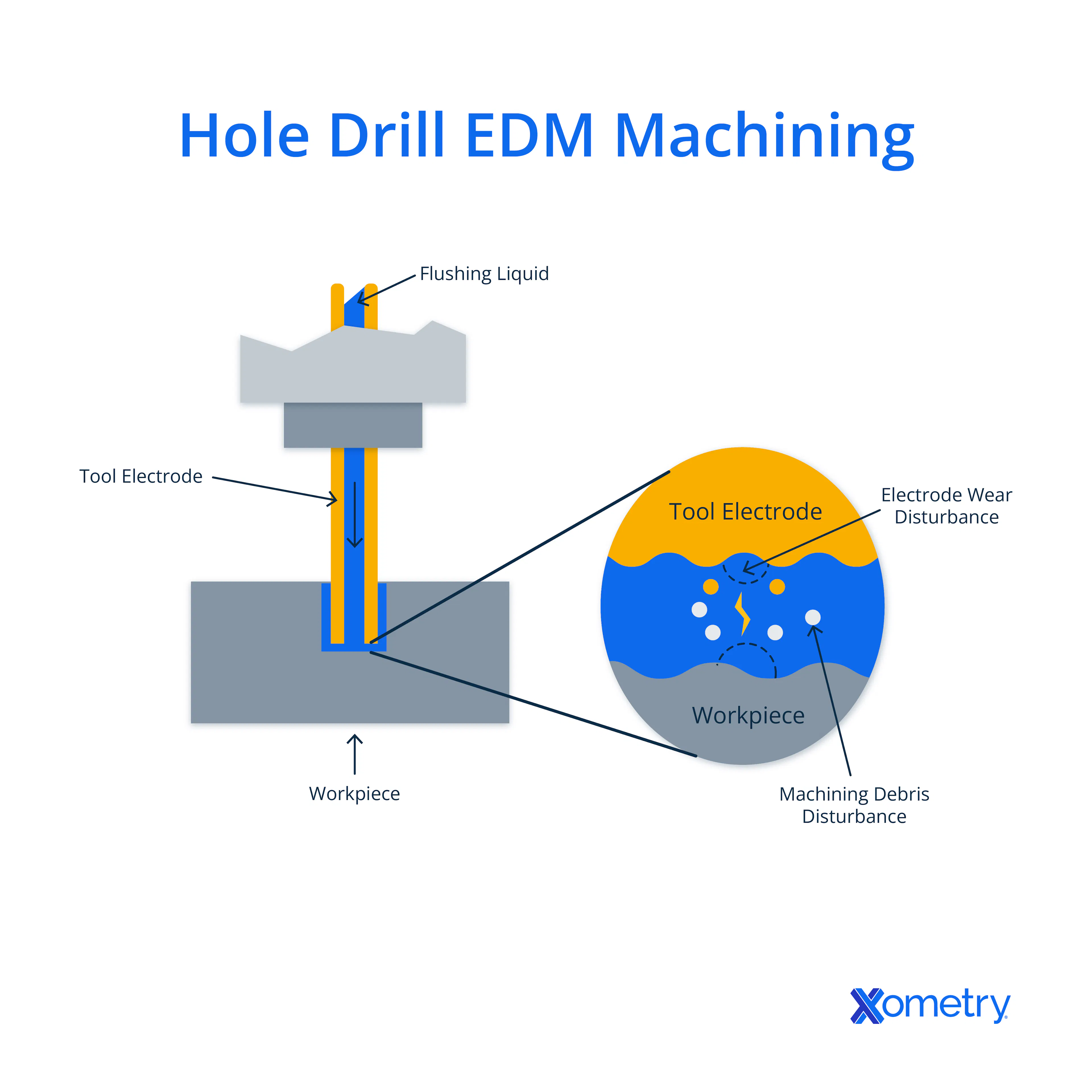

Hole drilling EDM was the earliest electrical discharge machining technique developed and remains a critically important tool in various fields, including the control of gas discharge in rocket engines/medical and scientific equipment and in opening cooling ways in gas turbine blades. Long straight small bore holes can only be cut by EDM drilling. A straight electrode is used to erode a hole that is a perfect reflection of the profile of the tool. It maintains precise dimensional accuracy along the entire length of the hole. This method allows for small diameter, high aspect ratio, straight holes of any depth, 0.0015” or larger in diameter. EDM drilling allows the drilling of both blind and through-holes, with smooth walls to be drilled in otherwise unworkable materials or to achieve difficult geometries. The as-machined surface finish of holes made by EDM is smooth enough to be used as bearing surfaces without additional processing steps.
Hole drill EDM machining process
