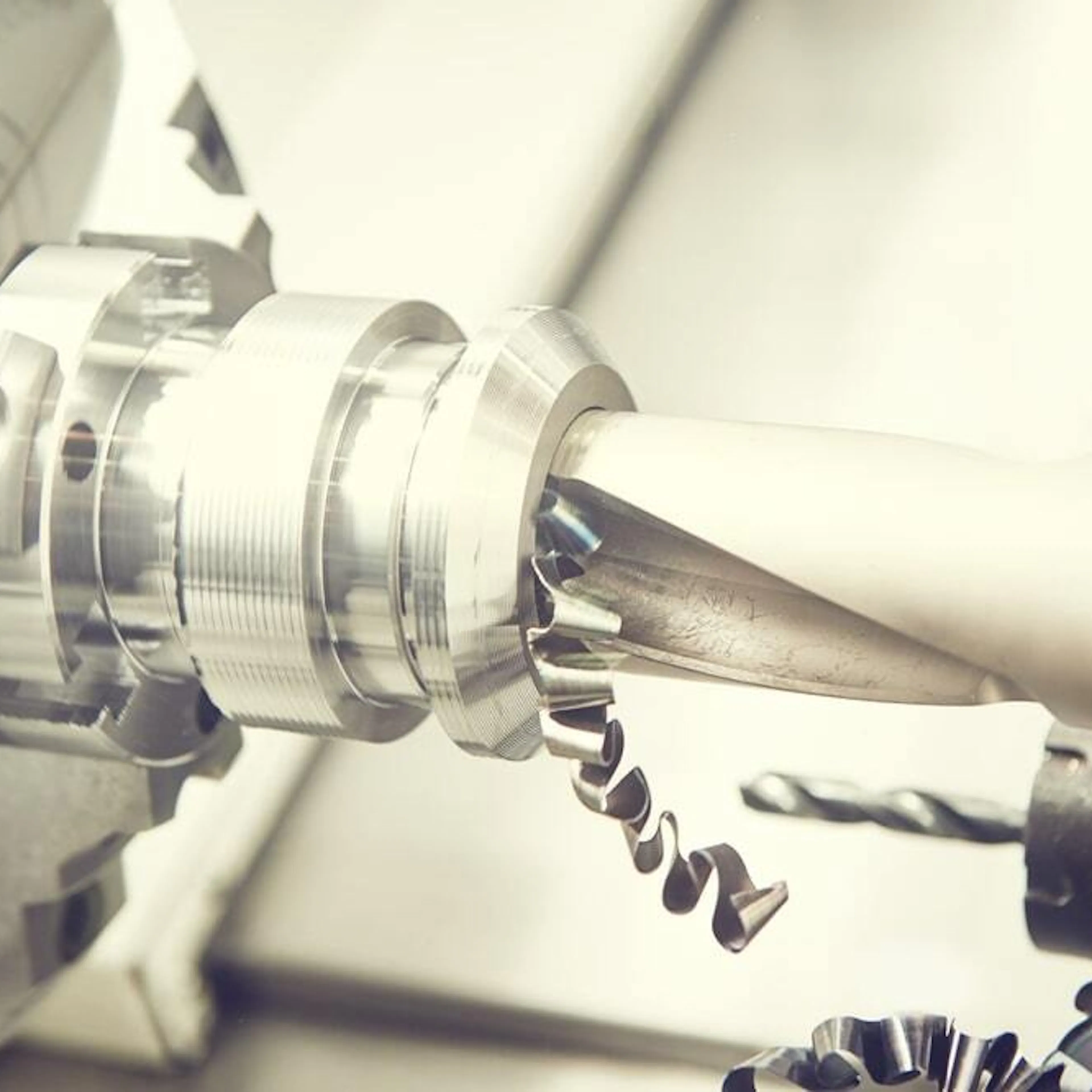

Cutting tool counterboring a hole. Image Credit: Shutterstock.com/Dmitry Kalinovsky
