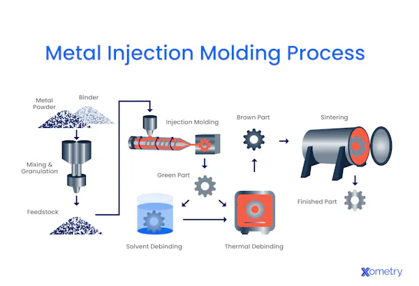

How Does Metal Injection Molding Work?
Metal injection molding works by mixing fine metal powders with a binder to create a feedstock. The feedstock is injected into a mold cavity under high pressure, which forces the material into intricate shapes. The binder in the feedstock allows for smooth flow and shape retention during injection. It undergoes a sintering process where heat is applied to remove the binder once the part is formed, leaving behind a dense, solid metal part.
The high pressure during injection ensures that the metal feedstock fills the mold completely, while the binder plays a crucial role in maintaining the flow and the part's shape until the sintering process is completed. The interaction of pressure and flow is key to producing precise, complex geometries.
The metal injection molding process is used in industries that require high precision and complex shapes. MIM is used to create certain turbocharger components, such as precision parts in variable turbine geometry systems. Medical tools (orthopedic devices) rely on the high accuracy of MIM for their production. Electronics (heat sinks) benefit from the ability to create intricate metal parts with minimal waste and high strength. The metal injection molding process is a necessary technology for other high-precision applications.
