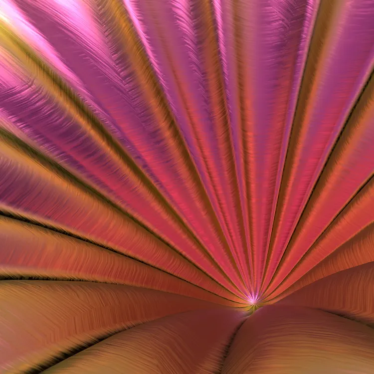

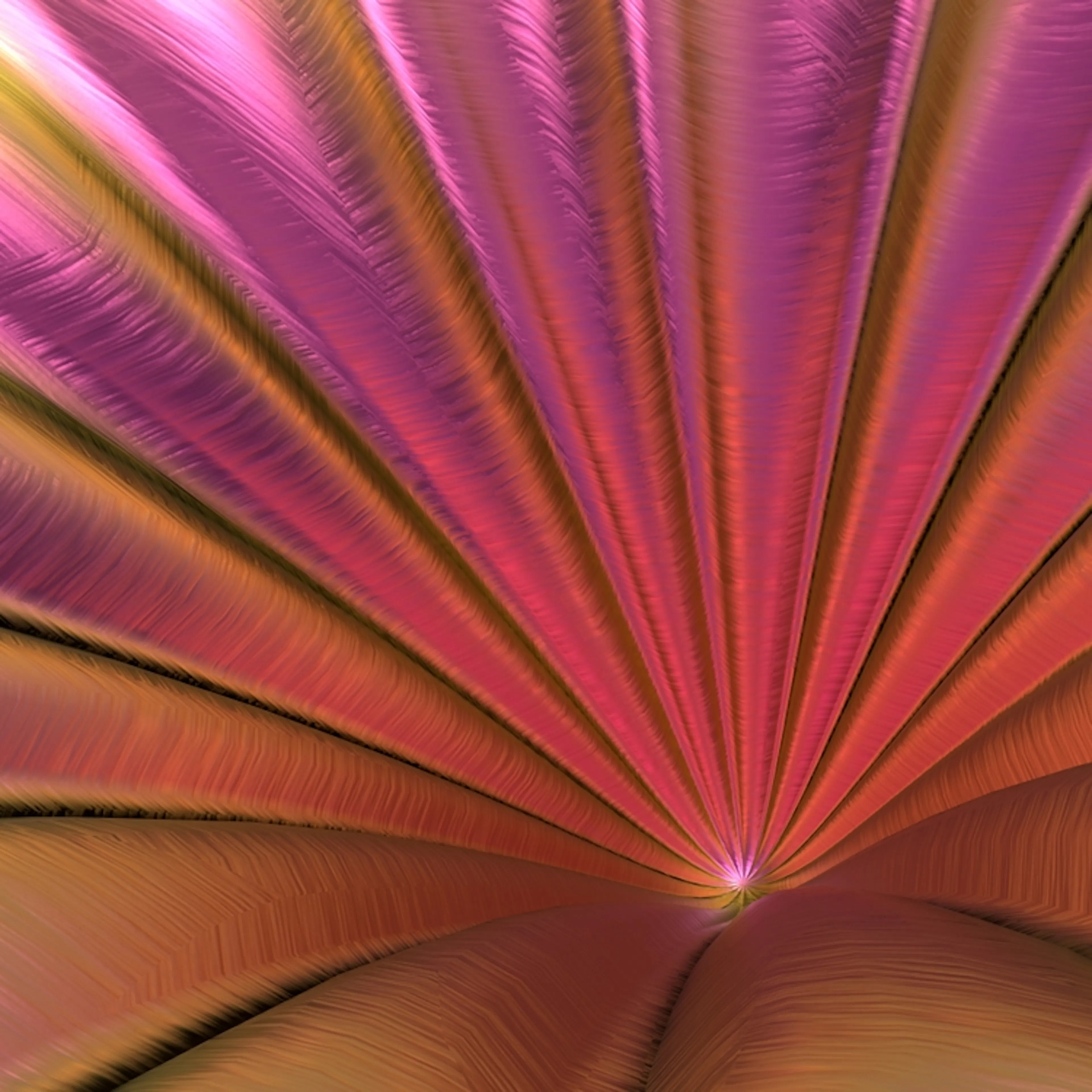

Anodized titanium. Image Credit: Shutterstock.com/Zita

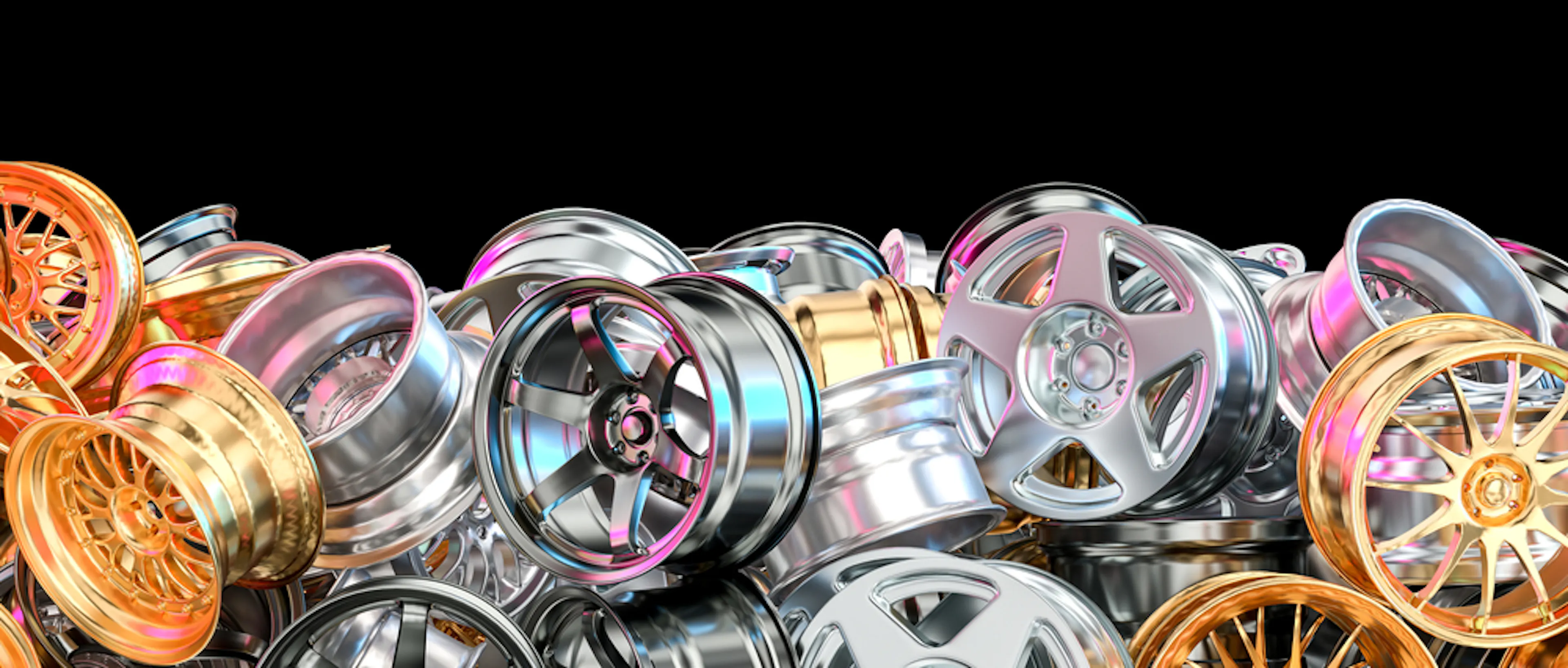

Anodization is a process through which the entire surface of a material (usually aluminum or titanium) is chemically reacted (oxidized) to form a protective and corrosion-resistant layer. This layer can also be colored for aesthetic effect. Figure 1 below shows some variations in coloration in anodized aluminum:
anodized aluminum car rims
Anodized aluminum wheel rims.
Image Credit: Shutterstock.com/gualtiero boffi
