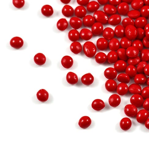

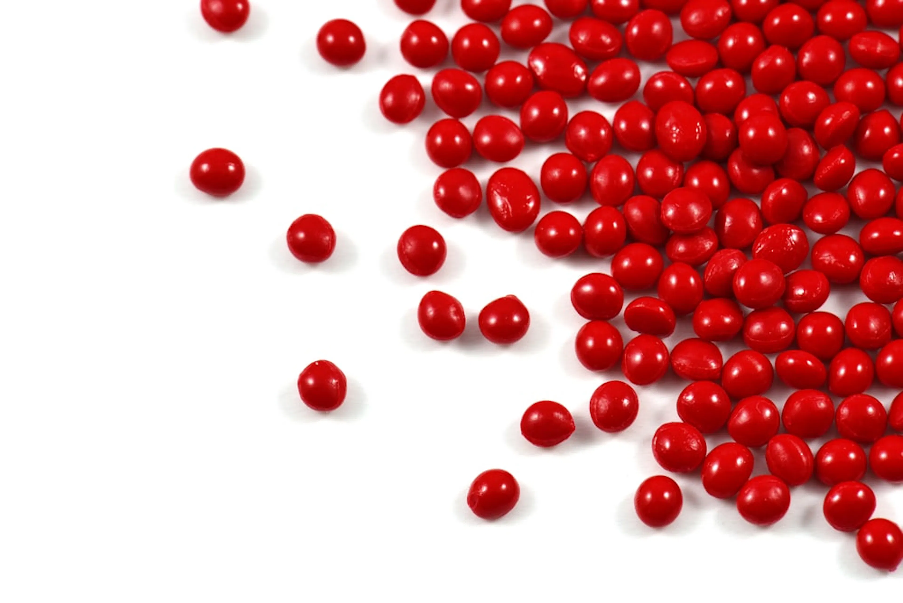

Acetal plastic granules. Image Credit: XXLPhoto/Shutterstock.com
Acetal is a synthetic plastic that is often used when injection molding or extruding. Acetal resins have well-balanced properties, including a hard self-lubricated surface and excellent chemical resistance, strength, stiffness, and toughness over a broad temperature range. Acetal’s chemical name is "PolyOxy-Methylene." As a semi-crystalline material, acetal has a low coefficient of friction and good wear properties. Acetal copolymer is one type of acetal.
