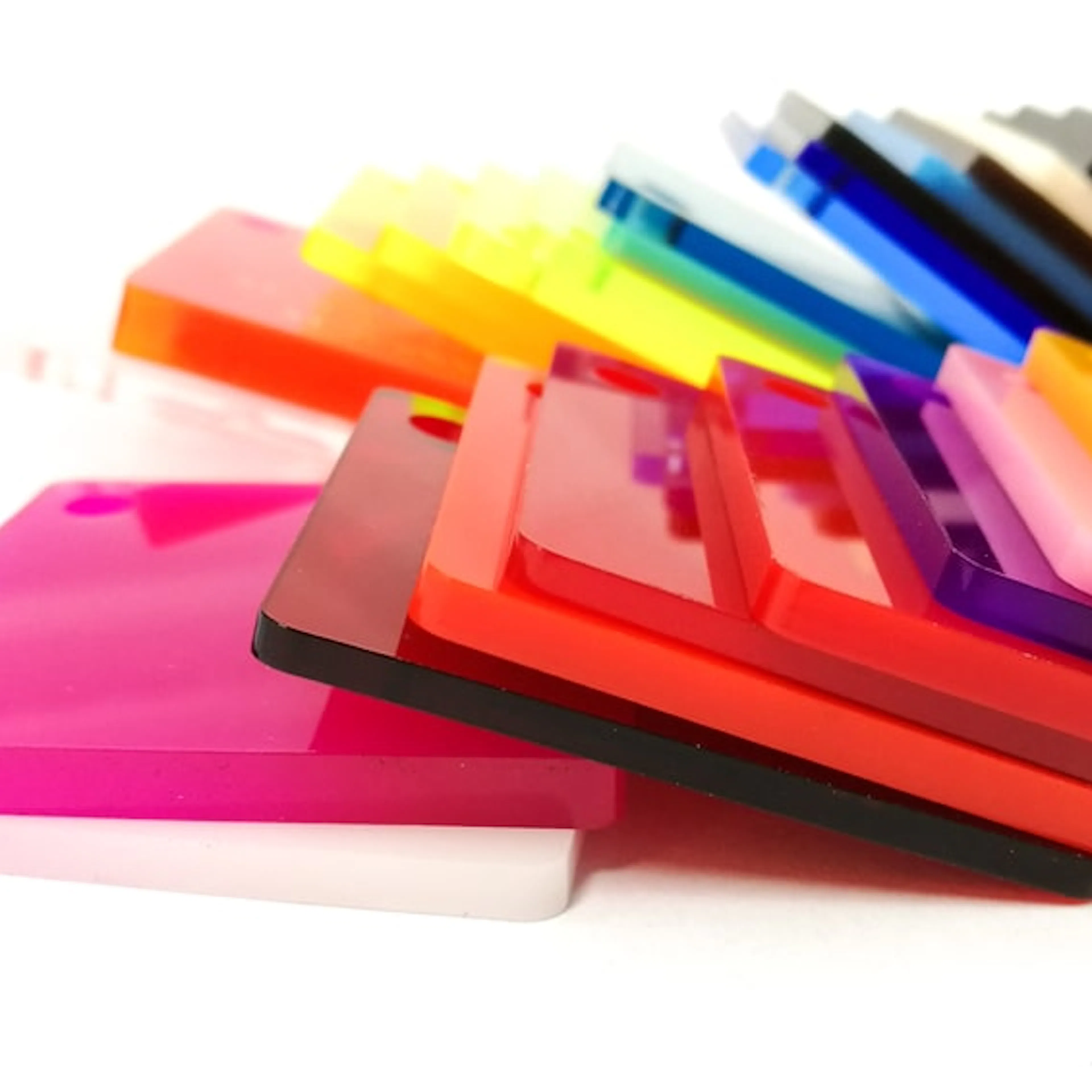

Multicolored acrylic sheet material. Image credit: baitong333/Shutterstock.com
As far as the list of versatile plastics goes, it wouldn’t be complete without mentioning acrylic. It gets worked into vastly different uses, from canopies for aircraft to supplies for manicures. Grouped into a category called engineering plastics, acrylic has proven its worth for several reasons. Here’s what you should know about its composition, properties, how it’s made, and what it can be made into.

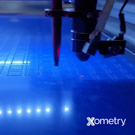

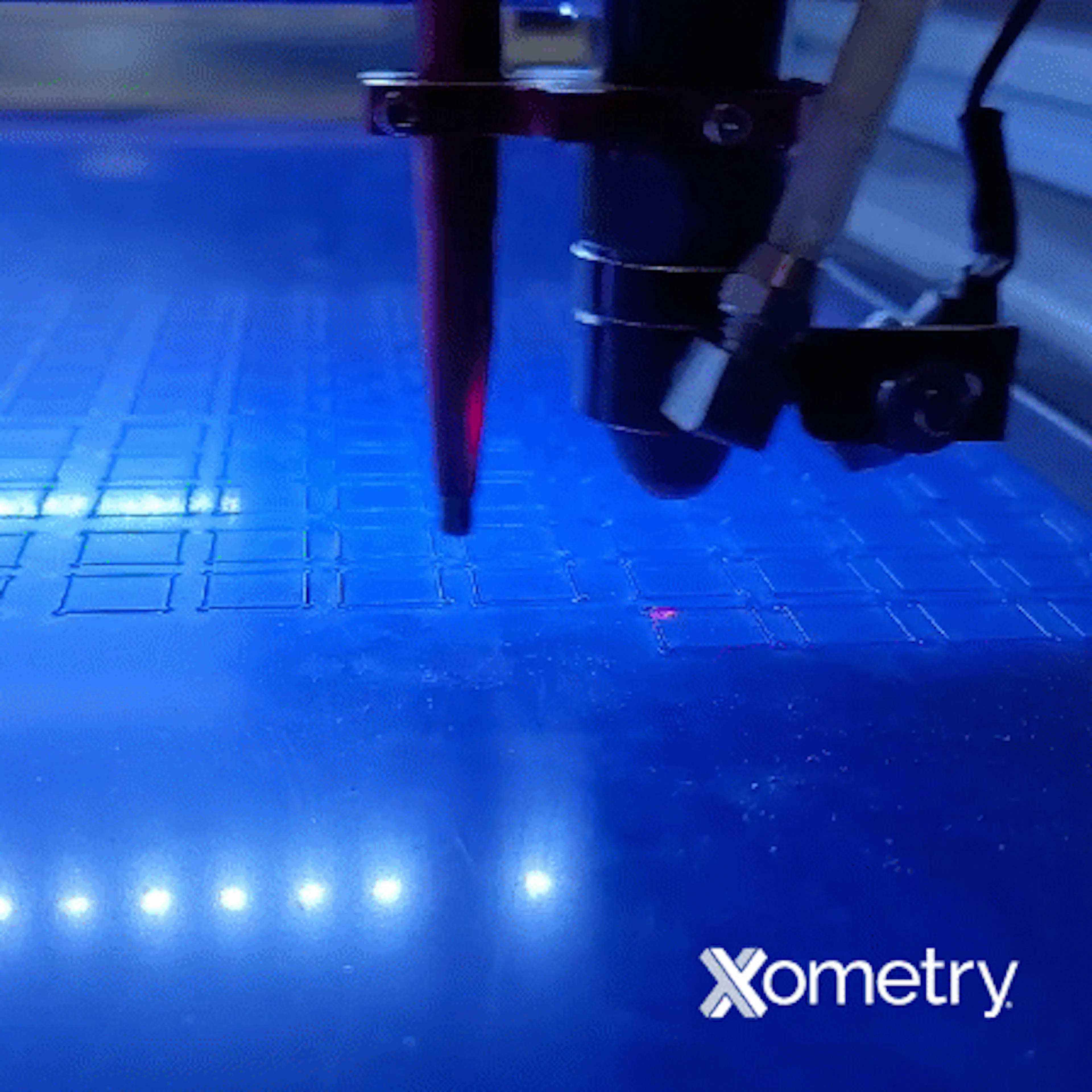

Laser cutting acrylic at Xometry
