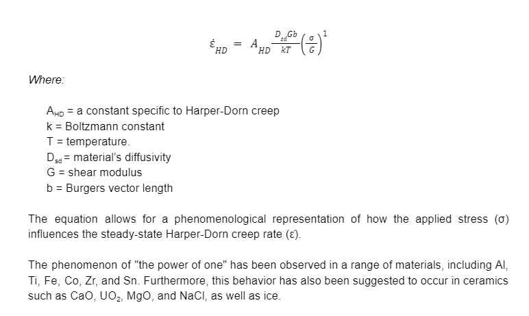

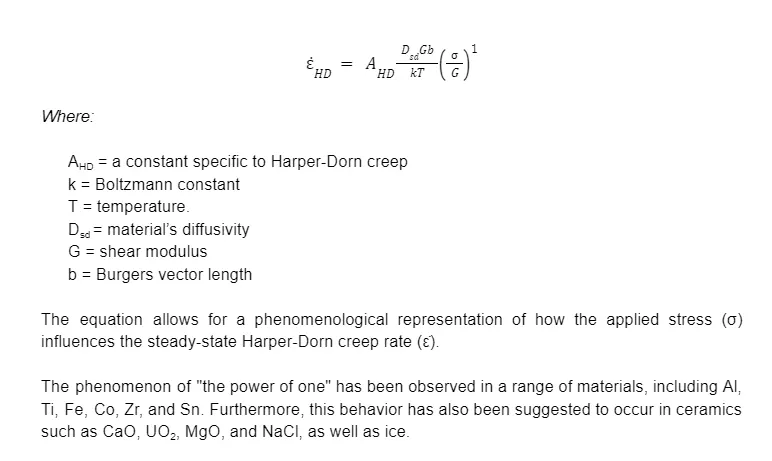

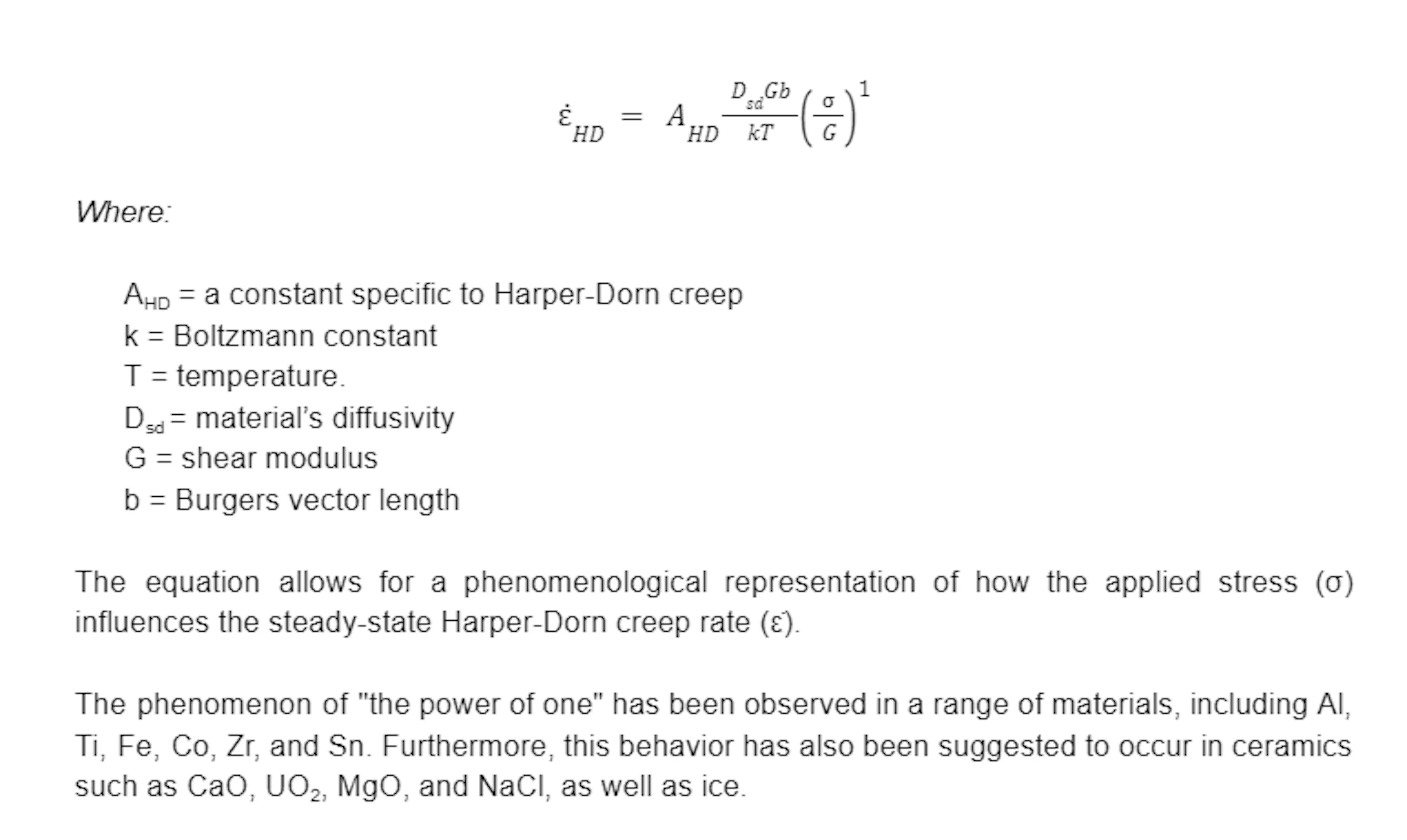

How Is the Harper–Dorn Creep Rate Derived?
The relationship between the applied stress and the steady-state creep rate in Harper-Dorn creep can be described by the following equation:
Harper-Dorn creep equation.
